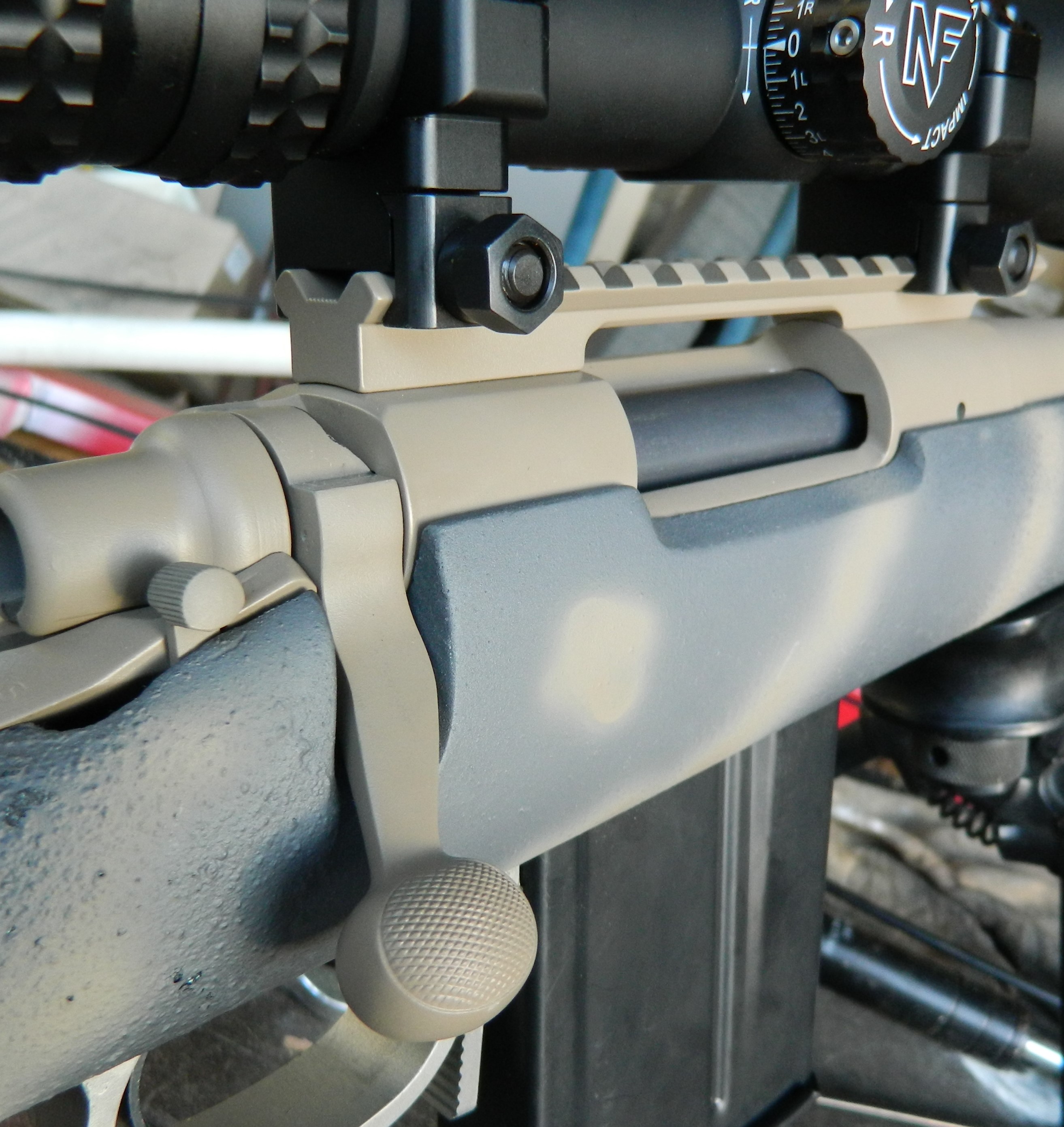

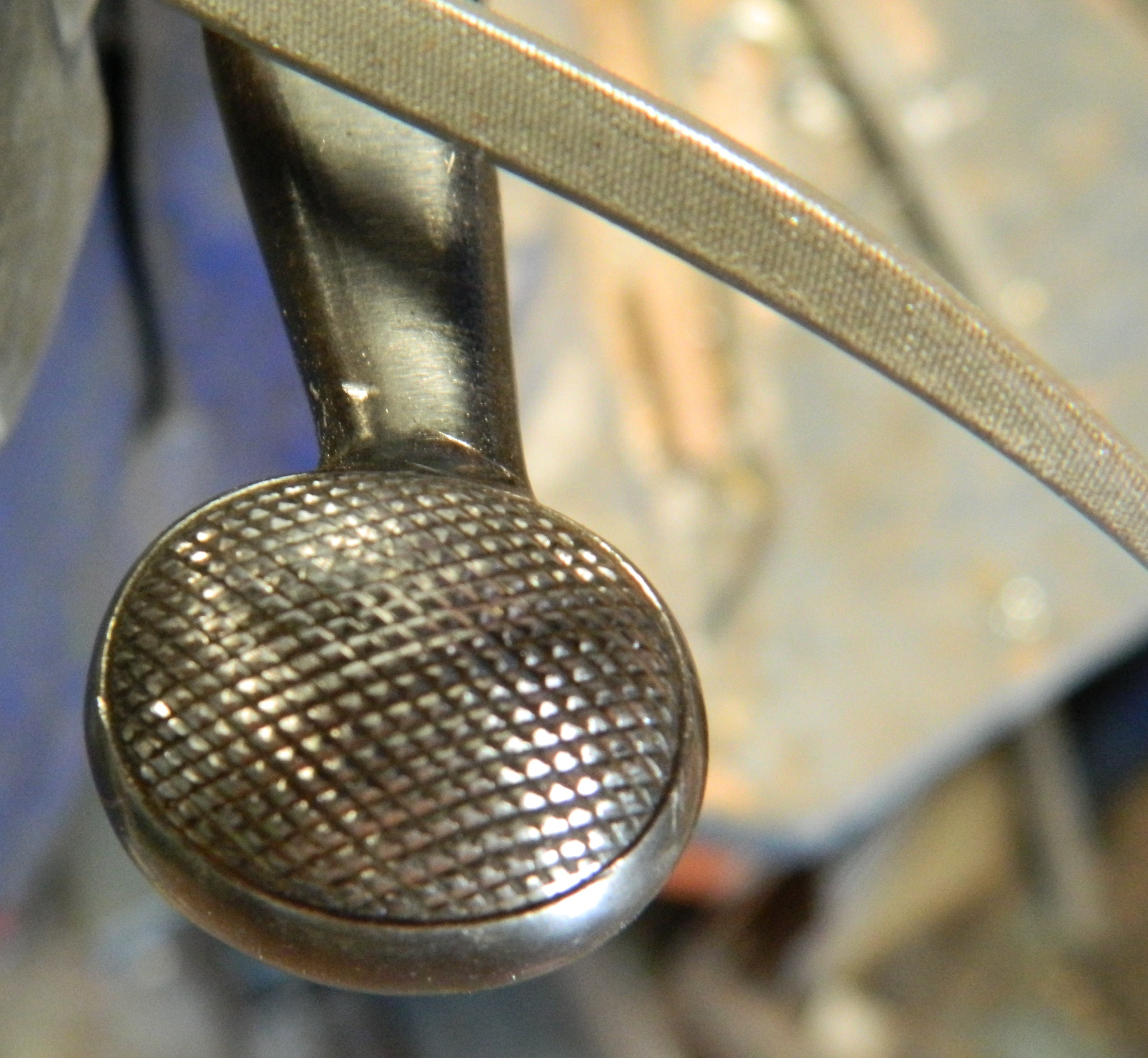

Post by Homer » 02 Nov 2018, 7:41 am
G'Day Fella's,
A while back, I thought about Cerakoting a Rem 700 rifle of mine.
Before this though, I planned to re-cut the checkering, on the factory, Investment Cast bolt knob.
Before
After
I hope that was of some interest.

Post by Stix » 02 Nov 2018, 7:51 am
You must have good eyesight to do that homer...
Looks good...!!

Post by Homer » 02 Nov 2018, 5:57 pm
G'Day Fella's,
Thanks for the kind words Stix, I wear 4x magnification glasses, when I do this kinda fine and detailed work.

Post by Homer » 03 Nov 2018, 7:57 am
Yes mate, I did all the work myself and it's chambered in .308 Win.
Here is a list of the work I performed on this rifle;
Trigger job of 1 1/2 pound.
Lapped the bolt locking lugs, to thier abutments.
Re-crowned the muzzle and then, threaded muzzle to M16 x 1mm.
Machined and installed a proto-type quick discharge muzzle brake.
Inletted and epoxy bedded the synthetic stock. for the http://www.lumleyarms.com , detachable magazine bottom metal.
Inletted and epoxy bedded the barreled action, into the synthetic stock (free floated barrel).
Fitted the third sling swivel stud, to the forward of action position.
Prepared and then Cerakoted (Sniper Grey) the stock, and then later, the barreled action, 0 degree scope base, etc (Coyote Tan, and Microslicked the bolt, inside and out, F/pin, cocking piece and F/pin spring).
Assembled every thing.
Fitted and lapped the TPS 30mm scope rings, and installed the Nightforce 2.5-10 x 42 scope.
Cleaned all the fouling from the barrel, and then Moly treated the bore, prior to shooting Moly coated bullets, in this barrel.
I think, that is about the exrent of it..................

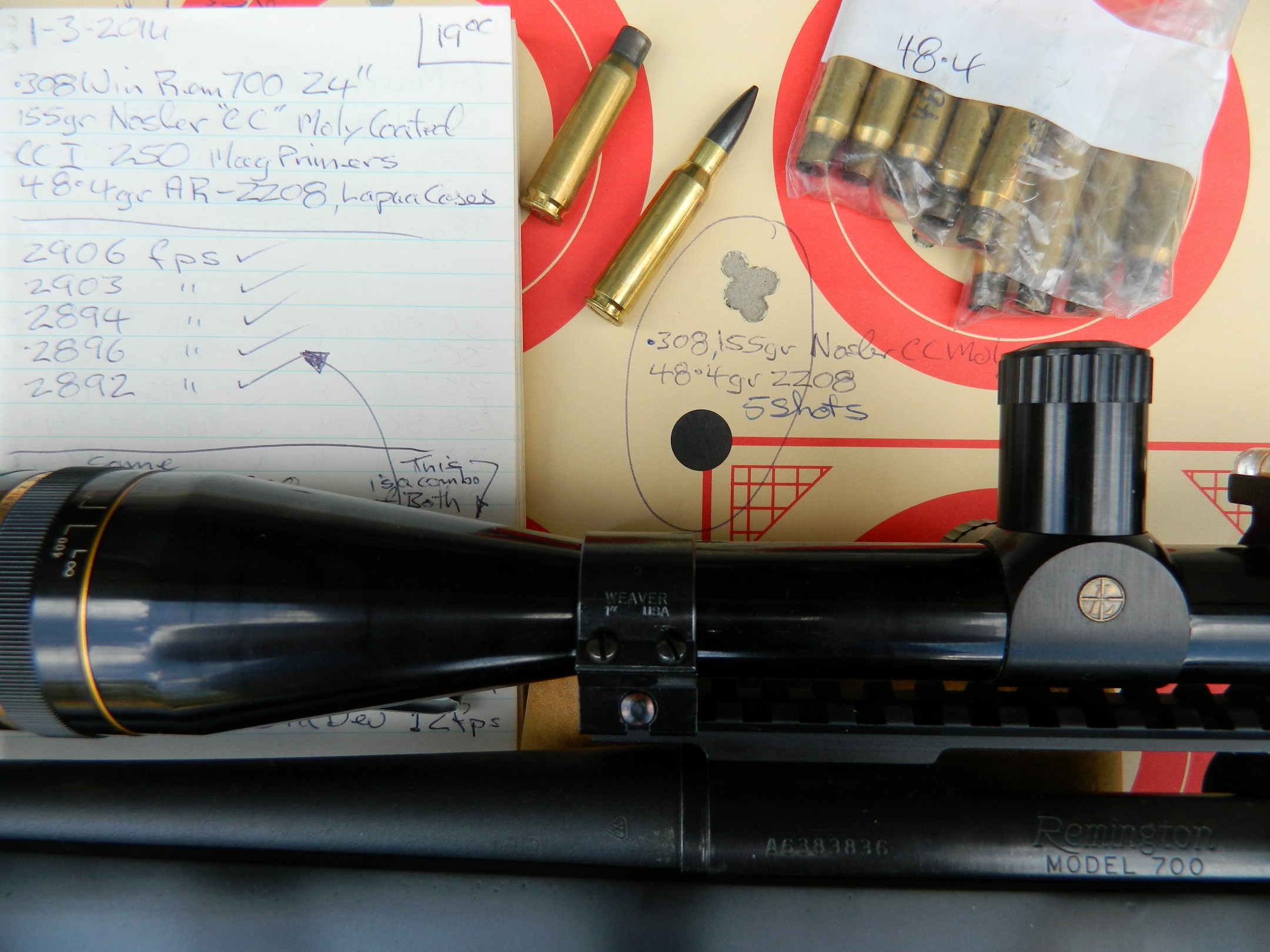

Here is a group I shot with this same rifle, prior to the metal work, being Cerakoted (and with a 6.5-20 x 40mm scope on it).

Post by Homer » 03 Nov 2018, 11:58 am
G'Day Fella's,
Thanks for your kind comments.
Yes, and some people will tell you that Remington barrels won't shoot!
This was a new "Pull Out", Rem 700 SPS, .308Win barrel, that Keith Hills fitted to this action for me.
FYI, the bullets have to jump 0.170", to engage the rifling, and they still shoot these size 5 shot groups, at 100 meters.....so there goes one theory!
Also, this/the ammo I shoot in this rifle, is loaded on an RCBS 4x4 progressive press, so.................there goes another theory!

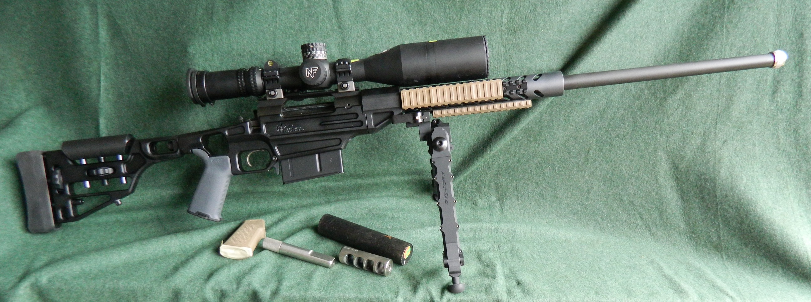

Post by Homer » 17 Jan 2019, 9:23 am
Straight Shooter, it's a MDT extended scope base.
I believe I may have been the first person (at least, in the 21st Century), to locate the bipod toward the rear of the forearm (just forward of the balance point).
It allows you to pan between targets, with a minimum of movement, as the pivot point is toward the center of the rifle.
Here is another example of it.
