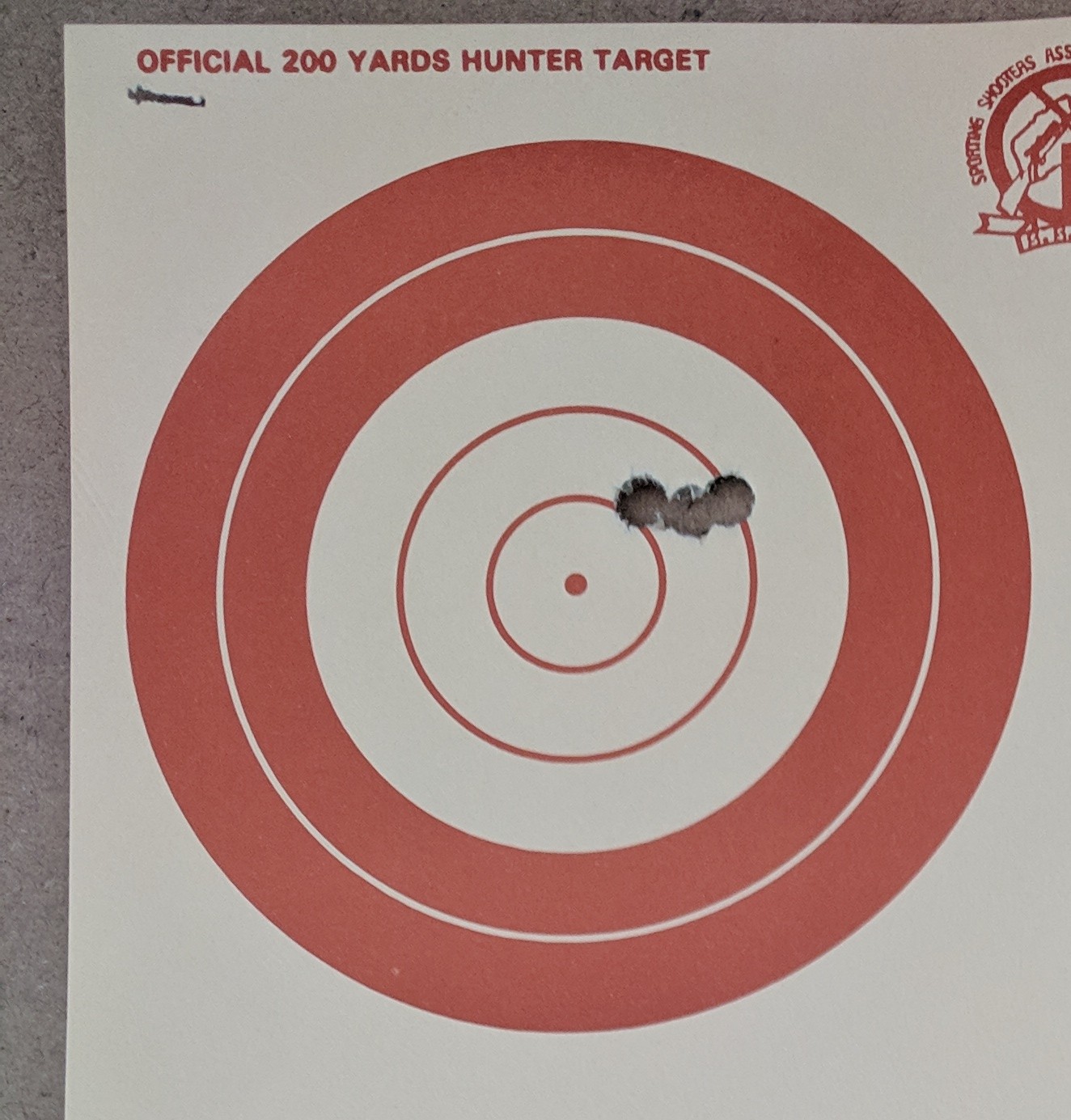

Post by Cal-ApeR » 19 Dec 2018, 4:30 pm
SUCCESS! At least I like to think so. Still a little work to be done but definitely heading in the right direction.
These are the best of my 2 development loads after today's range visit.
The image with the string like cluster is Speer 165gr BT- 43.5gr 2208 OAL 2.90" (20thou off lands).
Second image was Speer 130gr HP - 47.0 gr 2208 OAL 2.69" (20 thou off lands).
I've come to realise a few things below which I feel all have played a part in my accuracy issues.
1. The Seat Depth. This has probably been the biggest factor I've noticed affecting my accuracy. So far it seems 20thou off the lands is its happy place. I've never encountered this before. All of my other rifle are happy with SAAMI lengths. It's been a good thing to learn though and one of those things you only learn from others more experienced. Thanks to this forum in this regard.
2. Scope magnification. My eyes definitely struggle to see a small dot at 100yds on a 3-9 scope. I still feel this my favourite choice in magnification just getting harder to sight in and determine the best group. Anyone have any cheat methods around this?
3. There can be a multitude of things that with together to affect accuracy. For me I feel initially the standard Stevens trigger was far too heavy. Replacing that took another variable out of the equation. I also had issues with the scope moving in the rings early on. This clearly wasn't good. A drop of silicone solved that problem.
Many thanks for everyone's input. Very happy after today's effort.

Re: 308 loading advice
Post by Oldbloke » 19 Dec 2018, 5:18 pm
:thumbsup: For hunting that smaller group is plenty good enough. You should be happy with that..

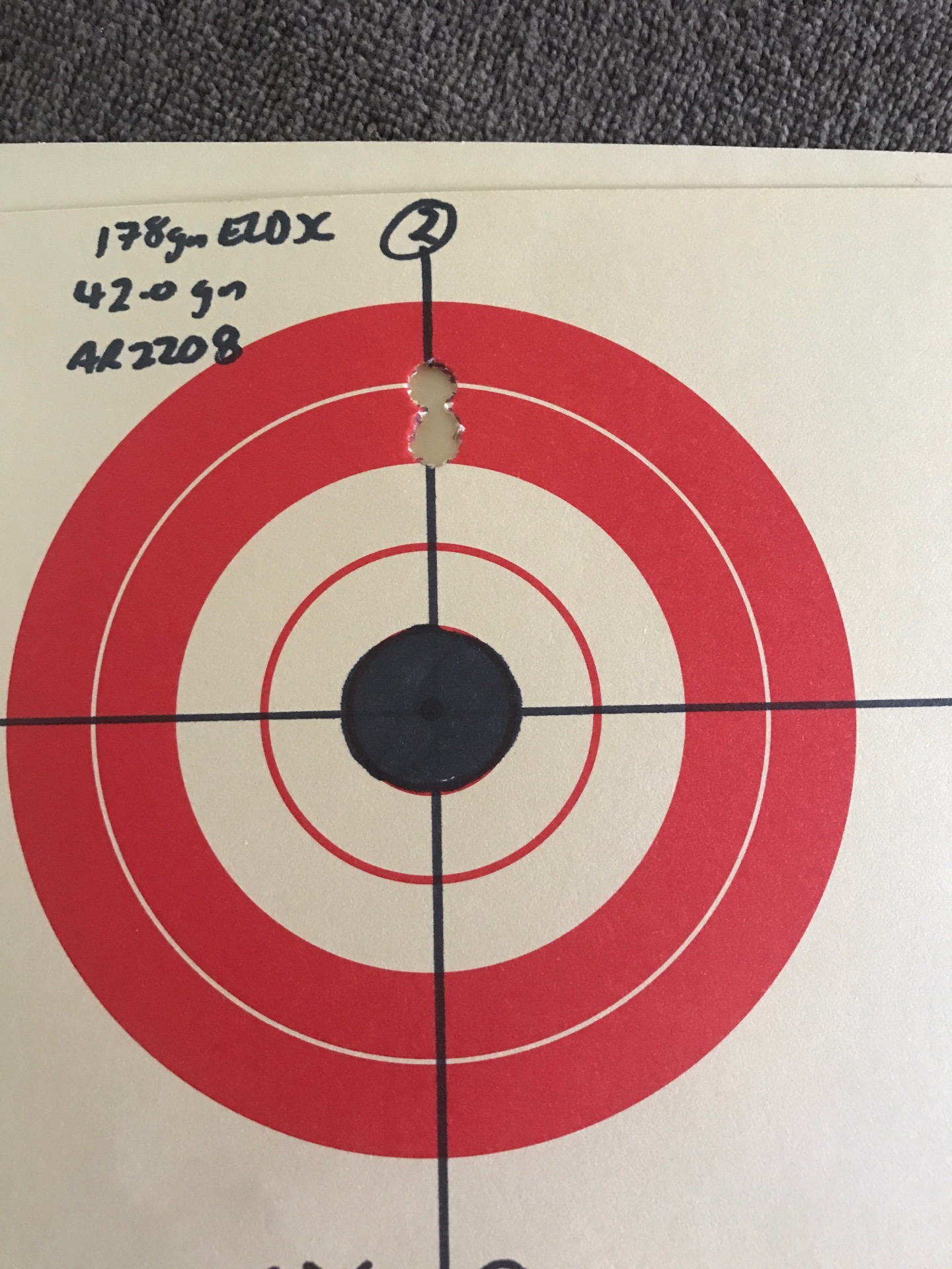

Post by JimTom » 20 Dec 2018, 1:42 am
Mate I got average results with the 165 SST so I tried the 178 ELDX as they were on special, somewhere around $40/100 from memory. They shoot like a champion with AR2208.

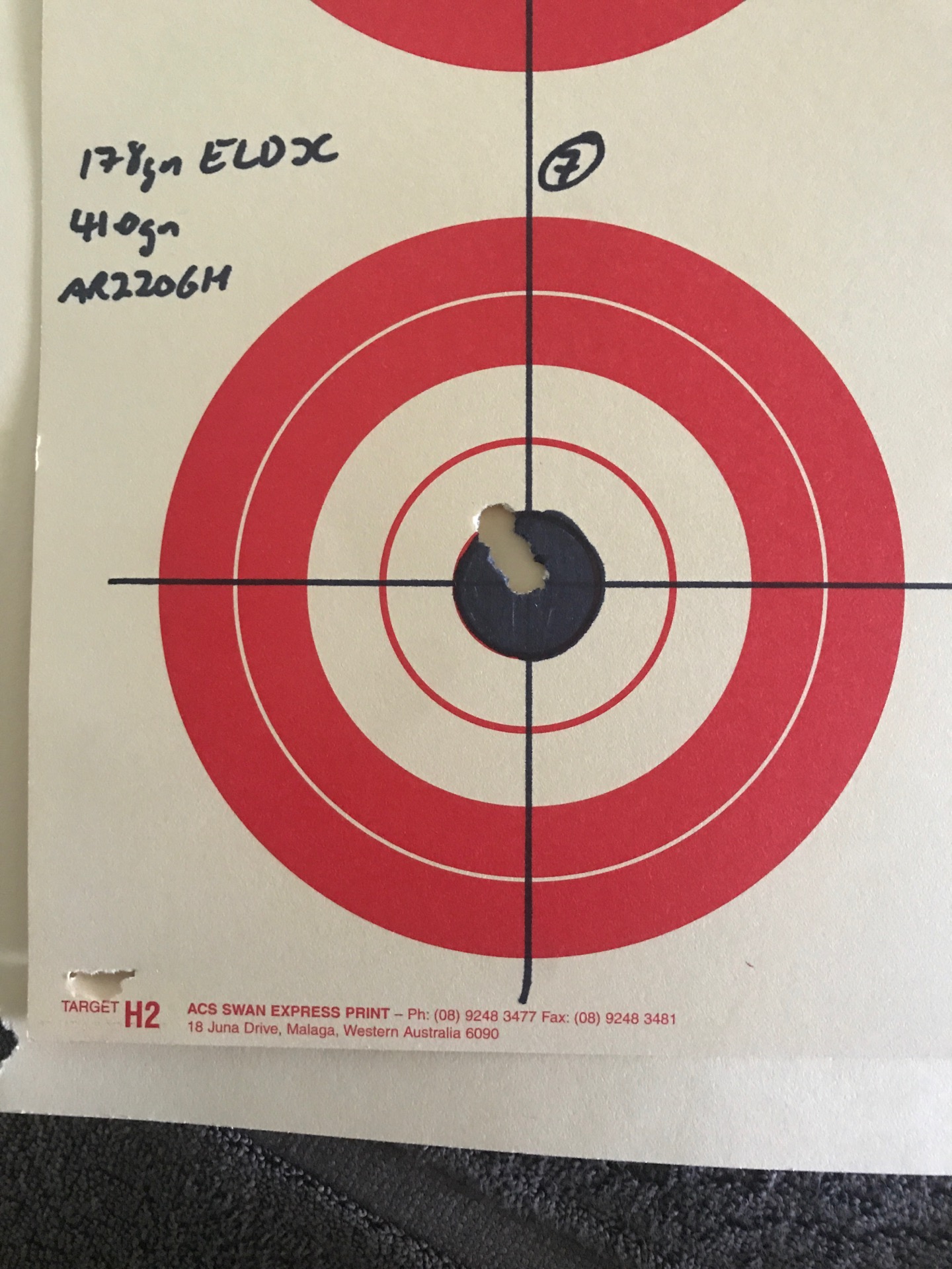

Post by JimTom » 20 Dec 2018, 9:15 am
They went well with AR2206H too. Only three shot groups as I was trialling many different loads. Nevertheless not to bad at 100m and is only a hunting load.

Post by Oldbloke » 20 Dec 2018, 10:18 am
Very nice jomtom

Post by SCJ429 » 20 Dec 2018, 5:00 pm
Well done, good old Speer bullets get the job done. Exceptional job if you are using a 9x scope. The only cure is more magnification but you are doing a great job with what you have,
