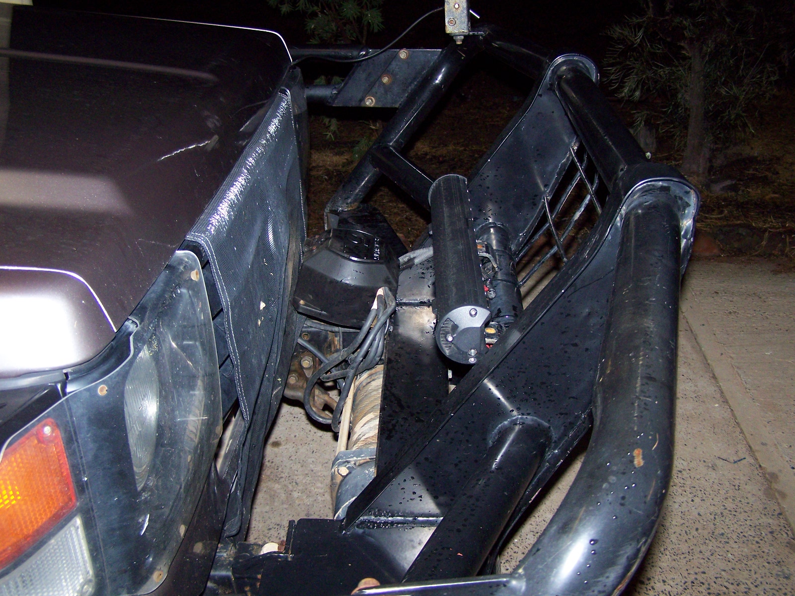

Post by Die Judicii » 08 May 2018, 7:29 pm
Rod_outbak wrote:
Problem I have with the wagon, is the bullbar is too shallow, so the 240 blitz lights used to hang out in front(previous owner set them up).
Not going to be good when a roo impacts them.
Hi Rod,
Praps you need a bar that has a little depth to it (see attached pic)
Posts: 4408
