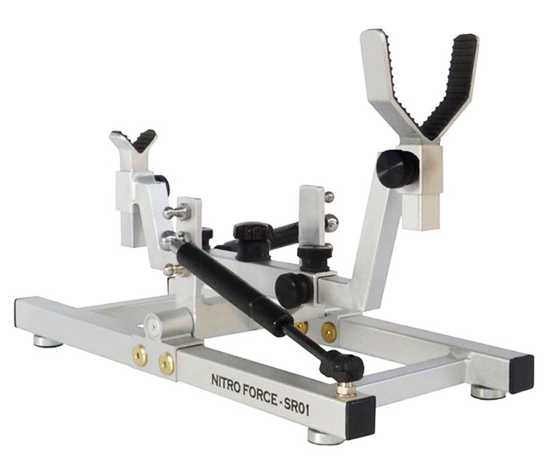

I have been considering one of those shooting rests like the Eagle Eye, below. That may help with isolating my shakes and twiches but pointless if it's my triggering causing the aberrant results.
Going to try some dry fires and see. :thumbsup:

prairie dogs life at stake I will use a bipod
the reason I have put this up is to show what a master barrel/rifle/accuracy builder thought on using rest's
the rest you have posted the photo of will not work for the reason that the rifle cannot recoil freely the same every time
it will drag against where it sits and pull off sight, I'm afraid the same can be said for Stix's straight shooter bag unless the rifle can slip freely when recoiling
when the rifle drags it will pull to a side and jump in the rest, you will not get the best precision, shooting off a bonnet can be pretty wobbly as well
as said in the quote powdering the bag with talcum powder will help the rifle slide the same every shot if you want ultimate accuracy
I use bags with a soft slippery top for testing/sighting ect but a bipod for shooting
the horizontal stringing could be an unstable rest ect :drinks:
