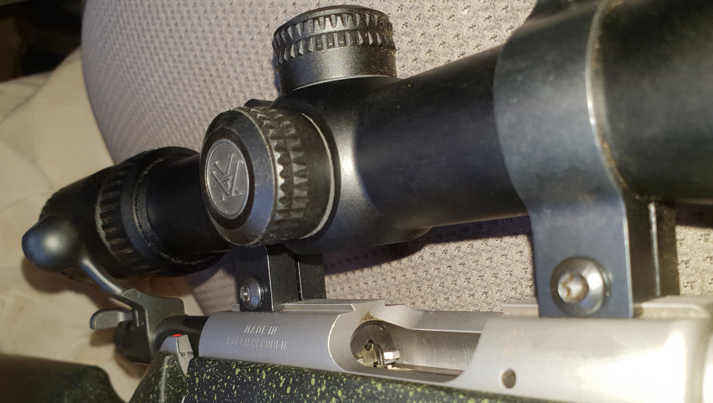

DeadPool,
Initially, I have gone the Talley CZ 30mm rings(Suit 11mm Dovetail), and as mine were to fit a 50mm objective, I went with the High rings.
Best guess is the bolt knob has about 3/4 cm clearance on the side of the scope.
I havent found the clearance between scope and bolt has been an issue; havent noticed it ever being a problem.
In the next week or so, I'll fit the 15MOA rail(Area 419), and then fit this scope with some 30mm Picatinny rings. Not sure if I'll get away with medium rings; I'll have to look at how far the rail extends, and whether medium rings will give enough clearance.
Attached gives you an idea of my setup with the Talley clamp rings.
