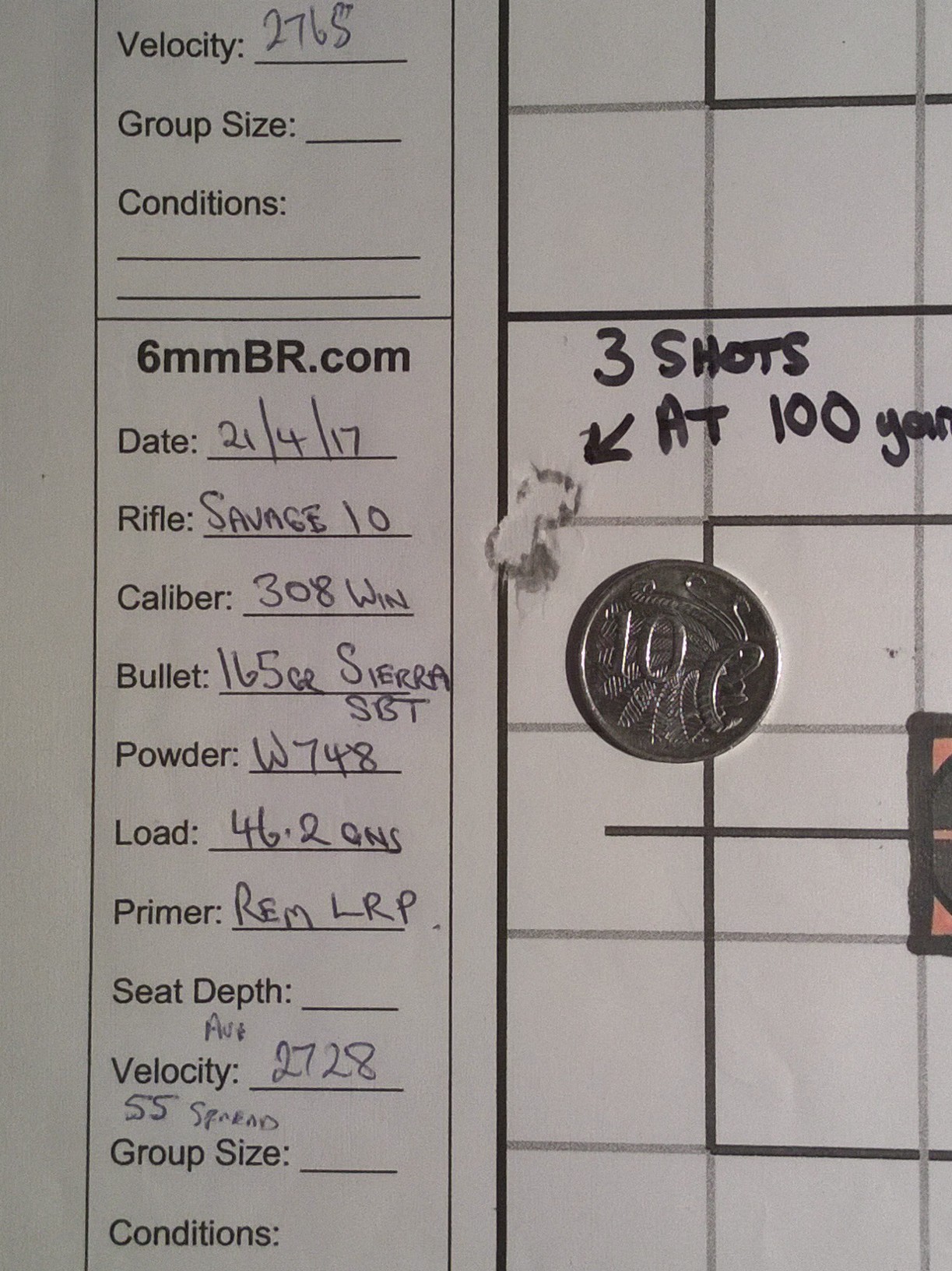

Hi guys,
Just thought I would show you (brag) one of my results after going through the old trial and error method with my Win 748 powder. :D

rustypic wrote:Hi guys,
What happened? Did you call the flyer or just twitch on the trigger?
