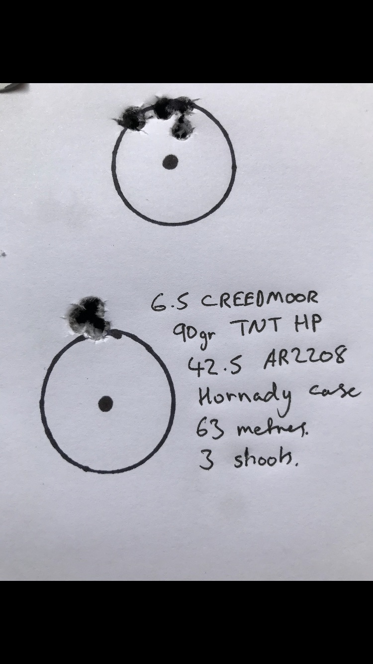

Post by Cooper » 13 Jan 2019, 2:02 pm
Cal-ApeR wrote:Cooper, how did the Speer perform? Curious to know what sort of groups you were capable of using the lighter projectiles.
I keep flipping back and forth between the idea of getting a spare 243 or a creedmoor. Your input here will help.
That at 63 metres. 3 shots. I have a 26 inch barrel. They are extremely explosive out of the Creedmoor. They go fairly good out of the Grendel too! Even though they are a good few hundred feet per second slower out of the 6.5 Grendel.

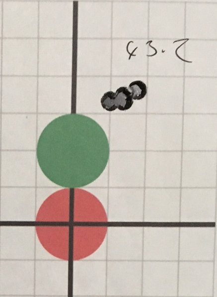

Post by Flyer » 13 Jan 2019, 4:26 pm
Cal-ApeR wrote:
Flyer wrote:I think it's worth mentioning the small primer Lapua cases are thick with lots of metal around the primer pockets and some long-range competition shooters are pushing the Creedmoor up to and over 64,000psi. I don't want a barrel burner, but I wouldn't mind a hunting load with a bit of "oomph". I bought the 6.5CM to replace a 243 because I figured the 6.5 could do everything the 243 could do with similar recoil, longer barrel life and also encroach into 308 territory in terms of downrange energy. I wanted a mid-ranged centrefire that could "do everything". I don't think there's anything a 6.5 couldn't account for in the Aussie bush.
Your thoughts are very similar to mine. I still have a little life in my 243 but thought maybe the creedmoor for this price would tick the boxes and deal with my varmints as well as medium sized game. Brass is not as cheap, projectiles in .264 are slightly more per hundred but barely enough to worry about.
Have you achieved this goal? Any chance you've used the Speer 90gr TNT in your Creed?
I haven't used anything lighter than 123gr at this stage.
Brass and projectiles are slightly more than 243, but you tend to have a larger choice of 6.5 projectiles, as well as a choice or large and small primer brass. It also appears 6.5CM brass is coming down in price as the calibre becomes more common. The Starline Brass isn't bad value and comes with a guaranteed five reloads out of every case. But I've seen a video of two guys reloading a Lapua 6.5 Creedmore SRP case 21 times in a row to no ill effect, so that's pretty good value to me, too.
I've seen Federal 6.5CM Powershock 140gr ammo for sale for $25-$30 a box, and I've bought a couple of $30 boxes myself that shot really well and provided some cheap brass. Again, 6.5CM ammo is becoming more common and getting cheaper in price if you want a source of cheap brass or don't fancy reloading.
When it came time to choosing a 6.5, one of the things that swayed me towards the Creedmoor was the greater - and increasing - choice of all the above compared to 260 or even 6.5x55.
I don't notice any real difference in recoil between the 6.5 and 243, but I've shot both at metal gongs and metallic silhouettes and the 6.5 has a much more noticeable ring to it - it definitely hits harder (123gr bullets vs my old .243 87gr V-Max load).
I already have a 223 and rimfires which I shoot a lot, and I wanted one other centrefire to do everything else. I could have added a 7-08 or 308 to my 243, but I decided to rationalise both with a 6.5. I freely admit to jumping on the "manbun bandwagon" due to the CM's popularity, because that just means a greater choice of brass, projectiles and factory ammo that seems to be increasing every year.
4 shots at 100m

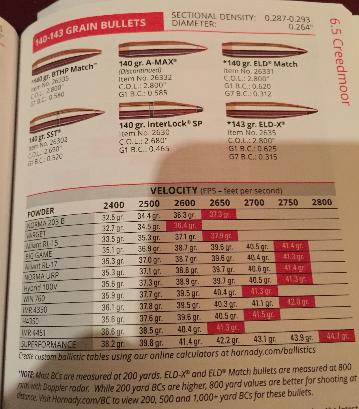

Re: Howa 6.5creed
Post by Flyer » 13 Jan 2019, 10:28 pm
As I mentioned earlier, we've chronoed the following:
24" Sako barrel, 143gr ELD-X, 2209, Lappy SRP brass, BR4 primers
41.5gr = 2650fps
42.0gr = 2680fps
42.5gr = 2710fps
If you extrapolate, that's pretty close to the Youtube guy, but I've got 2" extra barrel and am getting slightly below book values. I can only surmise the rifle is quite new (about 100 rounds through it) and may speed up a little once run in properly. I know it isn't a "Happy chrono", because it's been pretty close to ADI data with lots of other rifles and many loads.
We've also chronoed a 6.5x55 using the same chrono and here are the results:
6.5x55
Sierra Match King 123gr, 2209
44.3gr = 2770fps
Hornady SST 140gr, 2209
43.5gr = 2664fps
6.5CM
Lapua Scenar 123gr, 2209
43.2gr = 2815
44.2gr = 2880
45.2gr = 2960
Hornady ELD-X 143, 2209
41.5gr = 2650fps
42.0gr = 2680fps
42.5gr = 2710fps
The Swede loads were a bit soft, as they were target loads, and that was in a Sako 85 modern action with a 22.5" barrel.

Re: Howa 6.5creed
Post by JimTom » 13 Jan 2019, 10:32 pm
SCJ429 wrote:Not looking to go to the point of failure but a safe pressure before the bolt gets tight. Do you know anyone with a chrono?
Mate unfortunately I don’t know anyone. Would be an interesting experiment though.
Re: Howa 6.5creed
Post by JimTom » 13 Jan 2019, 10:34 pm
marksman wrote:
JimTom wrote:I have a creed, I use Lap brass and load with 2209. Don’t have a chrono though.
Not sure that I’d be keen just to prove a point for the Manbun haters though.
dont worry about the manbun haters, but owning a swede and a 6.5x284 I'd like to see what she can do myself :drinks:
I agree mate, be interesting to see where the CM fits in compared to the others two you mentioned. I have watched a few YouTube clips of long range hunting with the 6.5x284. Pretty impressive stuff eh.
Re: Howa 6.5creed
Post by bladeracer » 13 Jan 2019, 11:51 pm
Flyer wrote:Can you run similar pressures though? It's not just the barrelled action but the brass that also determines pressure.
This guy loaded 2gr over book and got close to 2800fps in a 22" sporter barrel using 2209 and 143 ELD-X with no pressure signs in Starline small primer brass. Other powders are faster, like RL17 and Superperformance, so there's a lot of velocity to be had out of the Creedmoor if you push it with the right brass: https://www.youtube.com/watch?v=r0gQCmnYmHU
Quite a few guys are getting 2850-2950fps from 140-143gr bullets out of 26" barrels, too, if you look around.
I'm not saying the Swede isn't faster in a modern action, but I am saying modern brass can push the Creedmoor very close to modern Swede territory.
Pressure comes down to lots of things. Full-length sized brass will have higher pressure than neck-sized brass due to the smaller case volume, as will seating the bullets longer. Different powders produce different pressures depending on case-fill and bullet weight.
Why would somebody want to run their rifle anywhere close to its pressure limits? Every shot has a higher cost in the life of the bore, the brass and the action. To achieve what though, another 100fps? You can almost always achieve whatever goal you've set yourself by means other than working a rifle to destruction, like trying with a different cartridge, or a longer barrel with a slower powder.
