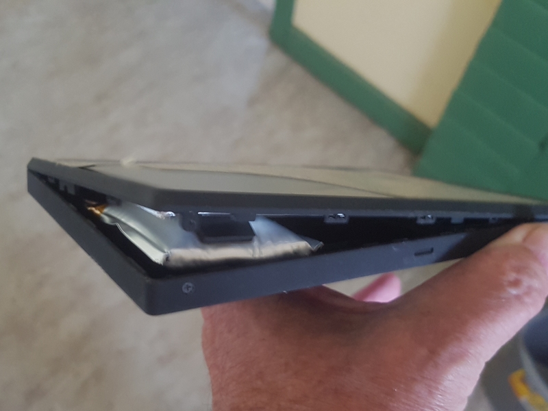

Post by Gaznazdiak » 15 Jan 2019, 8:38 am
Anyone on here got a Hema Hn7 GPS?
I went to use mine today and found that the bugger had exploded in the box.
That's a little dramatic, the battery has swollen up like a dead cow and burst the case open.
Anyone had something like this had this happen.
I have heard of older model smartphones being wrecked when their old battery had swollen and broken cicuitry.
Webp.net-resizeimage (6).jpg (214.11 KiB) Viewed 4467 times

Yeah this unit spent a lot of its life unused and discharged, probably didn't help.
They're a great unit with topographical maps for off road as well as on road use, but two big drawbacks are the poor battery performance and a maximum speaker volume so low that you have to bluetooth it to your stereo to hear directions.
It's out of warranty and Hema want a non refundable $100 up front just to see if it's fixable.
I can get another battery on ebay for $17, so I'm going to put the new battery in first.

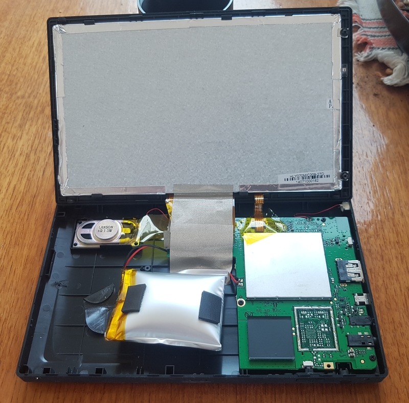

Post by Gaznazdiak » 21 Jan 2019, 12:30 pm
I've often wondered what's inside an $800 GPS.
Now I know.
The sheet of 1.5mm gal backing the screen would suggest the manufacturer was perhaps aware of this style of battery's tendency to bloat.
fideles usque ad mortem
