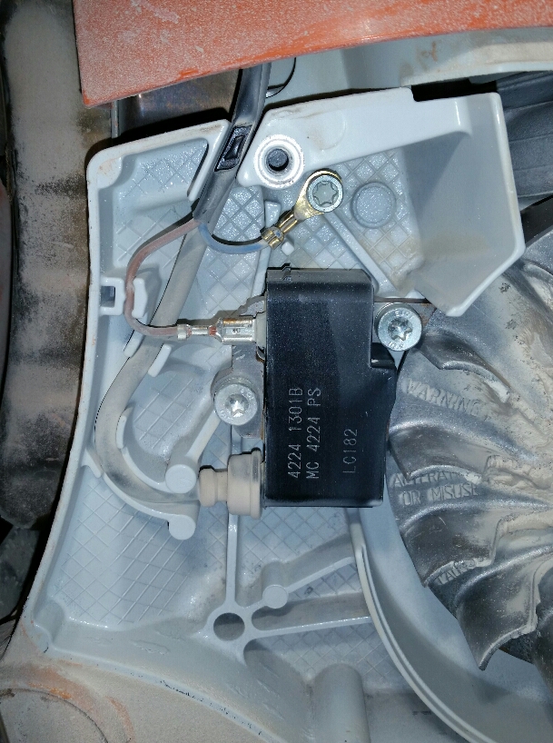

Anyway...pics...
Coil/ignition module
2019-08-09 22.25.53.jpg (422.03 KiB) Viewed 5954 times

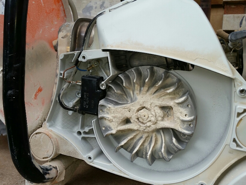

Coil & flywheel 1
2019-08-09 22.26.06.jpg (396.23 KiB) Viewed 5954 times
Coil & flywheel 2
2019-08-09 22.26.16.jpg (390.92 KiB) Viewed 5954 times

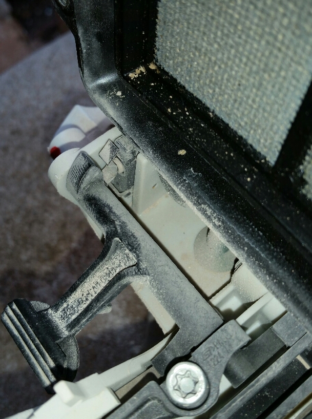

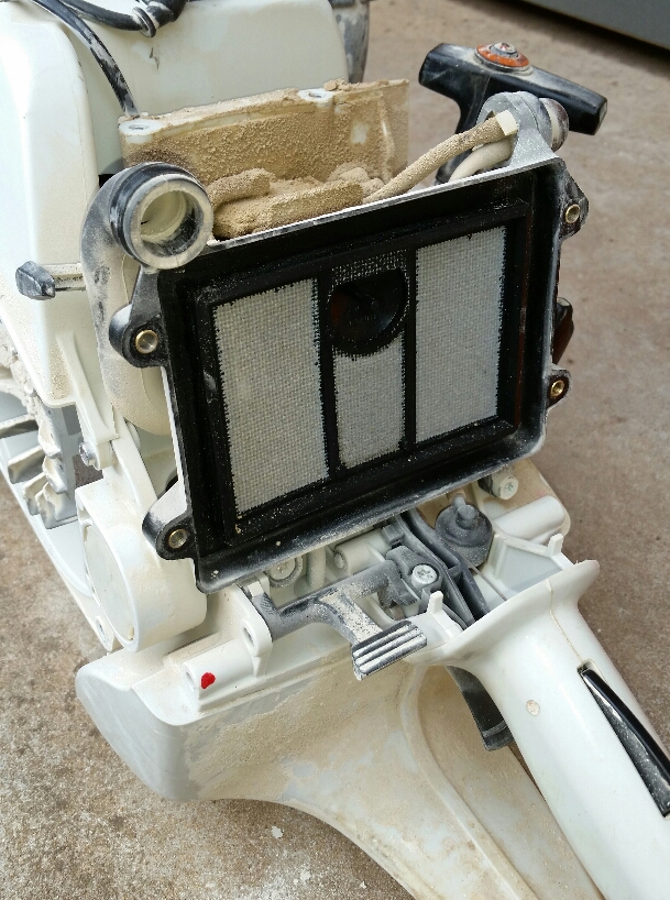

Rear of unit no air filter & Kill switch
2019-08-09 22.26.32.jpg (445.76 KiB) Viewed 5954 times
Kill switch close up
2019-08-09 22.26.42.jpg (409.71 KiB) Viewed 5954 times

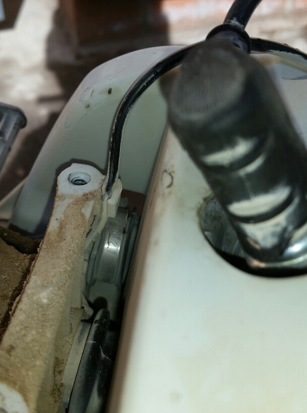

Other wire from coil
2019-08-09 22.29.18.jpg (315.71 KiB) Viewed 5954 times
So i assume the other wire from coil goes to the kill switch...? (Havnt studied book yet).
This wire (this last pic^) disapears down between front side of air intake & cylnder covers...cant see its end... :huh: ...the same wire you csn see in top left corner of 4th pic going down into guts of unit...
Cant see wire connection to kill switch--have to look at book to get me head around it yet...
These pics any good to your memory to give any tips/directions...
(I couldnt take more pics as it started raining).

Yeah one wire is the kill switch wire the other goes to the spark plug to ignite the coil with, just pull the wire off that goes to the kill switch and see if you get spark then, if so try and start it and when you want to shut it off just pull the choke out that will flood the carb and shut it off that way.
I'd unscrew that coil and give it a good clean and as I said before set the gap with a business card (turn that flywheel around until the magnet meets up with the coil (loosen the screws holding the coil, push a business card into where the contact of the coil meets the magnets on the flywheel push the coil up against the card/magnet and do the bolts up you have now set the gap for the coil, if you still don't get spart I would be looking for a new coil as that one's stuffed :thumbsup:

Ive had a look & havnt been sucessful at locating one (a coil)...
Emailed couple of ebay dealers here & OS with no luck...but that just seems my usual of late... :thumbsdown:
Ill keep you posted & if it is the coil ill see if you can find one...
Only need to find the time now...

Thanks cracker...
Yes ill try internet searching again when (&if) i establish the coil is st fault.
However, i did spend some time looking & tried the part number, & the only coil i could find that continually came up were the coil for smaller machine.
Not sure if they are the same (id have thought not).
Im.just struggling for time to pull it apart now...
Anyway...thanks for your help thus far...
