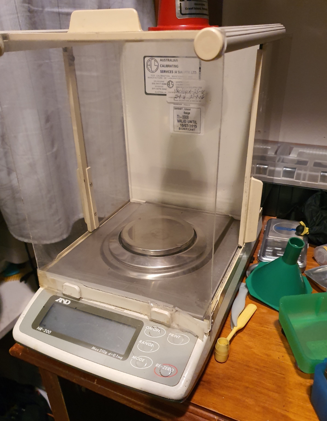

Cheap scaled including the hornady and even the rcbs charge master type scales just don't have emf insulation.
I have this old lab scale for reloading now, and even then I won't pour phone right next to it
This probably new was near on 3-5k AUD unit
