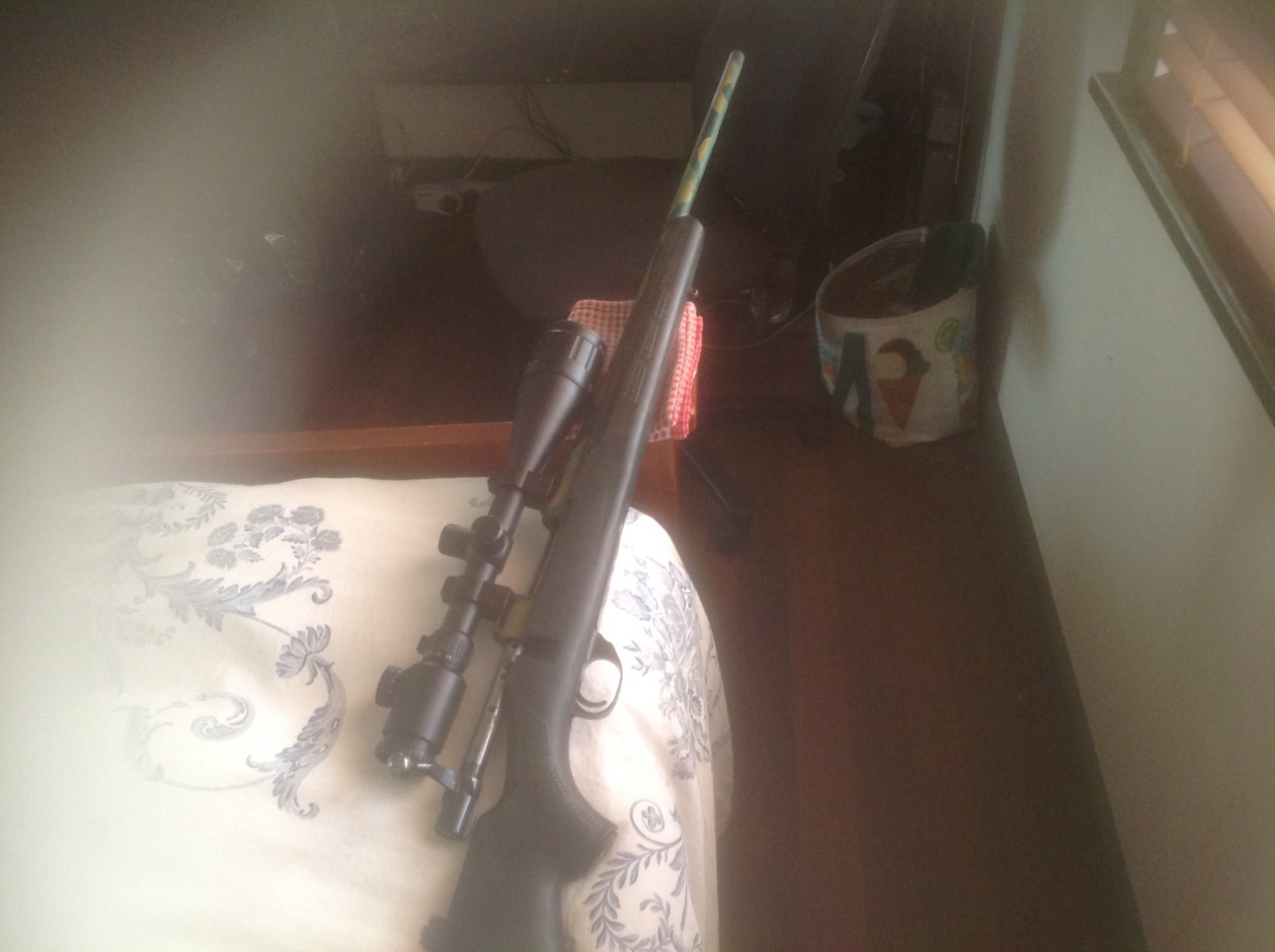

!:12 Howa 22 inch steel barrel.Its become my go to rifle for hunting and has a illuminated reticle.ADI lists a 100gn pill however I read an article that under 1000fps they go sideways All my .243 ammo is 80gn.I will follow your advice and make different loadings with PSP 80gn I have a lot of cases in .243 and all my .222 are loaded up plus the .222 is S/S and my .243 looks like this
