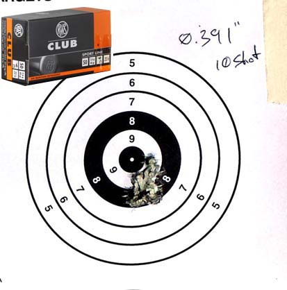

RWS Club - 0.391"
- rws club
- rws-10-shot-group.jpg (24.81 KiB) Viewed 23799 times

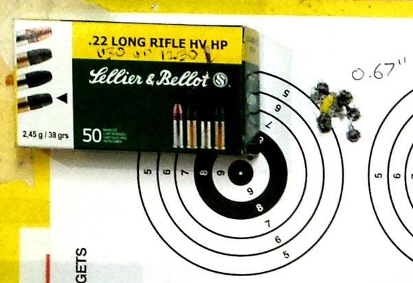

Sellier & Bellot HV HP - 0.67"
- sellier and bellot hv hp
- sellier-and-bellot-22lr-hv-hp.jpg (45.6 KiB) Viewed 23799 times

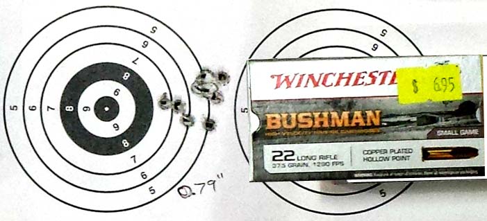

Winchester Bushman - 0.79"
- winchester bushman
- winchester-bushman-22lr.jpg (40.53 KiB) Viewed 23799 times

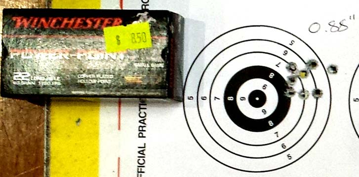

Winchester Power-Point - 0.88"
- winchester power point
- winchester-power-point.jpg (45.09 KiB) Viewed 23799 times

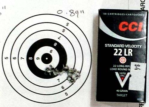

CCI Standard Velocity - 0.89"
- cci standard velocity
- cci-standard-velocity-22lr.jpg (30.3 KiB) Viewed 23799 times

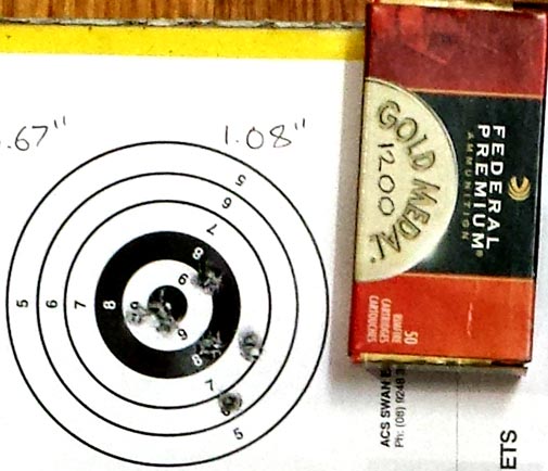

Federal Gold Medal - 1.08"
- federal gold medal
- federal-gold-medal-22lr.jpg (43.34 KiB) Viewed 23799 times

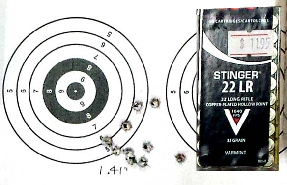

CCI Stinger - 1.14"
- cci stinger
- cci-stinger-22lr.jpg (36.19 KiB) Viewed 23799 times

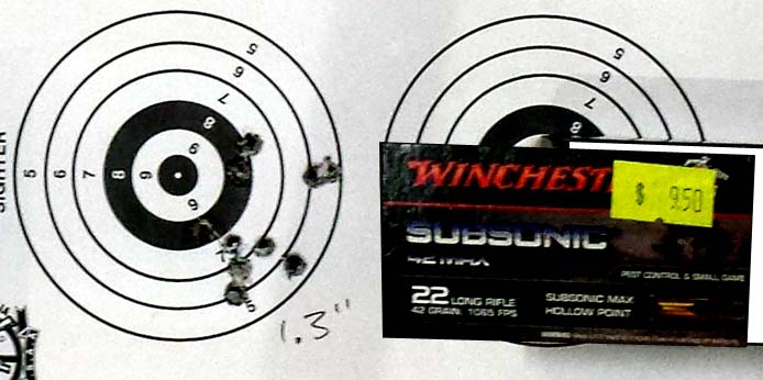

Winchester Subsonic - 1.3"
- winchester sub sonic 42 max
- winchester-sub-sonic-42-max.jpg (40.58 KiB) Viewed 23799 times
