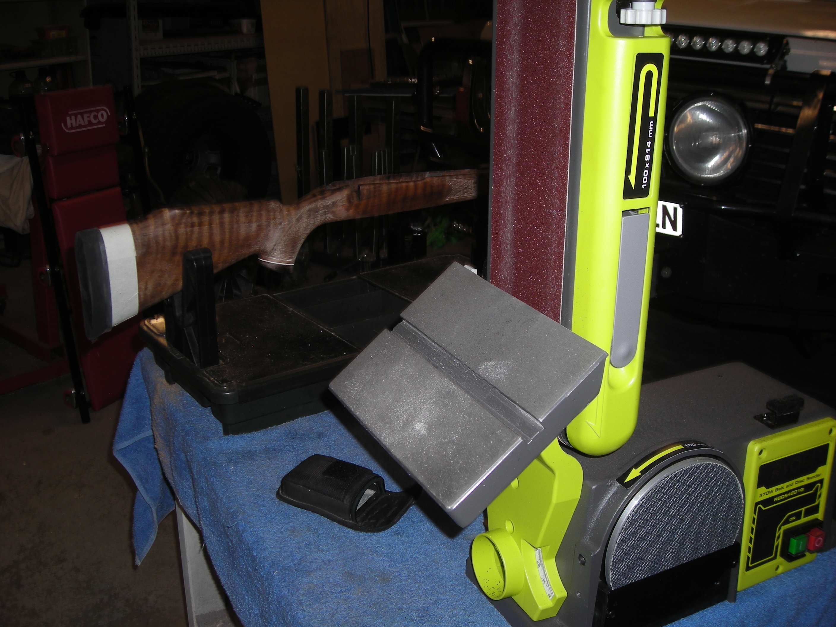

A bit of touching up with the stripper was needed. Interesting the previous finish did not bubble up like I have seen previously. Strange.
My new Ryobi linisher. Handy for this job.

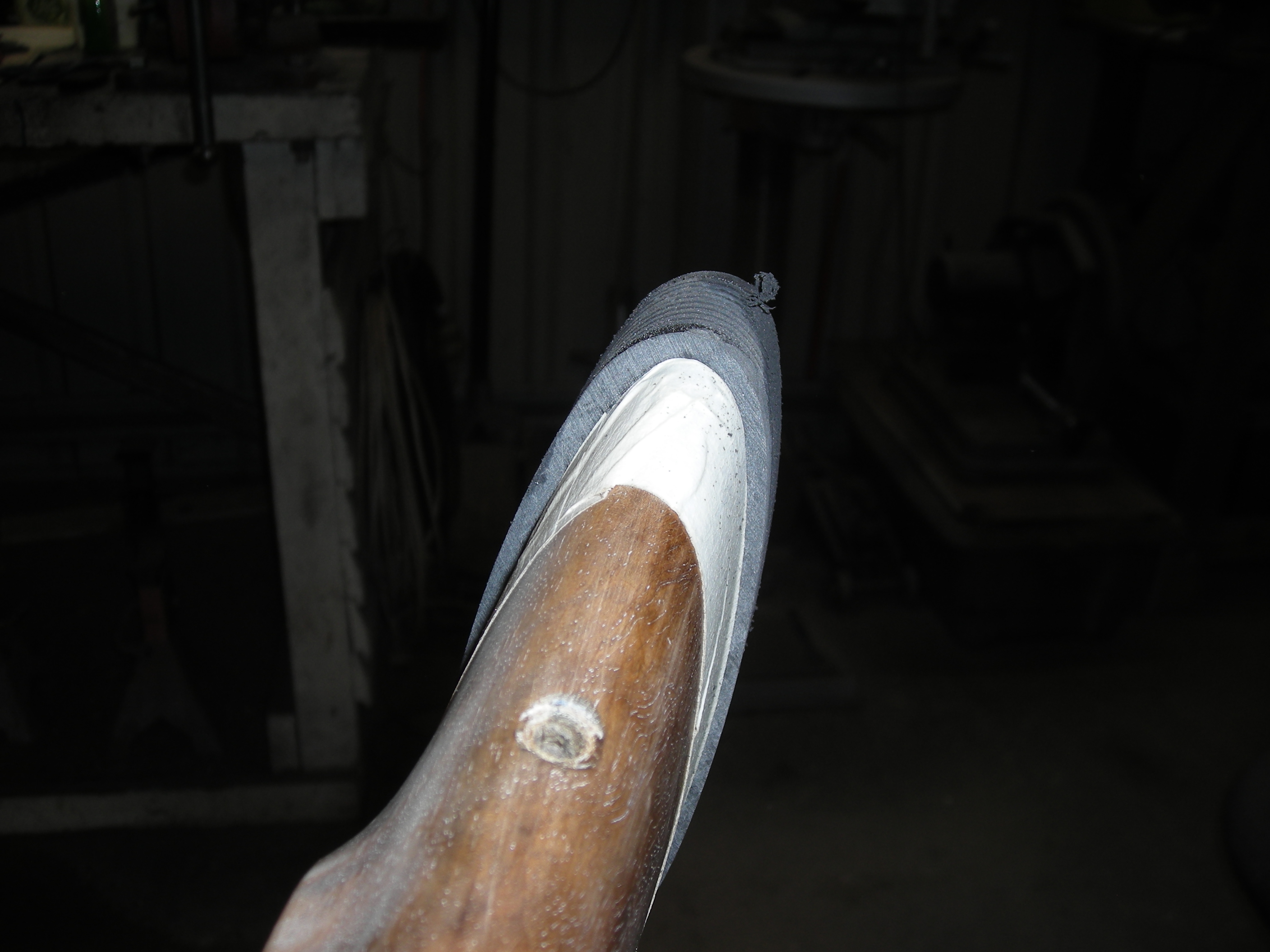

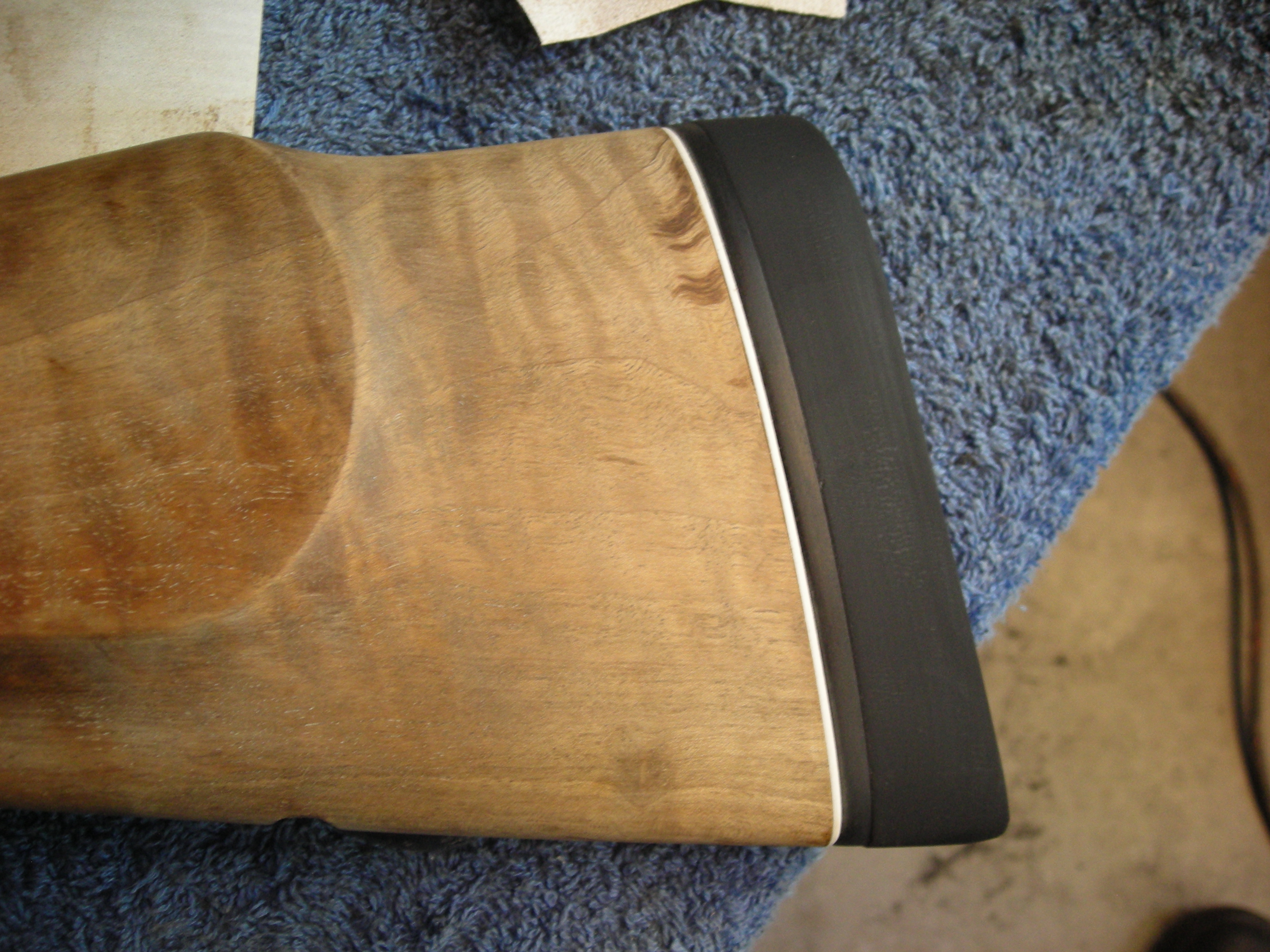

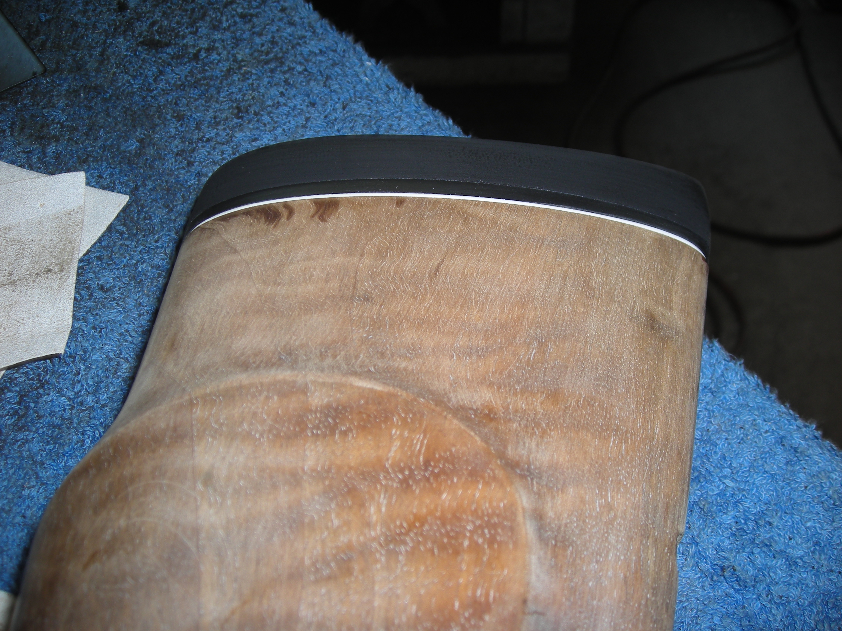

This is a Limbsaver "grind to fit" recoil pad. With common rifles you can buy pads that fit perfectly, but not for mine. This pad gives a very nice result, just a lot more work! :problem: I have used one before, so knew what I was up for, hence the linisher. I used a different method this time, and ground it to shape when fitted to the stock. Obviously you have to be very careful this way, but getting the profile to match the stock is much easier. So slow and steady is the go. I needed a 220-240 belt to finish it, but only found a 120 at Bunnings, so I had to finish it off by hand. More work! :crazy:
Recoil pad turned out well, so now on to the stock. After a light sand a good steaming, it came up pretty clean. A few dings in it were able to be removed, so now it will need sanding with various grades of paper and then finished off with 0000 steel wool before the Tru Oil can be applied. Some time consuming work now, to be done when time permits.

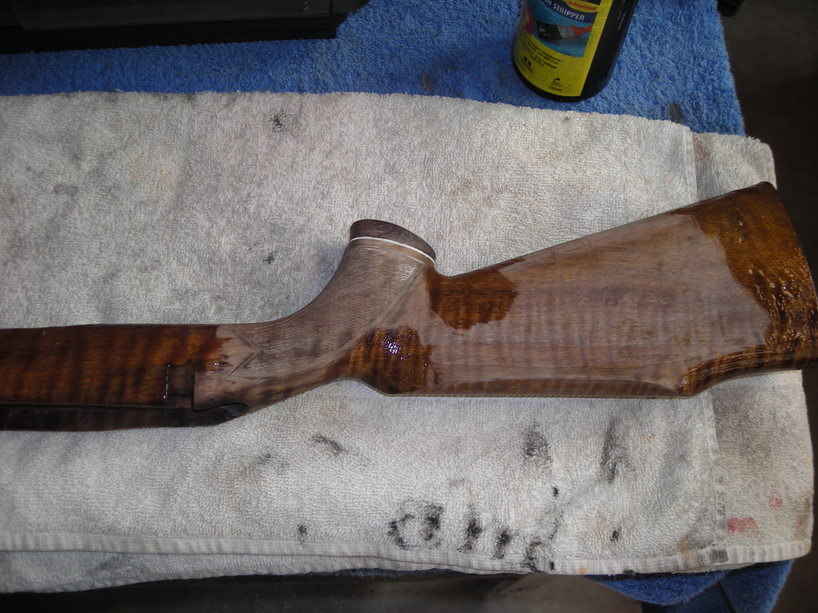

Stock has had a lot of work, and is now getting the final coats of oil. Looking good I reckon.

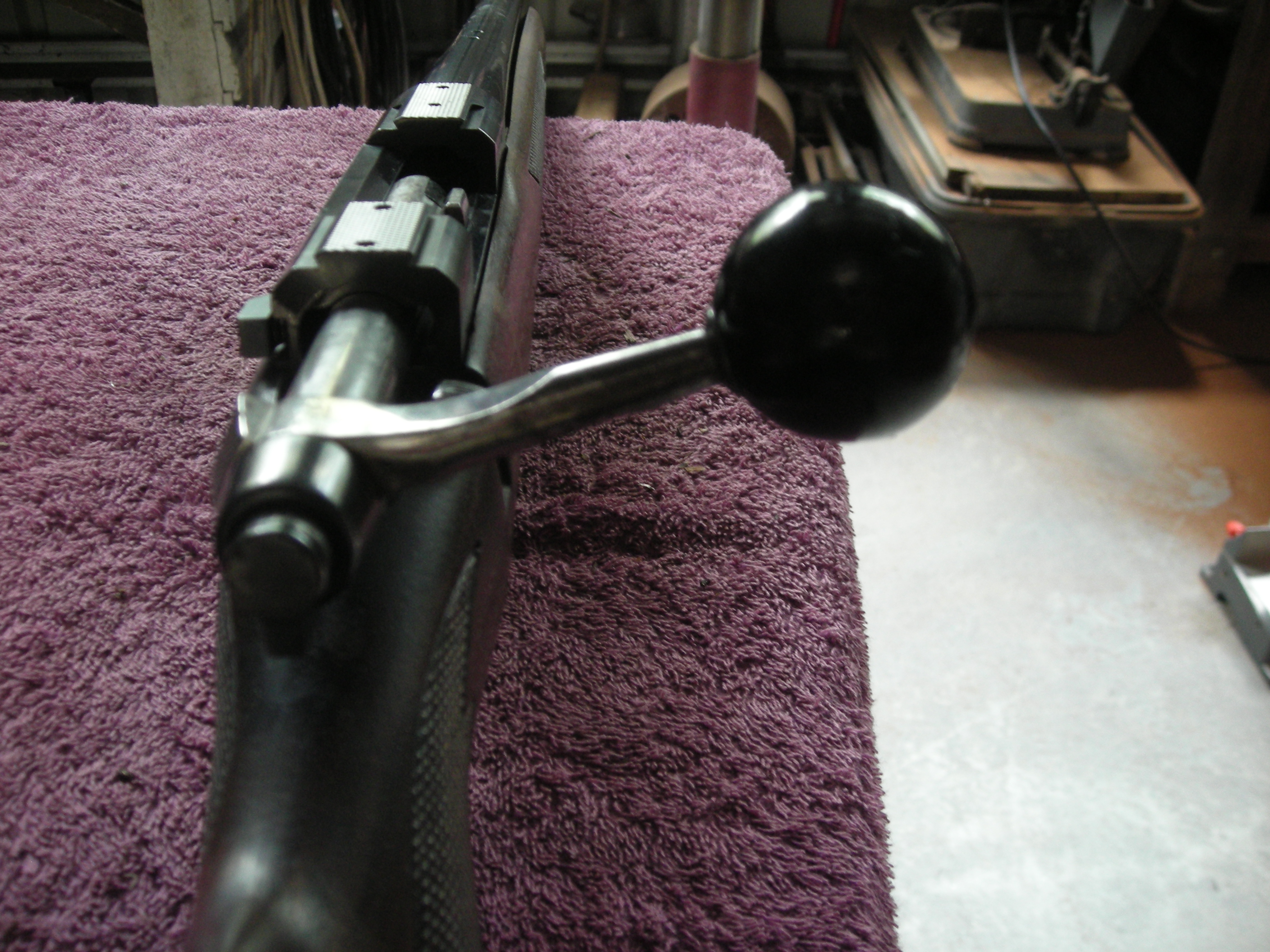

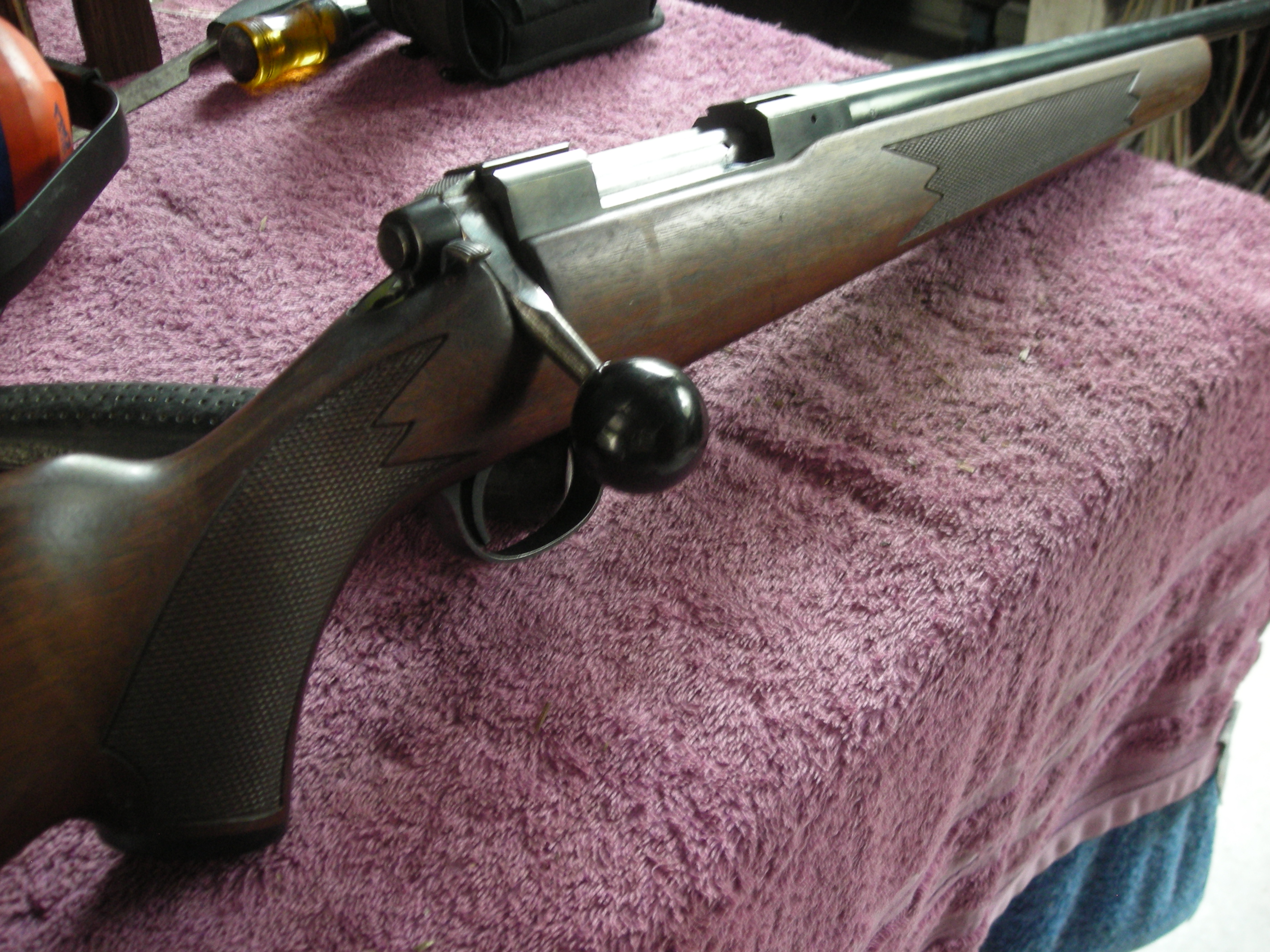

But there is one problem that I am yet to fix. I am not liking the factory bolt knob.
Here is my LSA55 bolt, which is much better. It is one piece, where the M55 has the plastic knob that screws on.
So the plastic knob needs to be deposited in the rubbish bin, and a nice replacement fitted instead. Some googling turned up nothing I wanted to fit, so I will have to make something. Hopefully, whatever I make wont end up in the bin as well. :roll:

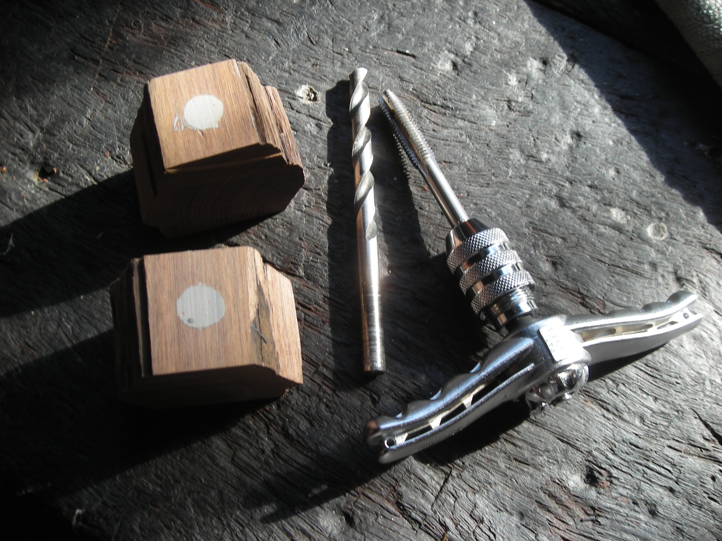

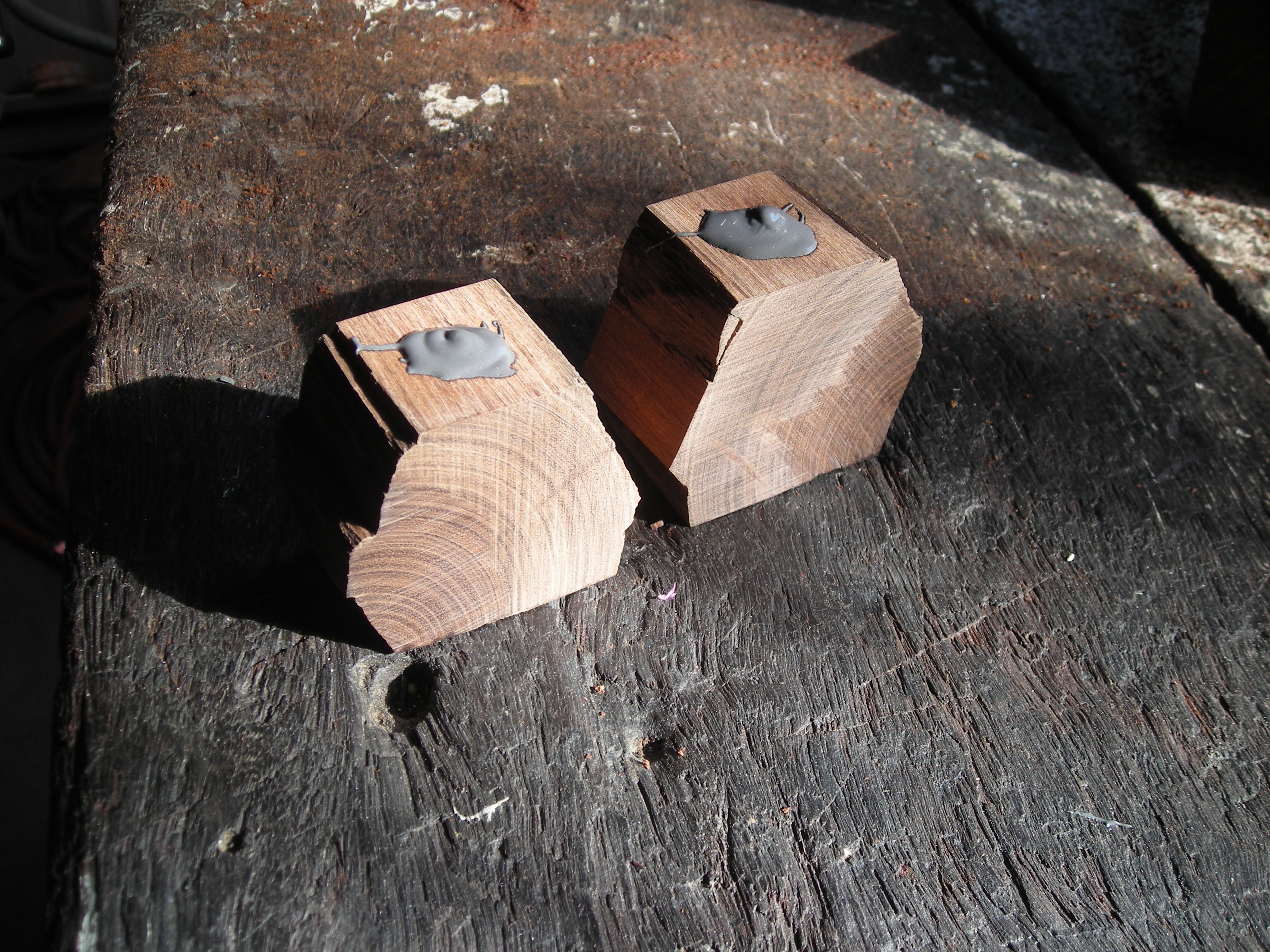

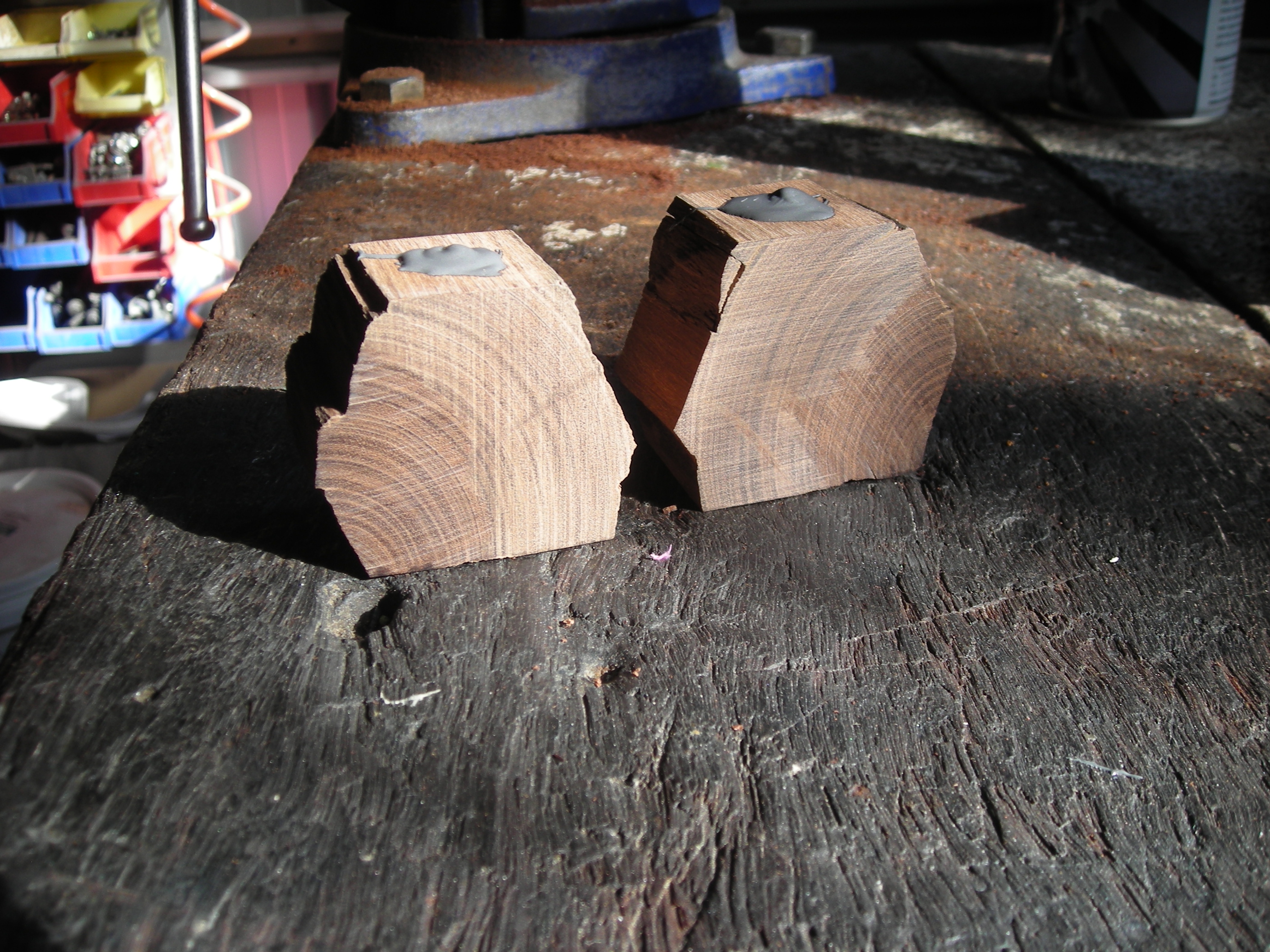

Commencement of custom made handles (two). I made a prototype as an experiment to see what I could do, with what tools I have - no lathe. So it has to be done by hand. So that rules out a couple of ideas, as they were too hard to make. Prototype was ok, so Dad asked me to make him one as well. Having decided on a method, I am using an old gidgee fence post as the donor for the timber. It is prevalent in the west where I learned to hunt as a boy, so I have preferred it to something else for sentimental reasons. I think also it will look good, as it is as hard as stone and has a very tight dark grain.
In order to have a thread in it, I have filled a hole with JB Weld, so that it can be drilled and tapped to suit the bolt handle.
So far two prototypes are going in the bin, but the other two are looking good so far. Ready for oiling now.

Thanks. I had a look to try and just buy one, but I am not keen on the "tactical" style of stuff which is most of what I saw for sale. None of it was any better than the plastic knob I wanted to replace. :problem:
And then I spotted a Blaser timber bolt handle. I did not see another one on any other brand of rifle at all, but of course many owners would have done it, I just did not see one with my googling. Without a lathe at my disposal, I had to think about what I could make too, so steel was out. But timber was a good idea I thought, so a dark piece of hardwood to match the grip cap etc on the stock would suit. In looking for a suitable piece of timber, I remembered the gidgee fence posts we had brought back from out west some years ago. It is "serious" wood this stuff. When it gets old and hard you cannot cut it with a chain saw. We used a drop saw with a tungsten blade in it! LOL
My first prototypes turned out ok, made with the grain of the timber. But the blocks above have been cut cross grain, and with the shape of the handles, much more figuring is now visible. Harder to make, but turned out well. Shed looked like a sawmill, with offcuts and sawdust everywhere, all to produce two small handles that fit in the palm of my hand. LOL :D
I am putting the final coats of oil on the stock, and these handles, so when that is finished I will put up a pic of the finished wood.

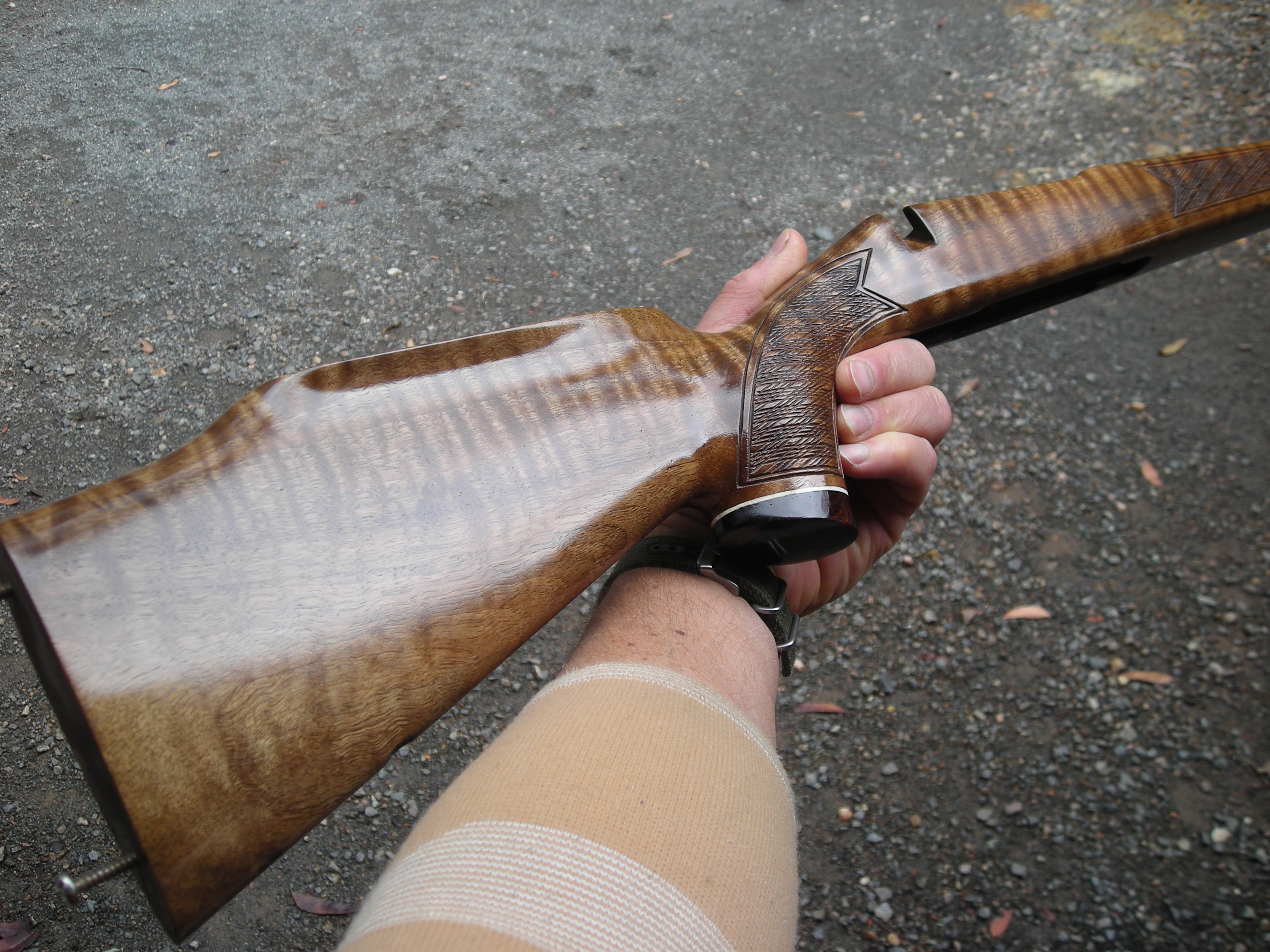

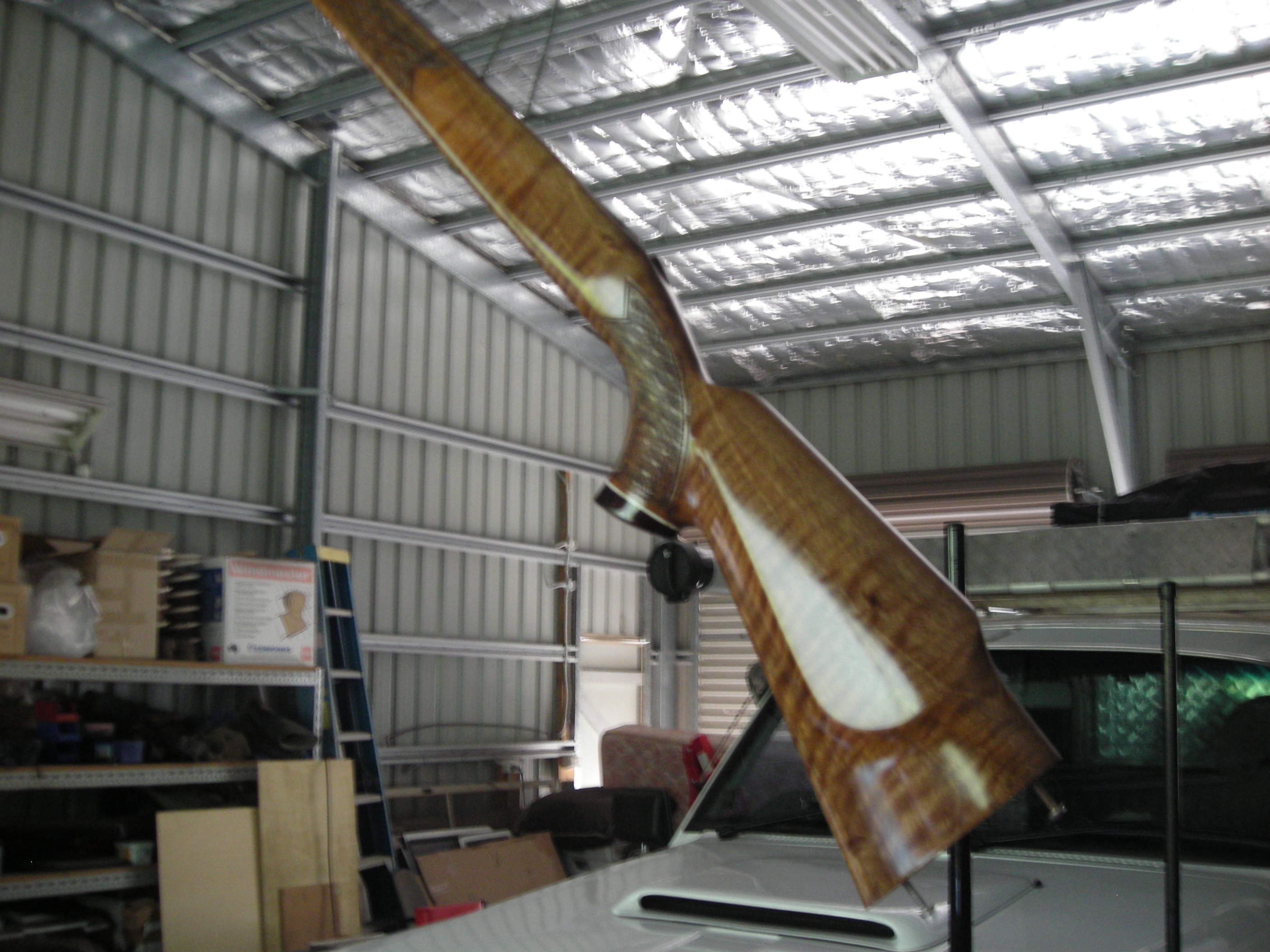

Final coats of the Tru Oil have gone on the stock, following my method of applying many light coats with a soft cloth, and some rubbing to get a smooth finish on each coat. Finish has turned out well. With all the work on the stock, the timber is now improved over how I bought it, but photos will not really show that. It was pretty good before, so really only imperfections have been removed and surface improved through sanding, steaming, rubbing with steel wool etc. Looks good.
But, it now has what I call the "Rigby Look", and that is very glossy. Great if you like glossy, but I prefer a satin finish. The standard method for Tru Oil is to use Gun Stock Conditioner to give a satin finish, but I have found that a bit average. So I am trying something different this time. Some googling turned up lots of people using Tru Oil on guitars and furniture, and one method they favour is a carnuba wax finish. Birchwood Casey sell a wax to be used after Tru Oil, but I have none of that so I will try some carnuba. I have done a test piece which looks promising, so after another week of curing time, I will give that a try.
This is how Tru Oil turns out "off the gun".

Looks like all that rubbing and sanding paid off mate, I use to enjoy using Tru oil but changed over to a furniture makes Tung oil for a more satin finish.
I would have been tempted to remove the white line spacers.....

Thanks fellas. I will take a pic of the bolt handle after I have done the final finish on the timber. Most probably this weekend. If it turns out how I want, otherwise it will be re-oiled and try again. I did not take progress pics of it, but I did it by hand, with sandpaper and initially with the linisher.
I like the white line spacers! LOL No thought to get rid of them, even though the one on the butt makes it a lot harder to do a new recoil pad. As for oil, I would consider another one next time, but the Tru Oil works well. Maybe. :unknown:

I tried something different on this stock, and have finished it with a wax finish. I think it now looks like many factory timber stocked rifles you see now. No doubt the process is different, but it is less glossy than it was before with just the Tru Oil, a bit lighter in colour, and very smooth.
Bolt handle is quite understated, but in comparison to the original one, I like it a lot better. And it is a personalised piece, something that cannot be bought, and made from timber collected from where I have hunted in western Qld - gidgee.

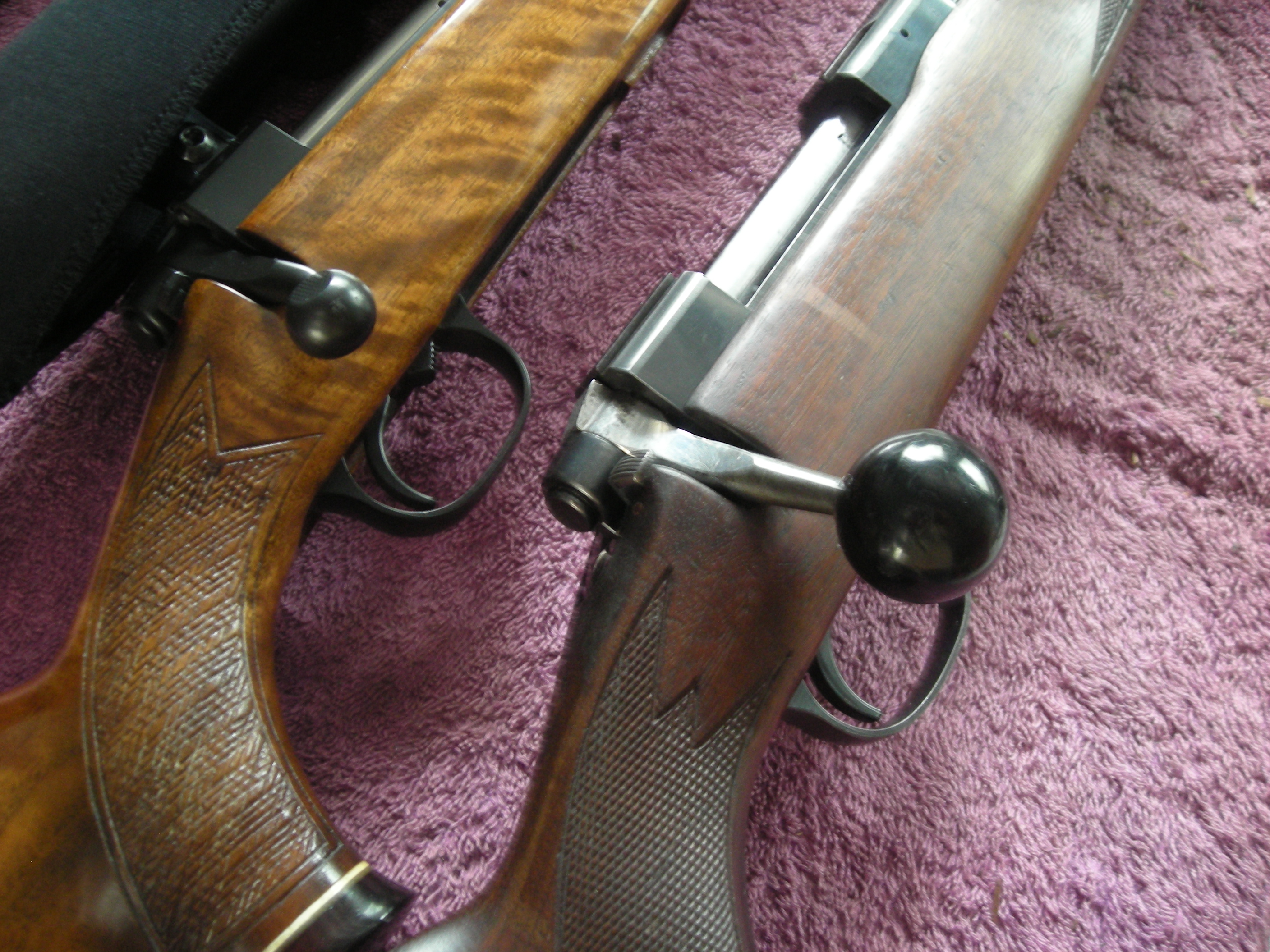

Post by GQshayne » 12 Jan 2020, 4:22 pm
Here is the original stock, with an "off the gun" Tru Oil Finish using my method. From here, there a few options to finish it depending on preference, but seeing as I do not need it, it will be sold. No point me picking the finishing touch, so I will leave it to the new owner to make it satin, waxed etc.
GQshayne
Posts: 1032
Re: .17 Remington Project Rifle
Post by GQshayne » 12 Jan 2020, 4:25 pm
And here is the old stock compared to the Deluxe stock I have for it.
