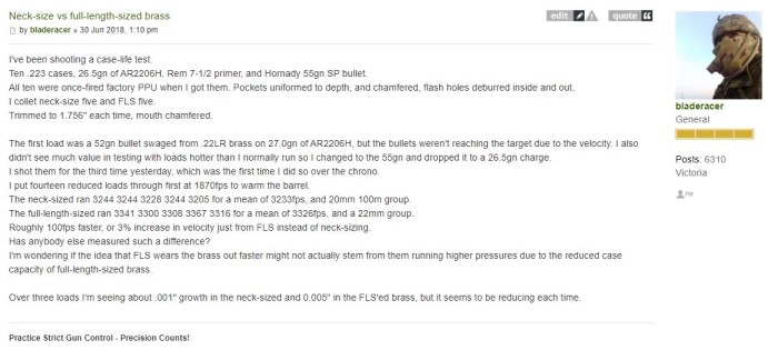

Just checked my logbook.
I tested neck-sized alongside shoulder-bumped by alternating them in the same set of five cases in .223Rem.
55gn RooMax on 26.5gn of AR2206H at 2.290".
Bumping the shoulder gives me 3326fps average with an ES over five rounds of 67fps.
Neck-sized gives me 3233fps average with an ES over five rounds of 39fps.

Actually, I did group them at least once.
https://enoughgun.com/forum/viewtopic.php?f=3&t=10133
Neck vs FLSb.jpg (53.07 KiB) Viewed 3399 times
I didn't record any difference in POI so it was probably not significant or measureable.
It would depend on where the load sits in the node, if you're close to the edge of a node, that 100fps could push it well out of the node.
