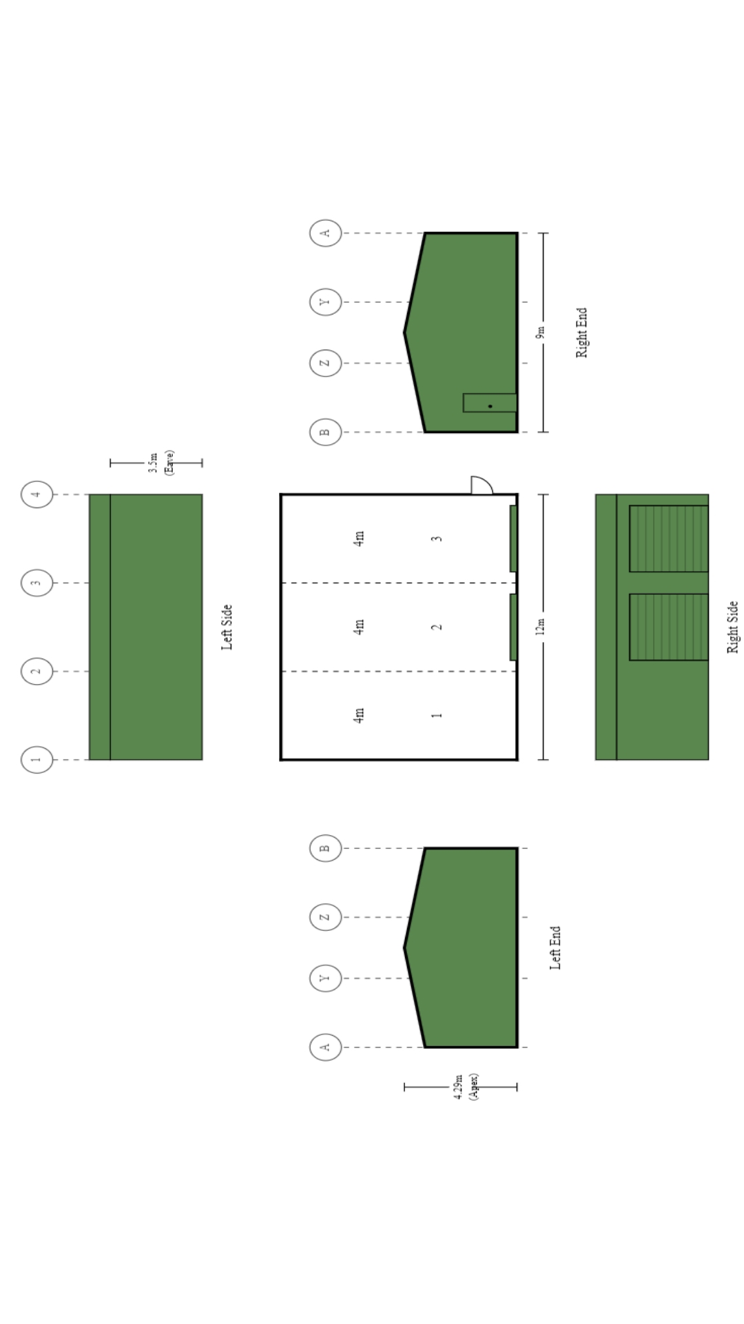

Post by Kelsey Cooter » 15 Feb 2020, 3:54 pm
Here's the shed I'm planning to build, with the vault/storeroom being in the bay with no roller door

Kelsey...the roof sheeting used in the other vault is a common form of constriction, & is cheaper...you can often see it in multi storey commercial buildings like some carparks...and even aged care facilities etc...but it is often covered by dropdown ceilings that house all the services.
That steel sheeting spans a long way & can take a good load of concrete... :thumbsup:
Yes over time, particularly if not well designed, the steel sheeting can rust, but it shouldnt degrade the concrete in any major way if it is poured & compacted properly.
