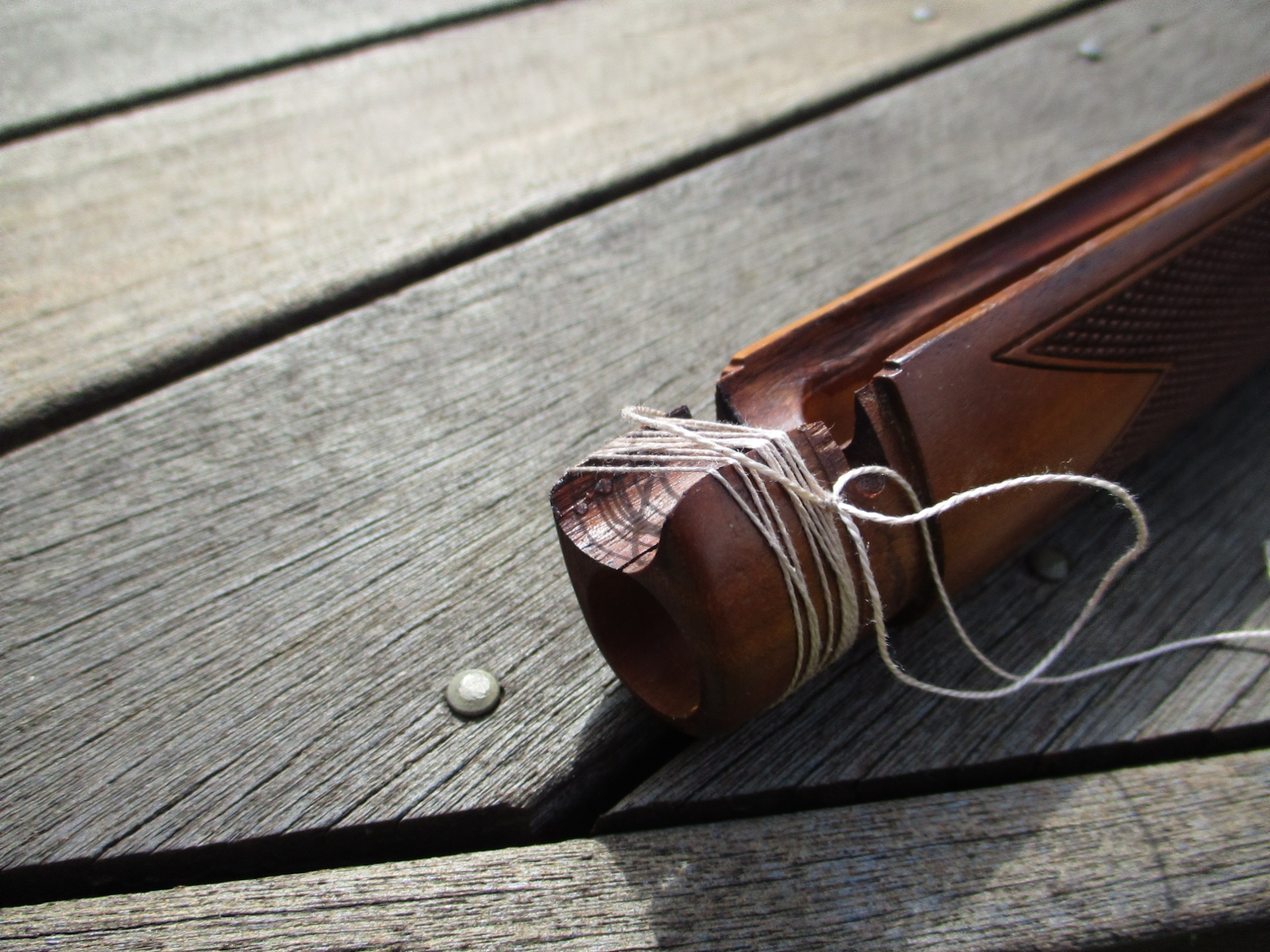

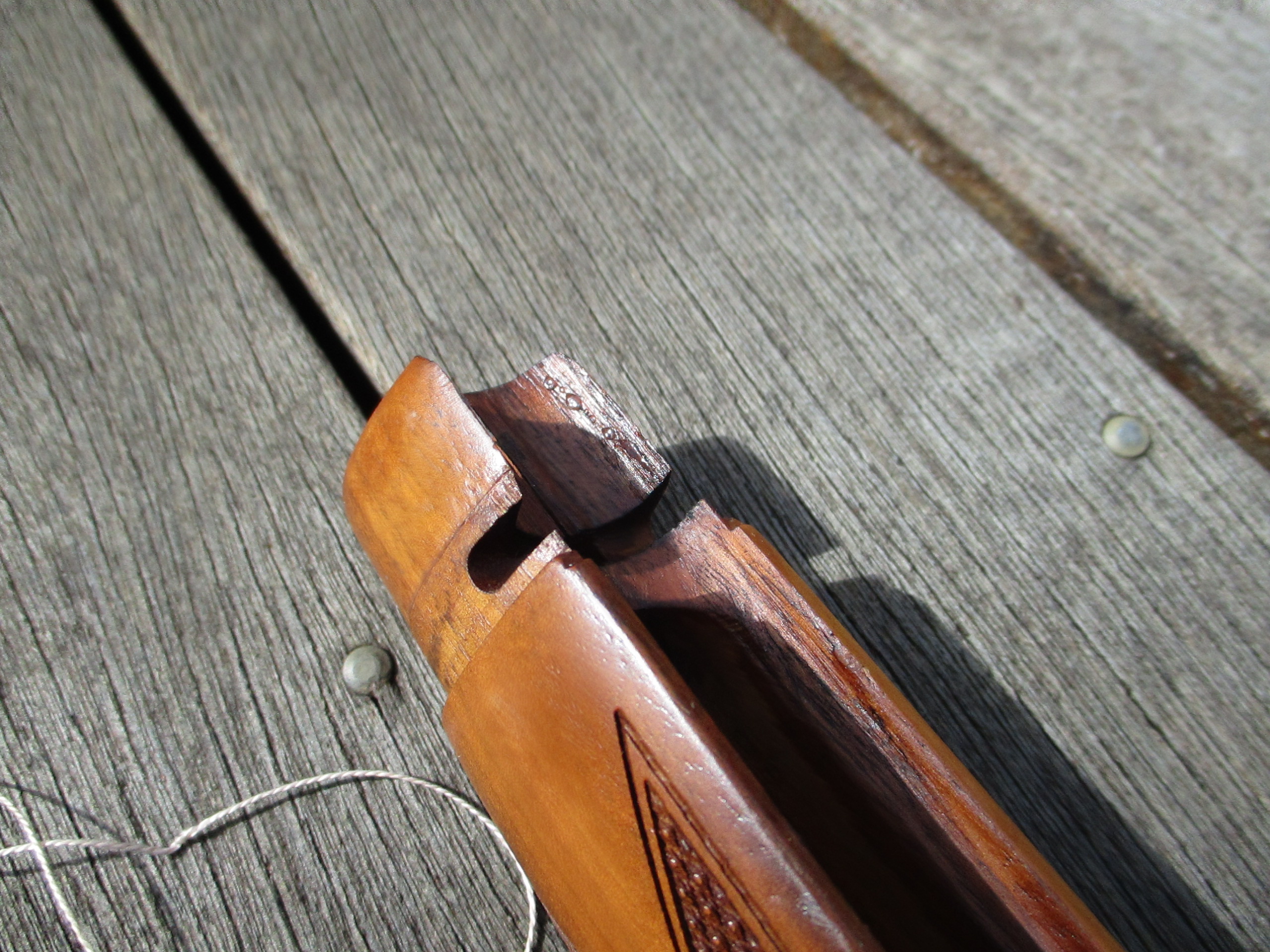

A better view of the crack?
2018-11-18 15.00.25.jpg (1.82 MiB) Viewed 8939 times
The Least Of My Problems
2018-11-18 14.59.01.jpg (1.59 MiB) Viewed 8939 times
Wm. TRAYNOR EATS HUMBLE PIE
It is my melancholy duty to inform the forum, that the O-ring fix was no fix at all. During testing at Imbil yesterday, the dreaded stringing reappeared. Examination of the rifle revealed that the mag tube was protruding past the muzzle :crazy: Stripping the rifle revealed a crack in the fore-end :wtf:
You can just see the dried beads of glue.
Hmmm. Not sure if these pics posted in the right order but anyway that was an easy fix. However, the main problem remains. While things were apart it was apparent that the mag tube and barrel are in contact; I think. Much more work to do. In the meantime, don't buy one of these @#$%^ things.

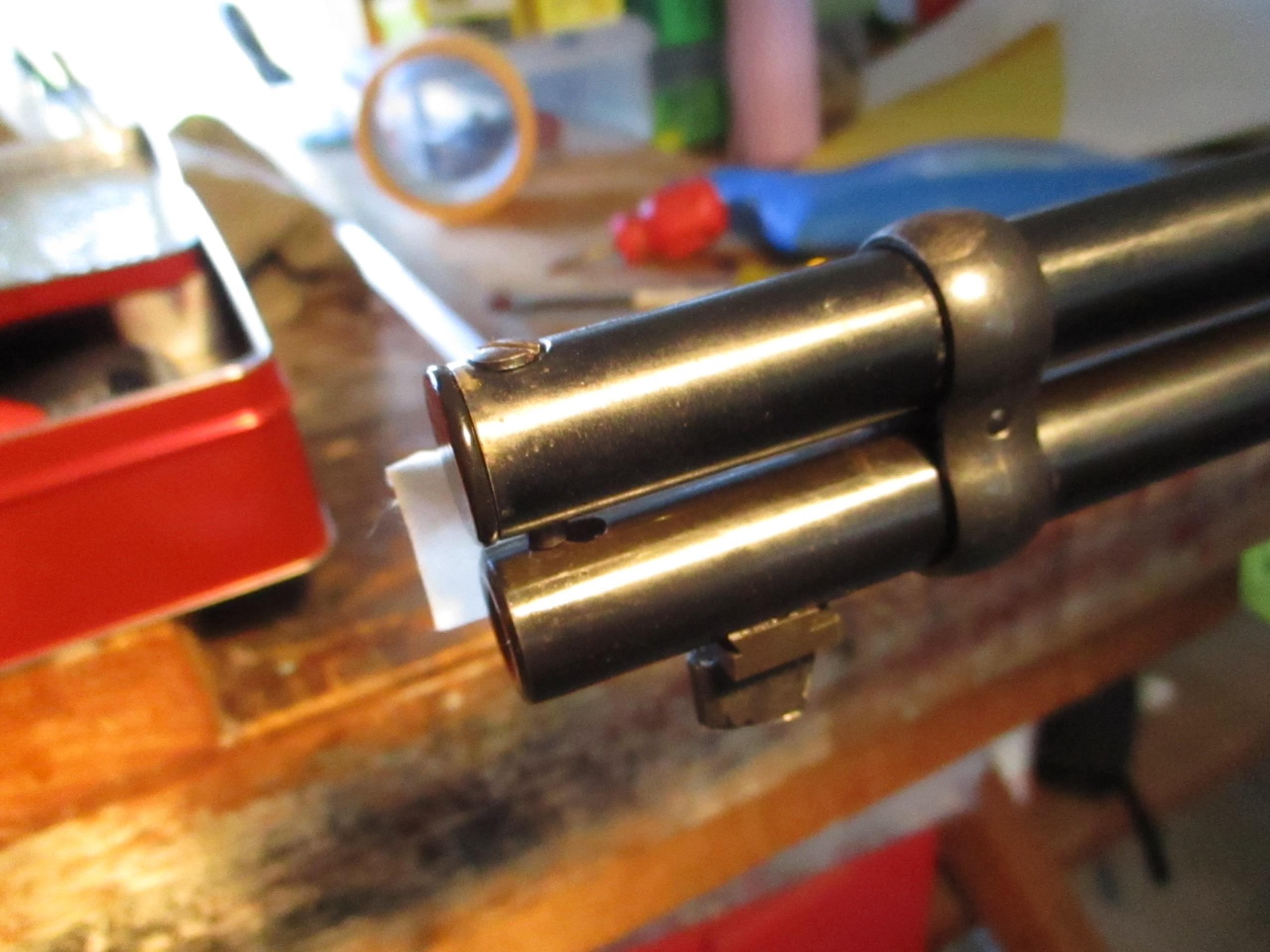

For some reason I fitted the mag tube to the barrel. No idea why. This shows how it fits at the muzzle-end.
2018-11-19 15.54.07.jpg (1.25 MiB) Viewed 8927 times
The tube has been gently pulled as far forward as possible

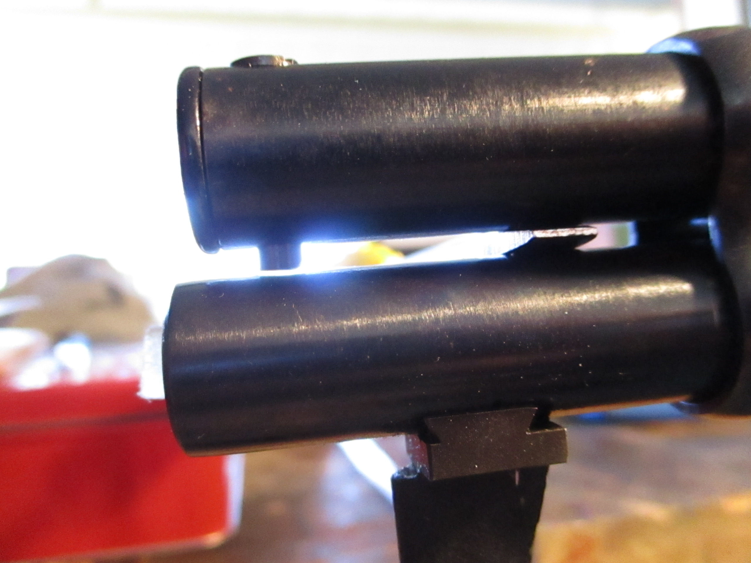

The tube has been moved all the way back. The blind hole in the barrel is for the turned-down section to fit into. Plainly. the tube is free to move, playing havoc with the elevation, I think.
2018-11-19 15.57.10.jpg (934.55 KiB) Viewed 8927 times
2018-11-19 16.27.33.jpg (1.08 MiB) Viewed 8922 times
[attachment=0] That is the tip of a screwdriver between barrel and tube. There is quite a bit of clearance between screw and barrel, never mind the screw's hole. No wonder the tube was able to slide forward.

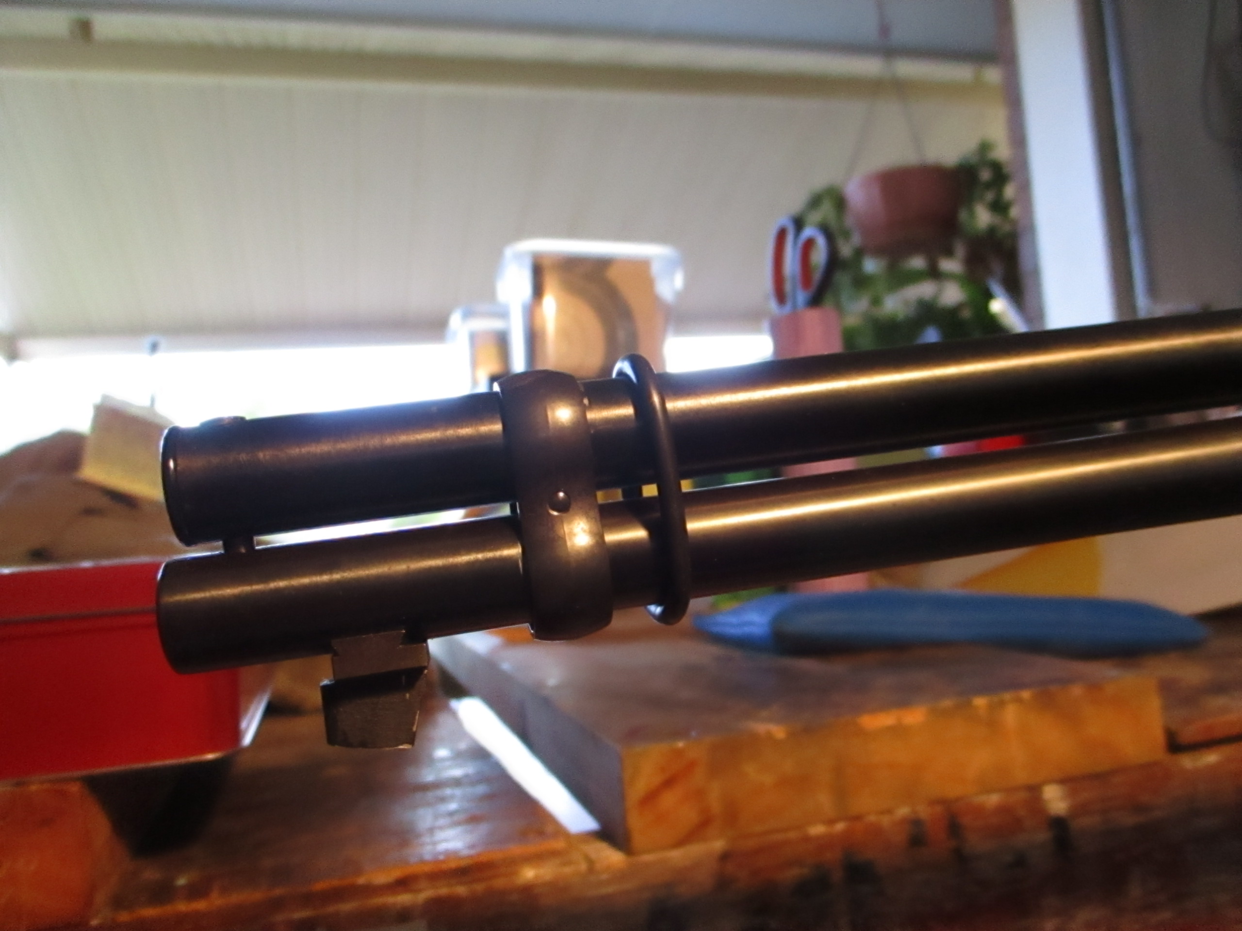

2018-11-19 16.31.45.jpg (1.05 MiB) Viewed 8921 times
Yes, this O-ring clamps barrel and mag tube in place but I'm not really serious. There must be a better way to stabilise the tube and reduce stringing.

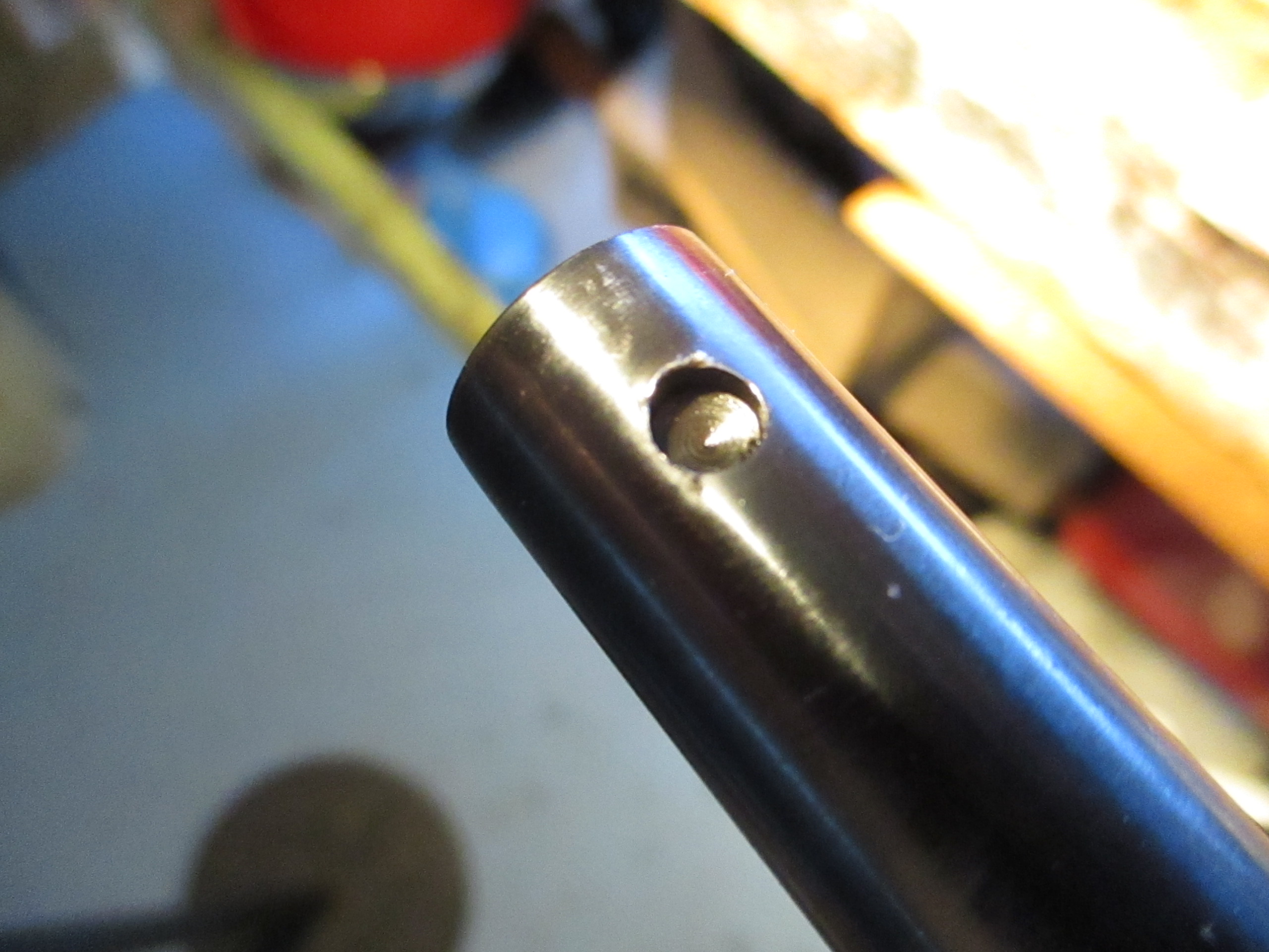

Post by Wm.Traynor » 19 Nov 2018, 8:57 pm

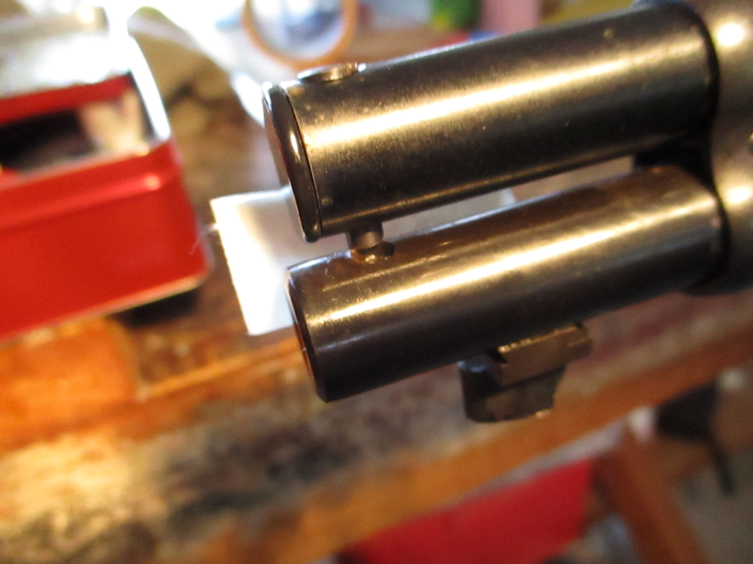

2018-11-19 16.42.07.jpg (1.17 MiB) Viewed 8921 times
This is the underside of the barrel, showing the blind hole that the screw is supposed to fit into. You can just make out, at the muzzle end of the hole, a shiny bright area. There is some slight deformation of the perimeter of the hole here, which leads me to believe that the screw has been colliding with the barrel, on its way out of the hole during firing.
Posts: 1825
Re: How Can I Fix Vertical Stringing?
Post by Wm.Traynor » 19 Nov 2018, 9:04 pm
2018-11-19 16.41.28.jpg (1.31 MiB) Viewed 8948 times
This is that pesky screw. At the flat, smooth-turned, tip you can make out a "bevel". I wonder if this has been formed/deformed by colliding with the forward edge of the hole? Well, that's my theory................for now ;)
Posts: 1825
Post by Wm.Traynor » 19 Nov 2018, 9:13 pm
A slightly better view of the "bevel", which is at six o'clock on the flat tip.
2018-11-19 16.40.51.jpg (1.47 MiB) Viewed 8948 times
Posts: 1825
Post by Wm.Traynor » 19 Nov 2018, 9:25 pm
The question now remains as to what to do to stop the tube sliding forward. I'll have to think about that but a screw of the right length comes to mind. I wonder if this is a stock screw or a bodgey one and what would they send me if I ordered a new one?
Post by Wm.Traynor » 20 Nov 2018, 7:39 pm
At this point, I have only questions. For instance, "What is the proper function of the Magazine Cap Screw?" We know that it holds the cap secure in the tube but the length of unthreaded, turned-down section could have two functions, namely 1) to stop the tube sliding and 2) to apply pressure to the underside of the barrel, as a means of "tuning" the vertical spread. My MCS performs neither function because contact is haphazard, random and unreliable.
And then there is marksman's point about a warping barrel but to test that idea the tube has to stop creeping. Did I mention that the tube can be moved backwards and forwards when the front barrel band (FBB )is tightened firmly? There are cut-outs in the bottom of the barrel and top of the tube for the screw but this fastener does not make enough contact with the mag tube to prevent movement. I am thinking of packing the bottom of the lower half of the band which will raise the whole tube. This will make the MCS fit inside the blind barrel hole. That way both the MCS and the FBB will prevent sliding...............I hope ;)
