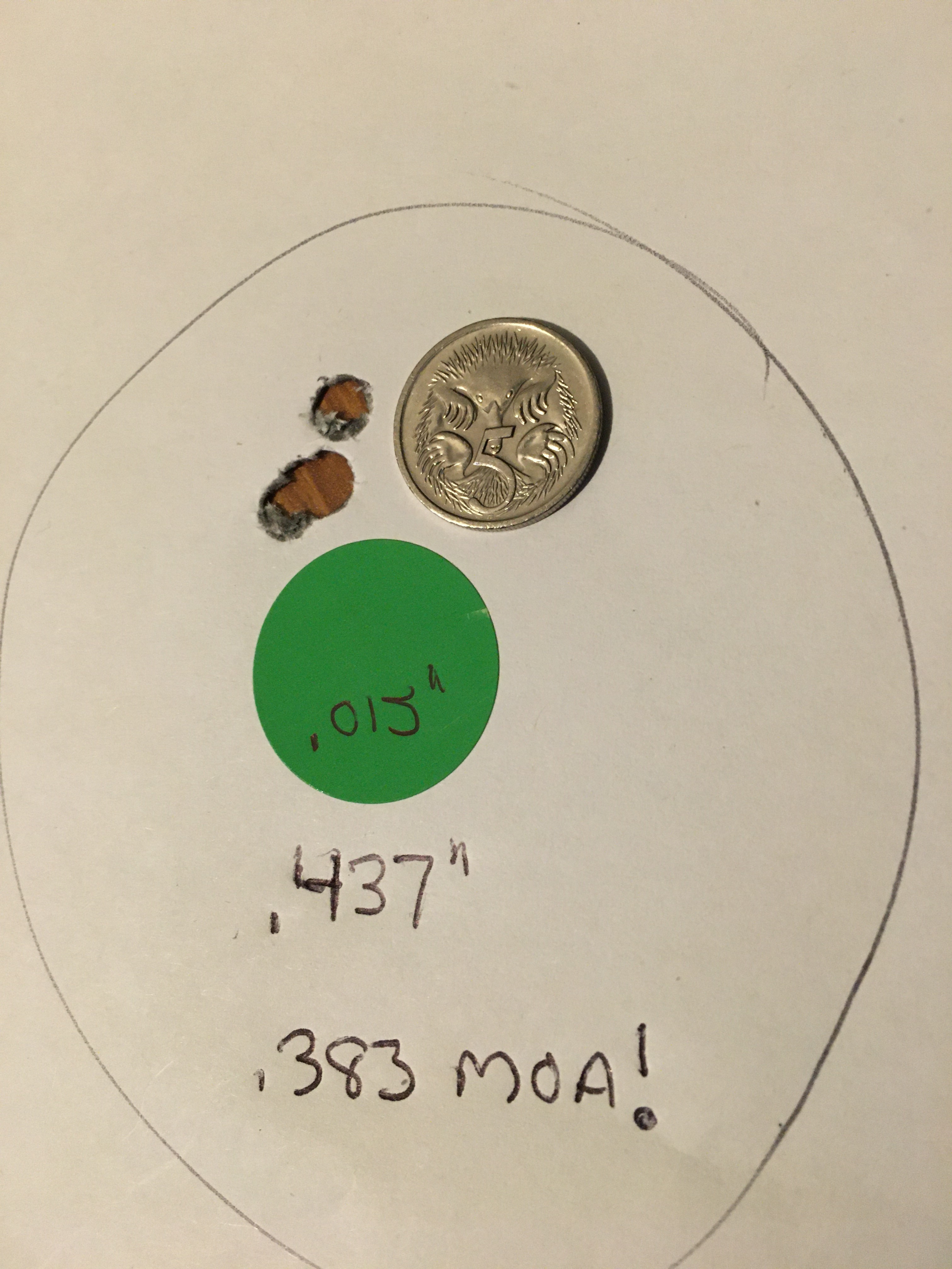

Post by Jarhead » 24 Jun 2020, 6:47 pm
Hi All,
I though I would share some good result from Saturday's load development session.
I test the seating depth and found that .015 is a sweet spot...Tightest 4 shot group I have ever made without cheating!
Next step- get it down to .25MOA.
Hopefully get there this weekend....
Regards!

Post by Harrynsw » 24 Jun 2020, 7:13 pm
Pretty awesome when the flyer is less than half inch away

Post by marksman » 24 Jun 2020, 7:22 pm
if you really want to shoot small aim small
put a small dot in the middle of your green dot to aim for
good shooting :drinks:
Re: Load development success
Post by Blr243 » 24 Jun 2020, 7:22 pm
Yes seating , but obviously you are shooting really really well too. I have not seen that group b4

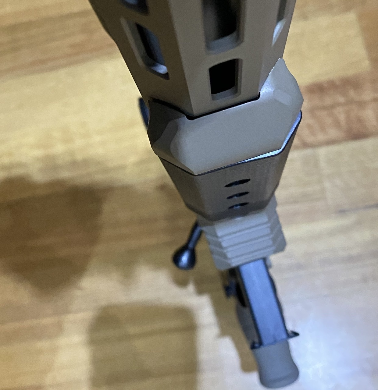

Post by TassieTiger » 25 Jun 2020, 10:58 pm
Very nice shooting!!!!
I’d caution you on buying MDT if you are already getting results like that...at least do some research. I’ve had a bit of a time with MDT and they have proven today - they remove negative feedback re their products...

Post by TassieTiger » 27 Jun 2020, 9:09 am
Jarhead wrote:Tassie Tiger,
I read through your bent MDT chassis dilemma post with great interest before I ordered mine. I almost didn't order it -but I bounced a few questions off a few friends in the US who each have several MDT setups and they were all surprised looking at yours. I think you just got unlucky and they shipped you a lone bad one.
Plus I ordered a different model- the LSS Gen 2 XL - Southpaws have less choice.
But who knows- I have made many bad decisions before (mostly involving the pursuit of females, spending money or consuming alcohol- sometimes all at once!) and this could be one.
You will know if it is a bad choice because if my Chassis is as wonky as your's I will drag my sorry @$$ back to this forum and 'fess up.
Did the new chassis arrive and everything get sorted in the end?
No mate - it didn’t.
The new chassis arrived a couple days ago.
The barrel alignment issue is now fixed but there are a few other quality issues...ie - forget the handgrip problem, check out the mating of surfaces between chassis and foreend...looks like it was made by...someone that uses the word precision, a little too often in the vocabulary lol.
I’ve sent that photo to mdt - they were not happy. They are trying again - chassis no 3...they did originally say they’d test for a full system and send that - based on my order, but they reneged on that saying it was cosmetics - predominantly - that’s when I pointed them to this photo...nothing. They even deleted my feedback on their forum. Lol. Hopefully yours is all good. Many I’ve seen are pretty decent, I must have just got unlucky...twice lol.
Post by marksman » 27 Jun 2020, 11:29 am
that fit is really bad Tassie :thumbsdown:
its not like you bought a cheap chinese copy :unknown:
Post by TassieTiger » 27 Jun 2020, 11:46 am
They are crap MM.
When they emailed me and said what the fix was for hand guard (Me fixing their poor QC) - they also added in - that they thought this would resolve my issues, so didn’t feel it necessary to still send a replacement, let alone a complete order.
I literally said what ever - don’t care, but fit and fitment of the two components was more of a concern than the hand guard. THEN they acknowledged it...like, maybe I didn’t see it ? So 3rd time lucky with chassis - but, maybe, it’s the foreend...what ever now - over it. I’ll sort it as per your advice. Eventually.
They sent me a copy of what I’d bought to make the entire chassis complete;
$1400 for everything...so as Stix now does with his shotgun brand, anyone who asks will get my experiences...and photos.

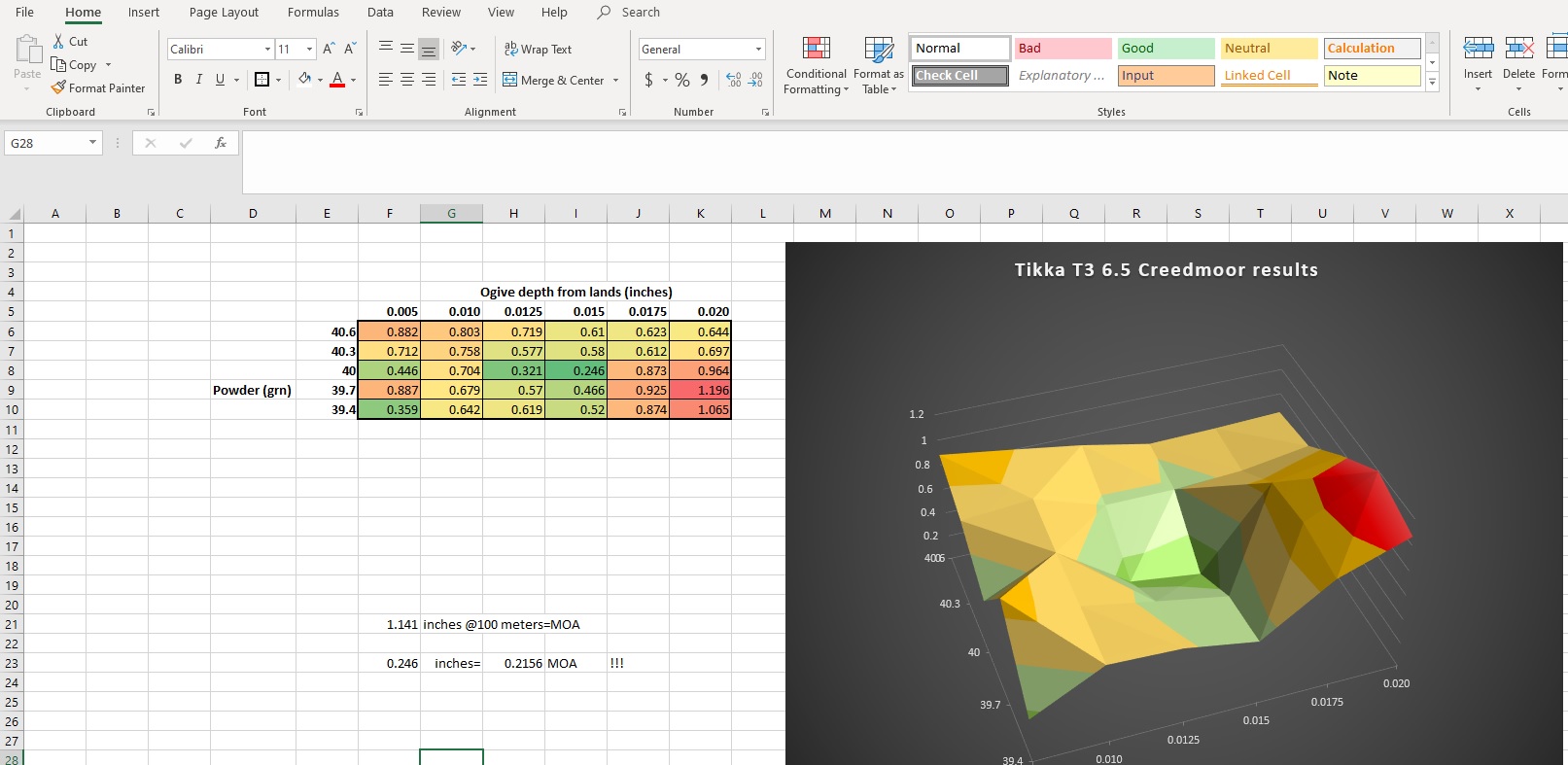

Post by Jarhead » 04 Jul 2020, 4:33 pm
Woo-Hoo! After a cold 6 degree C morning at Hilltop- Here it is...… .238 MOA!!!!
I don't know what to say! I love this rifle! Every time I shoot it, I get better and better results!
Herci,
you are right- the silver Echidna is looking justifiably nervous!
I have been plotting all of my results on a surface graph in Excel, and I can see an accuracy node forming. I am finding that this display method is really useful in load development.
Next step- explore the green area in the graph with more granular loads (i.e. .0125 & .015 seating depth and 39.8, 39.9, 340, 40.1, 40.2 grains)
Lets see if I can get it under .2 MOA...….. :shock:
