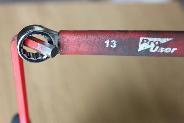

If you are broke, then until you can save up a hack for you, hold the allen key from the short side and then toghten. Sure its not accurate but it will limit the force so that you don't strip the bolts. And reasonably repeatable. If you have a high recoiling rifle, i would suggest a torque wrench 100%.

Re: Do you use torque your scopes to spec, if so what wrench
Post by on_one_wheel » 30 Aug 2020, 7:50 pm
images (1).jpeg (18.92 KiB) Viewed 11194 times
Post by eddievic » 30 Aug 2020, 8:34 pm
That's a pro torque wrench OOW. lol

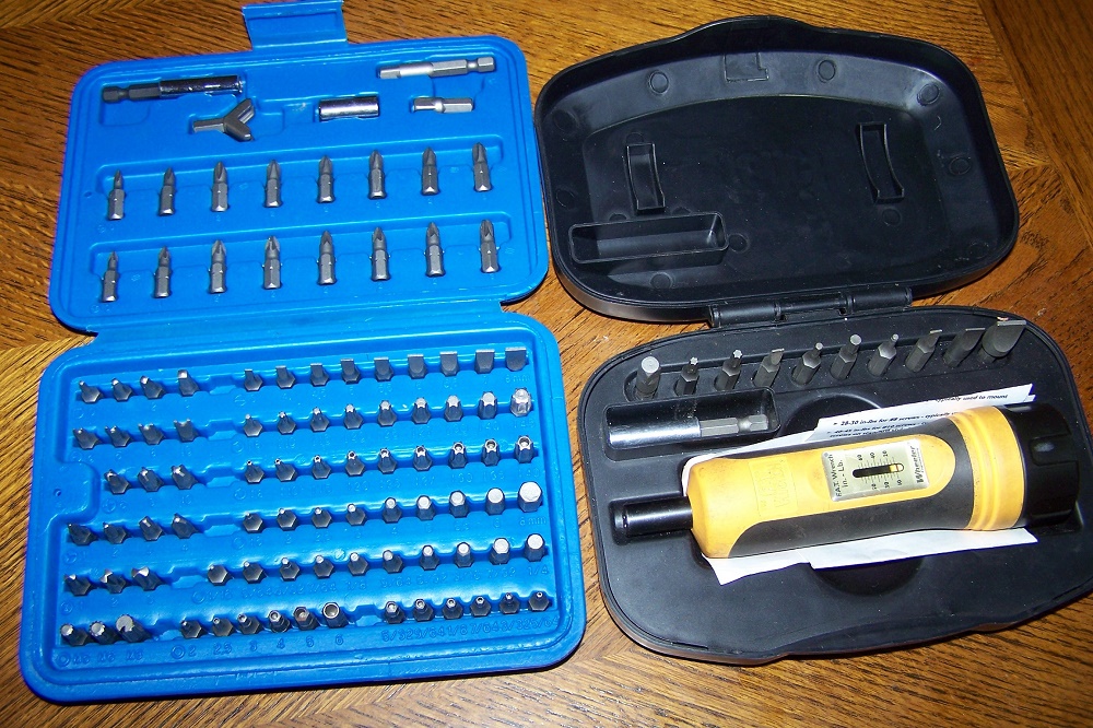

The FAT wrench comes with a basic set of bits to choose from,,, but, when they are lacking I go to my special set of bits
It hasn't ever let me down,, in variety and in all manner of sizs

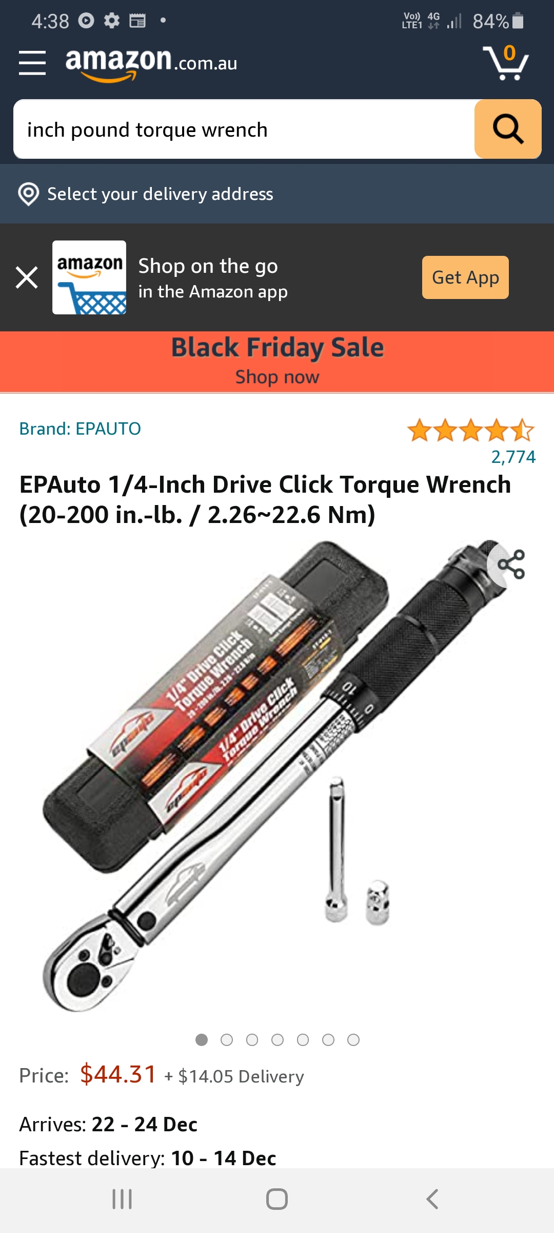

Will this do the job? Might be USD.
