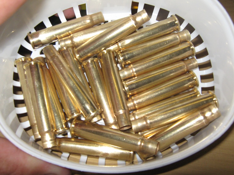

Post by Noisydad » 11 Jan 2014, 1:18 pm
After reading a fair bit about Ultrasonic case cleaning I thought it time to have a go. The machine is a small $30 job from Aldi. The solution is fairly warm water, a few drops of dishwashing liquid and good pinch of citric acid.
Fresh cleaning solution.
100_1725 (192x256).jpg (87.65 KiB) Viewed 15449 times
4 x 40-65 shells on right are after cleaning and wiped dry (inside and out).
100_1728 (256x192).jpg (94.34 KiB) Viewed 15449 times
4 x 30-06 shells on the right are after cleaning and wiped dry.
100_1727 (256x192).jpg (96.83 KiB) Viewed 15449 times
Dirty solution after 2 batches.
100_1729 (256x192).jpg (108.54 KiB) Viewed 15449 times

If you use "fairly warm" water, they dry very fast. I also wrapped a small piece of rag around a pencil to dry the inside of the 40-65 shells. That removed some more crud and left the shells very clean inside. It works very well on the black powder shells as the BP residue is water soluble anyway.

Ran it for 2 x 3 minute cycles. I got a better result on the 40-65 shells than the 30-06 ones because they were dirty with BP residue which is water soluble but even so I think it worth while. The pics don't do justice to how clean they are.

I have the Hornady sonic cleaner one of the best purchase that I have ever made the tumbler never comes out of the cupboard for some reason the instruction's said don't use warm water it causes tarnishing.
I use distilled water and about 30ml of the cleaning solution on a 30 min cycle and they come out spotless inside and out drying is not an issue here in Perth 3 min in the sun on a towel and they are good to load.

I have one and holds about 25 30-06 cases. Two minutes and done.
Water
Dolop of Vinegar
Dish washing liquid
Dash of salt if you like.
Two or three minutes and done.

I have a Lyman ultra sonic cleaner that I picked up second hand, it works well with the Lyman case cleaning solution and has the brass shining like new after about 20 minutes. Oddly the timer only goes up to 480 seconds so it takes several runs to get the job done.
The downside of ultra sonic is that after drying the brass tarnishes fairly quickly as oxygen gets to it and it goes dull within days and ever darker shades after that, any oil or wax protective coatings applied by manufacturers to make the brass shine when you open a new box are removed by the cleaning and I'm yet to find a cleaning solution that avoids that.
One big advantage of dry tumbling is that some dry wax or polish can be added so the brass comes out shiny and stays that way.

I use ultrasonic, a bit of car wash and wax, some vinegar and citric acid (seems like i need both to get enough acidity to clean) the brass comes out clean, shiny and doesn't really loose their shine. Not as shiny as wet pin method

I run mine on an 8 min cycle and they come out clean as a whistle. If I have the Lyman solution I use that, otherwise two parts water, one part vinegar and a squirt of dishwashing liquid works a treat. As for drying, Just turn upside down and leave for a day, as for the tarnish issue, if it is a concern then run them through the tumbler with a bit of polish or chuck in a bit of metho then let dry.

My regime is 30 mins in the cleaner with distilled water and solution, rinse under the tap and then 15 minutes at 120 degrees on an oven tray. They do end up with spot tarnishing but I'm not too bothered with looks and they get annealed anyway.
