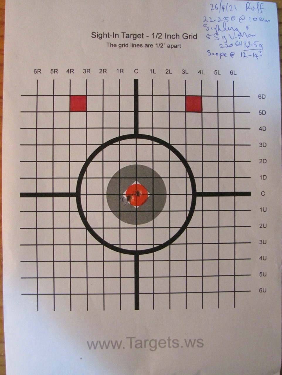

Progress update:
At it again and this is the result:
Sighting check and fouling 2 rounds (grid is 17mm x 17mm appro 3/4") :
Sighting fouling shots.jpg (279.39 KiB) Viewed 6156 times

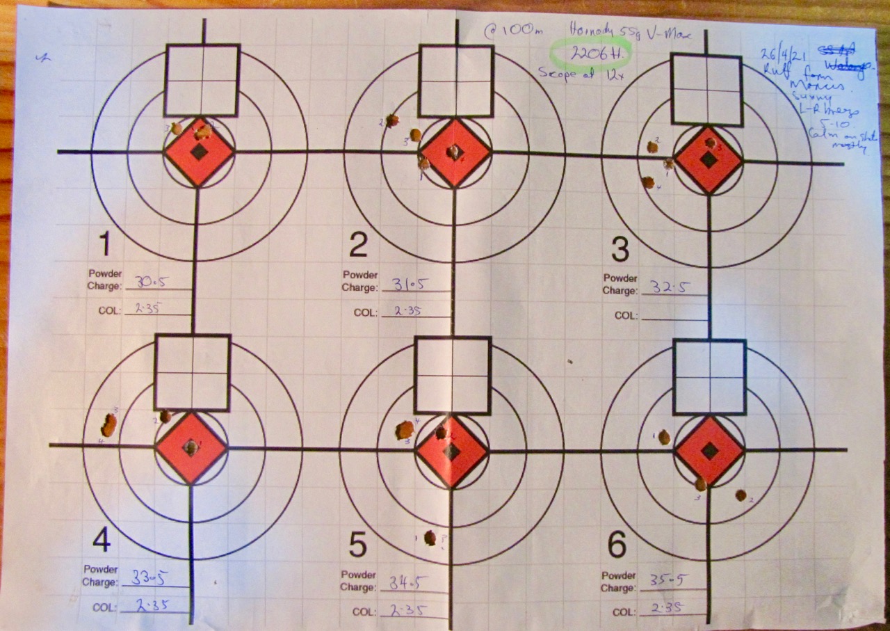

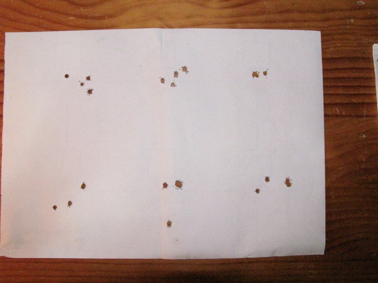

So I was pretty happy with that start. Again these were the 55gr V Max with 32.5gr 2206H. So onto the main show of loads. I use this perspective to clear away the distractions of the data and just look at the shots:
22 250 reverse.jpg (256.46 KiB) Viewed 6156 times
And from the front:
So some pretty encouraging groups, esp at 30.5gr and discounting the odd one at 34.5gr, that looks promising. Some more work needed.
So Im not sure where this puts the discussion on twist rate for the 55gr pills, esp with the sighting shots group, and the 30.5 gr group. I would anticipate looking at these two, and maybe the 33.5 a little closer. I also have a load devel. batch with ADI 2208, which many have said in other threads is a 'better' powder for 22/ 250. TWT.
Thoughts on this latest set of groups welcome.

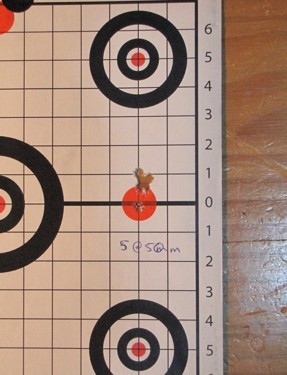

And just so you know I was shooting pretty well there is this with the 22LR @ 50 m.
22LR @ 50m.jpg (347 KiB) Viewed 6156 times
Thanks in advance for comments and thoughts.

Post by in2anity » 03 May 2021, 8:58 pm
Well it’s not you, we can rule that out, tidy group. Paul can you do us a favor, and mic your 55gr projectile? Just curious how long they measure...

As soon as I read you were using V-Max I thought that stability is your problem. I have not had good results with any Hornady ballistic tip in any caliber, never as good as a simple soft point or hollow point anyway. Even your last targets look like the holes are not round. Ditch the V-Max mate and get some 55gr soft points, choose your brand but Sierra Game Kings #1365 are a reliable choice. You have to do a whole batch from bottom to top load to see the result your looking for, just plucking one powder charge won’t prove much unless your just lucky. Good luck with it, l’m keen to watch your success.

You should have no stability problems using 55 grain Vmax in a 1:14 twist 22\250 barrel. Depending on how your brass is looking for pressure, I would push on to 36 grains of 2208 in steps, 35.7, 35.9 and 36.1. if you think stability is the issue, then every bit of speed helps. My Tikka 22\250 has shot 0.208 of an inch at 100 using Vmax and 36 grains of 2208. Not that 2206 or 8208 wouldn't give you a great result as well.
