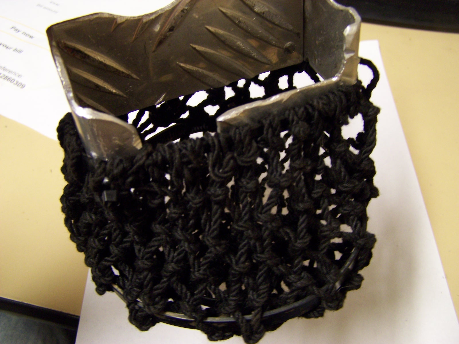

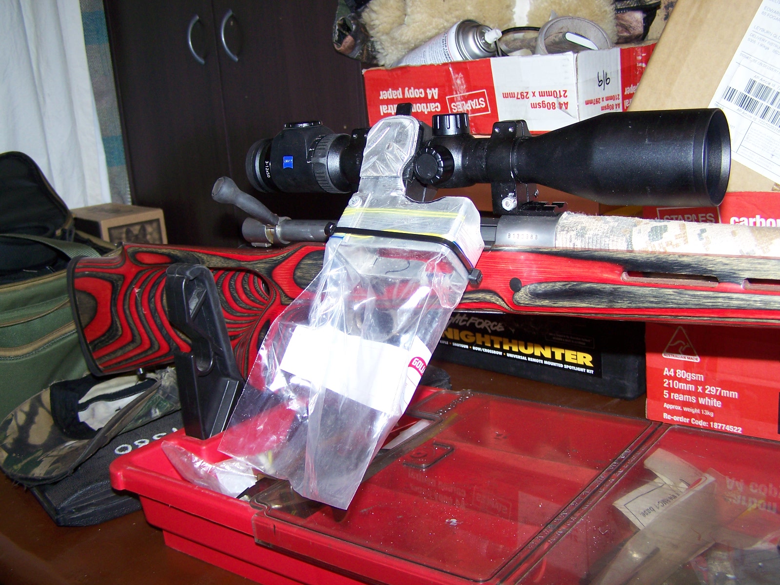

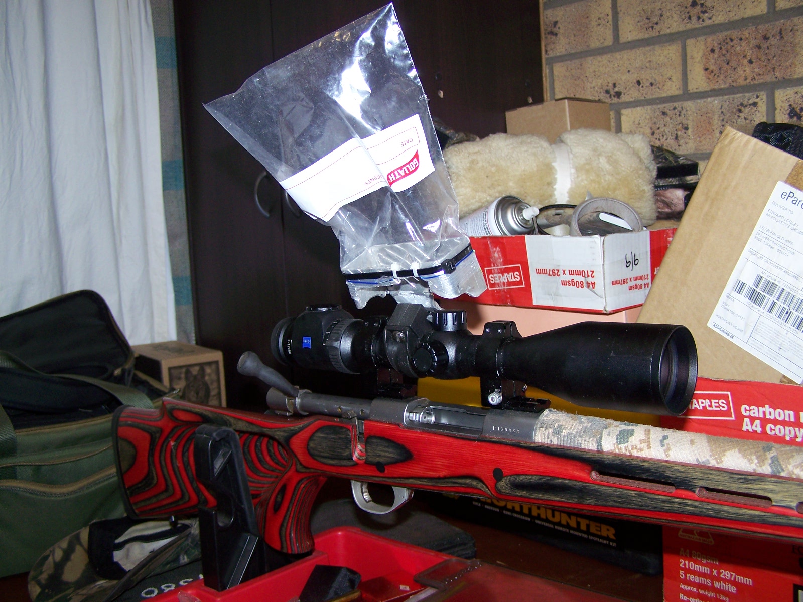

Post by Die Judicii » 09 Oct 2021, 11:38 pm
Seen one of these advertised for $145.00 on abused guns.
Took me 15 mins,,, a bit of aluminium offcut, and a cable tie to produce this as a one off.
Have ordered a pool table replacement basket to take the place of a zip lock bag.
Tried it today with both a .308 and the .22/250
Works flawlessly.

Post by Die Judicii » 10 Oct 2021, 11:25 pm
Oldbloke wrote:DJ how is it held in place?
Years ago I bought a Lightforce Night Hunter outfit.
It has two plastic mounts (one 25mm and one 30mm) that were intended to go on the scope tube and then clip the light onto it with a quick release catch.
All I did was raid that mount and clipped my case catcher on instead of the light.
It's done up just tight enough to stay where I position it,,, but loose enough to rotate it up and out of the way to enable top loading, then
swing it down to be ready to catch cases.
And the quick release catch comes in handy to empty the bag. :thumbsup:

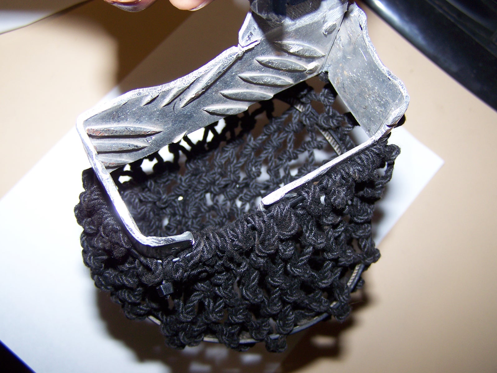

Post by Die Judicii » 12 Oct 2021, 10:07 am
Well here it is now that I got the black net to take the place of the ziplock bag.
Bloody hard to get good pics of it cos when you sit it down it just collapses and looks like a black blob.
And I couldn't get it to hang at the right angle to get a good pic either.
Ended up holding it in one hand and taking pic with the other hand.
