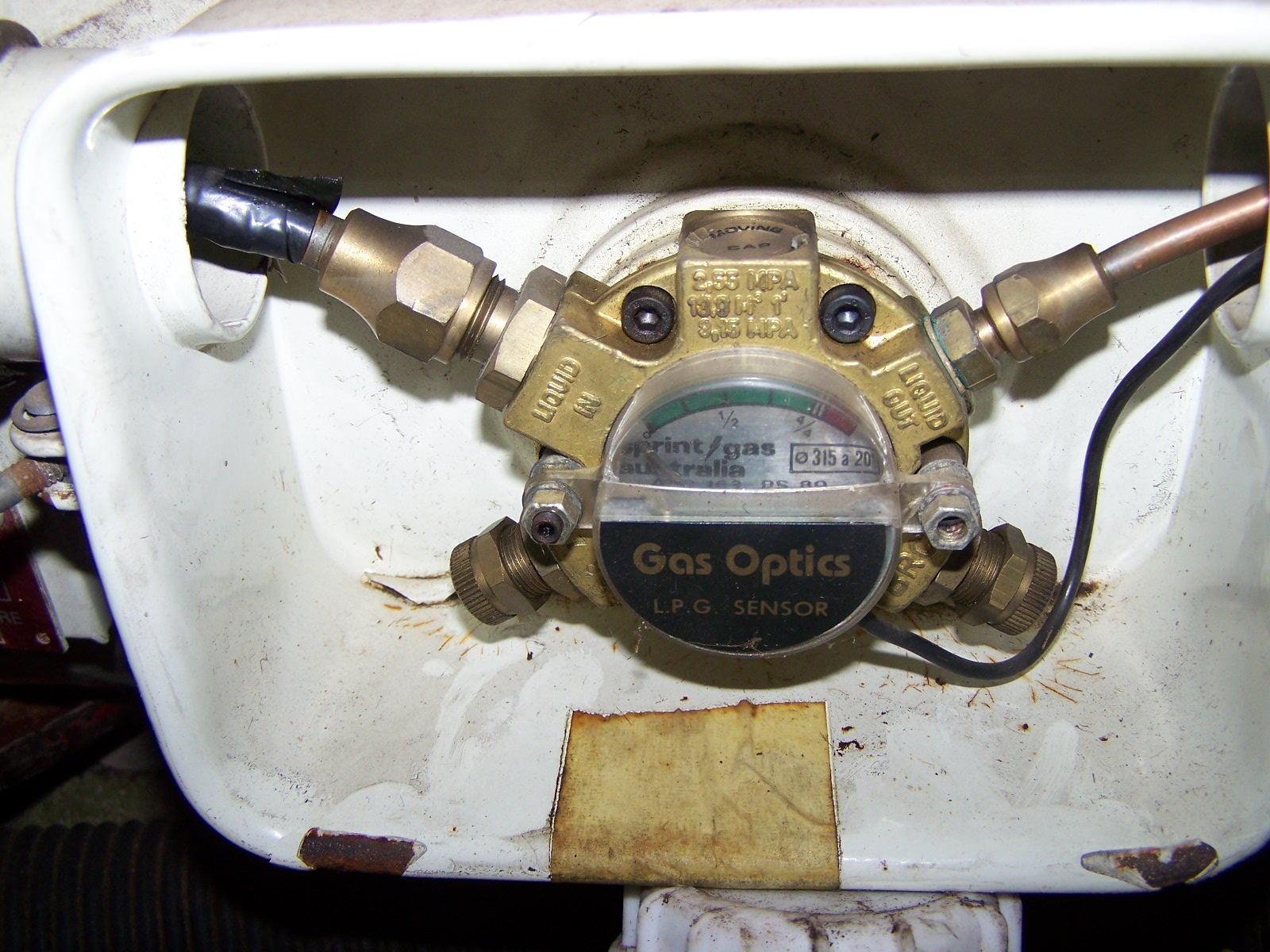

Are there any members here that have knowledge on Auto LPG tanks and shut off solenoids/valves ?
Especially early models ?
I have a vehicle (non goer) that has a tank in the boot,,, and I have no idea if it has gas in it or not.
I removed the cover from over what I thought would be a simple on/off valve,,,,,,,, but it's not what I was expecting.
Anyone that has knowledge of such,,,, I can send a pic of the unit.
I need to either safely shut the tank off,,,,,, or otherwise safely and slowly drain whatever is in the tank,,, out in the open air.

Behind the cover should be an electric shut-off solenoid, a manual shut off tap and a guage. Turning off the manual tap will isolate the tank.
BTW technically it's a no no to "work" on an LPG system without the correct licensing. A bit like A/C.
Simply turning off the tank though isn't considered repairing or modifying the system.

Mine doesn't appear to be as you describe.
PM coming

Are you going to remove the tank?
I've never seen one personally without some sort of manual shut off. Normally just screw it in to isolate the tank.

But as previously said,,, there is no manual shut off valve on the tank,, and I do want to remove the tank.

Do you have a solenoid valve somewhere under the bonnet amongst the BBQ plumbing ?

As you said, no valve. To drain the tank looks like just slowly undo one of the copper pipe fittings. Don't get a gas burn. Use leather gloves just in case.
Open area, no ignition sources within about 25 yards.
What is your intention after draining the tank mate.?

Interesting. Must be old, before the time tanks needed to be isolated. Surprised there isn't a manual valve on it though, can understand no solenoid. Though the valve doesn't look that old going by condition. Might be able to vent from the engine bay.
Gauge does show empty, assuming it still works properly, would mean there isn't much to be drained.
What are those other 2 capped outlets on the bottom side of the valve?

disco stu wrote:Interesting. Must be old, before the time tanks needed to be isolated. Surprised there isn't a manual valve on it though, can understand no solenoid. Though the valve doesn't look that old going by condition. Might be able to vent from the engine bay.
I've got no F'ing idea Mate.

I reckon as advised above, crack one of those compression fittings and bleed off slowly.
I understand that you appreciate the potential hazards but will recall a story I read in a local newspaper many years back.
A couple of dropkick renters in outer Melb decided to bleed off a tank, did it in no wind next to the house, pilot flame from domestic gas heater lit her up and dropped the house off it's stumps onto the ground.
