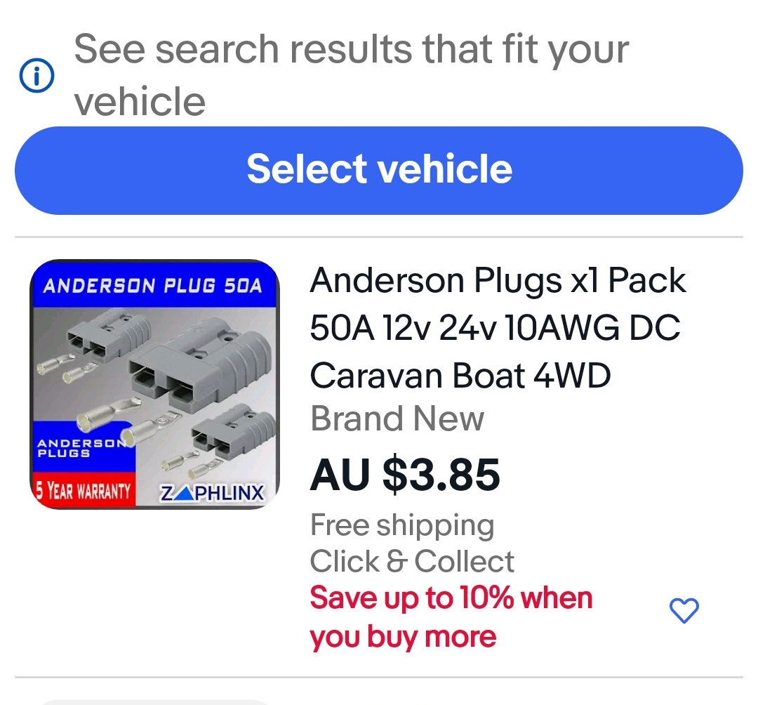

Post by Oldbloke » 26 Jan 2022, 10:09 pm
Ebay
In OZ so u will have it in a few days
