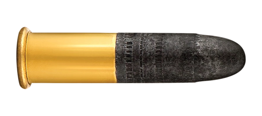

Post by MeccaOz » 29 Jun 2014, 4:49 pm
Hey folks, anyone tried the 60gn Aguila .22LR ammo ? Or even seen it in Australia ? I wouldnt mind giving it a go, I'm assuming it would have to be subsonic, so it might work a little better around livestock.
EDIT: Come to think of it, what is the chance it would stabilise in a 1:16 twist anyways ???

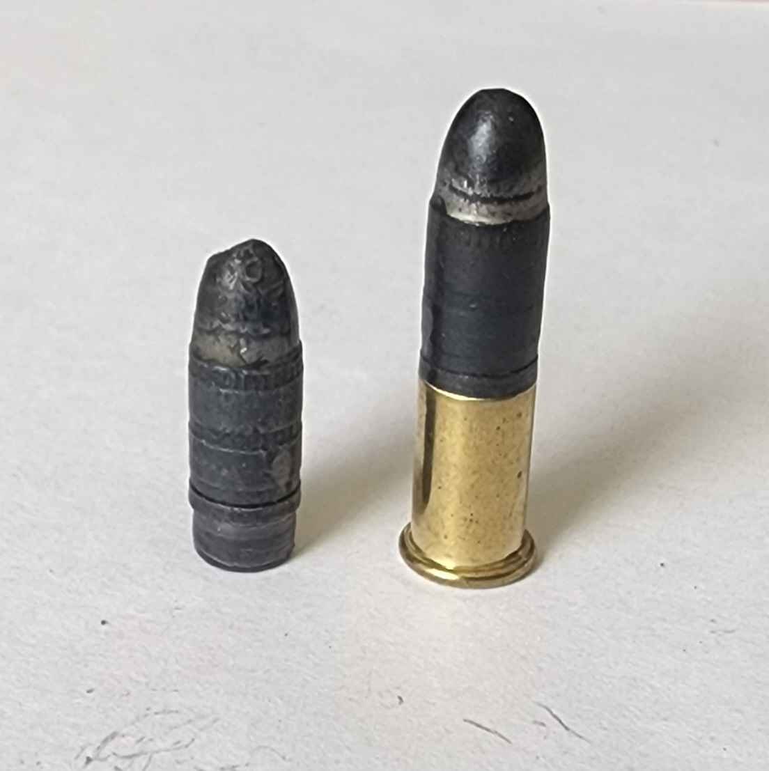

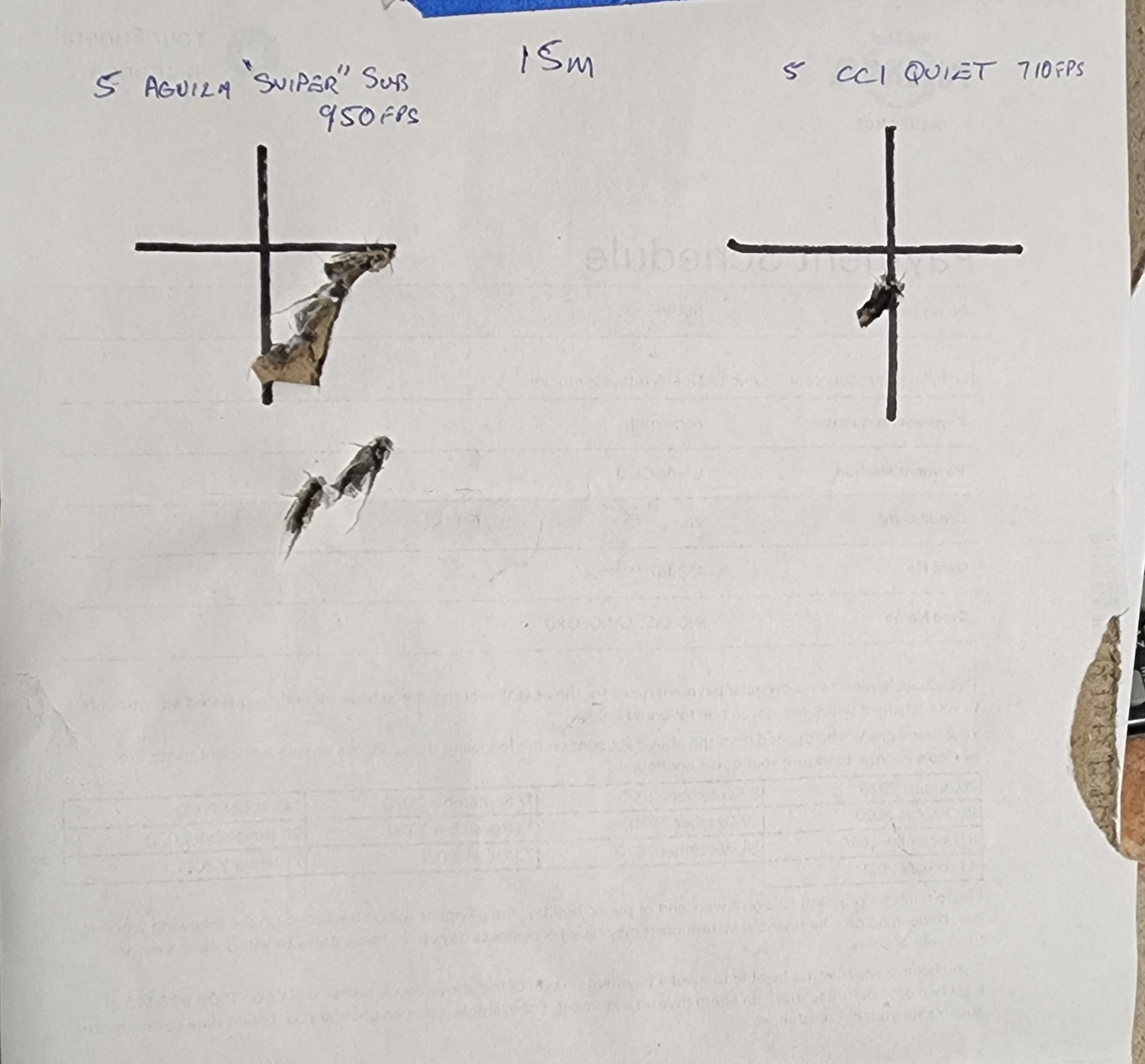

Post by Lazarus » 28 Jun 2022, 5:40 pm
I know this is an old thread but I recently tried these out of curiosity and thought I would test them out.
I have no idea where they went at 50m but I heard one moan away into the next paddock so I moved the target right in to 15m and fired 5 CCI Quite for comparison.
As with others above I suspected twist as the culprit so I did some googling and apparently they were developed for a 7 twist.
Then I found the video below of someone testing them in a norinco which I think is 14 3/4 twist and he didn't have the tumble I got from the La101 so I have no idea.
https://youtu.be/ybIU-2Pidr8

Try cutting the nose off the bullet just ahead of the driving band, might shorten them enough to stabilise.

Post by solarpak » 05 Jul 2022, 9:44 pm
Yup - need a faster twist in your .22LR - of the 60 grain slug will "key-hole" through the target.
I tested these through my Weihrauch HW66 - and it couldn't stabilise them.
Tried then through a friends Norinco JW-15 with a 14 twist and shot them a doddle - 5-shot groups at 50 m of around 30mm.
