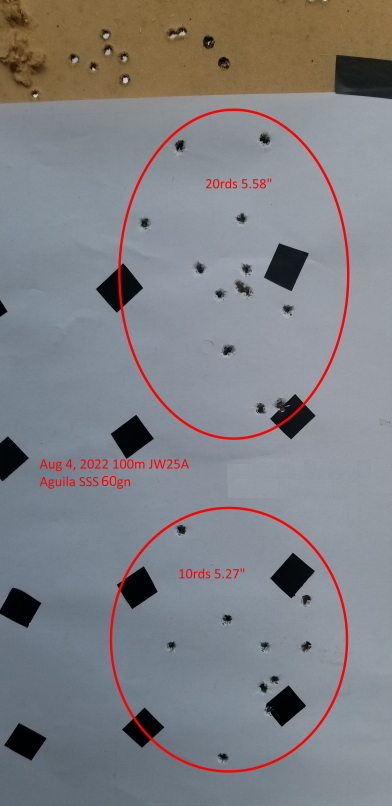

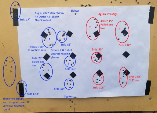

Post by bladeracer » 04 Aug 2022, 3:38 pm
I finally managed to find an hour to test this ammo. No wind, but very overcast with light drizzle so I didn't bother to confirm velocity with the chronograph. I put an AR Optics 4.5-18x40 on the JW25A the other day so I started by zeroing it at 50m with Eley Standard.
My rough boresight was 200mm low, so I made an adjustment then fired (aiming at the bottom corners of the diamonds) ten rounds to settle in at 1.9", then a 5rd group but pulled one badly - the four that were on target made .78". Then a .85", .93", .90", and 1.70". The final two groups both dropped a very low-powered round about 3" low. Two early groups I experimented with wearing my reading glasses, very uncomfortable so I gave that up :-)
Fifty rounds down the tube and I was ready to try the 60gn stuff. I didn't expect it to drop as low as CCI Quiet does, but I was surprised that they only dropped a little over two-inches. The group was also looking excellent, until I dropped the fifth round a little low, making a 1.68" group, but less than a quarter-inch wide. Group two was looking good as well until I dropped another one low, making it 2.15", although the four good ones were right on an inch. Then a 2", .90" and 1.05" group. It certainly shows some promise and is worth testing more rigorously I think. My zero was about one-inch low at 50m as I was aiming at the tops of the diamonds.
Then I moved to 100m. I built a standing bench last year so I could see over the grass but the cows got into it a few weeks ago and kicked out all the bracing. It wobbles like crazy now, oh well. After shooting the 100m groups I leaned a couple of large branches against it to try to stabilise it a bit. I estimated there'd be about 13-minutes drop but it was actually about eleven. A light breeze from three-o'clock also drifted the groups a couple inches to the left, but a 10rd group of 5.27" followed by a 16rd group of 5.58" weren't awful in the circumstances.

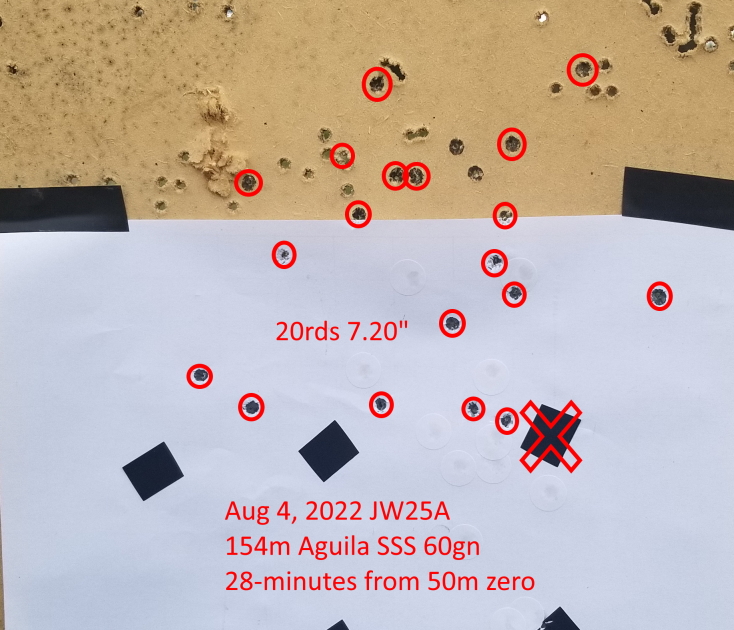

I patched the holes and moved the target out to 154m (leaned it against a handy star picket), wound in another 10-minutes elevation and fired a 5rd group, keeping to the right for the breeze. There was grass in the way of the right side of the target but I could mostly make out where the top aiming mark was. Between the grass and the poor light I couldn't make out any bullet holes, but I could hear the bullets hitting the MDF and then the steel trap at 200m behind the target, so I knew they weren't far off. I walked up for a look and found them on the A3 paper, about four-inches left and six-inches low, in a 6.65" group.
I dialled it up to 28-minutes and fired another twenty-rounds to get a decent idea of the drop to work out the BC. I walked up again and was pleased to find a fairly neat 7.20" group, but three inches high. Total 150m drop is about 24MoA from a 50m zero, making the BC around .135.

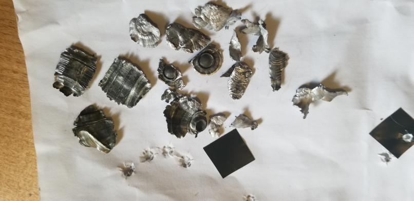

The wind and rain were increasing at this point. I put four rounds onto a plow disc at 204m holding on top of the duplex post, for a total of 43.4MoA. Wasn't really expecting to get hits but figured I might recover a bullet from the dirt bank if I missed. I should've calculated the trajectory as this was far too high and they all went over the top. I did recover some from the steel trap though, and they make hefty chunks of shrapnel. The biggest ones are 52-55gn each.
Overall, not bad. No tumbling even at range as all the holes are circular. I wanted to try them in the Ruger as well just to confirm that they won't stabilise in it but couldn't be bothered going back out in the rain and wind, I'll do it sometime soon though.
