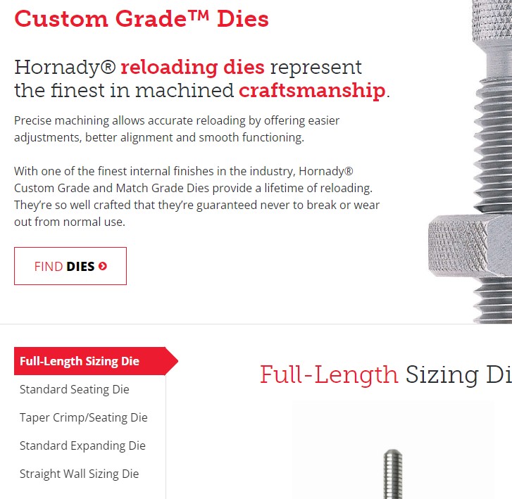

I can't find anything about a Hornady neck sizing die. The Custom die set should be a full-length die. I can't find any reference to "New Dimension" except in Amazon ads for the die set. They do custom make neck-sizing dies but I can't find any instructions for those.
Screenshot 2022-10-21 182335.jpg (105.59 KiB) Viewed 7293 times
If you are using a standard full-length die then neck sizing is done by adjusting the die so only the neck is sized. You can do this simply by putting the case up into the die, extracting it, seeing how much of the neck has been sized, adjusting the die down further, and doing this until the required length of the neck is sized to hold the bullet. You will need to lube the case each time to avoid getting it stuck in the die.
