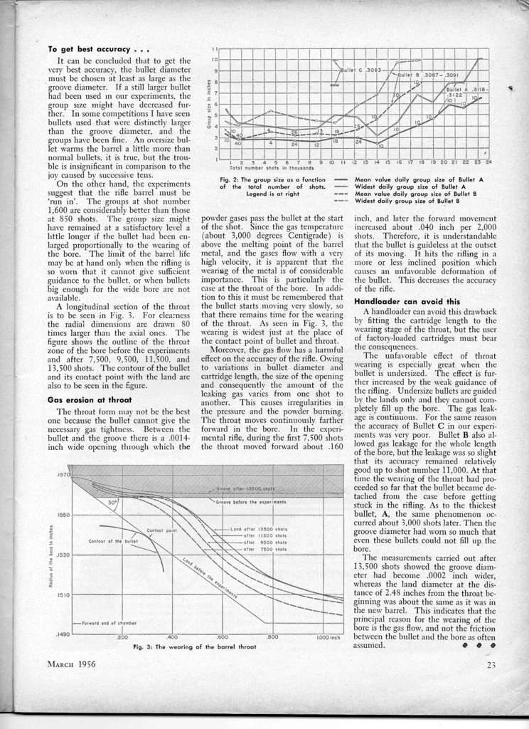

Has some interesting information. Don't suppose you have the Figure 3 of the sectioned throat?

bladeracer wrote:Has some interesting information. Don't suppose you have the Figure 3 of the sectioned throat?
You should try looking at the bottom of the second page where fig. 3 resides.
Bugger, I was expecting to see the throat actually sectioned :-)

Vince24 wrote:I was wondering if there are people reloading the M39 with D166 around here and what the experience is. Got some D166 with the rifle, have to try the authentic Finnish experience!
I will also try some 308 projectiles (ELD 178) out of curiosity!
I understand from the above study that as long as the bore is too wornout, the smaller diameter projectiles will shoot fine - they had to go above 10,000 rounds for the larger diameter projectiles to really make a difference in accuracy.
I suspect that you didn't read the graph correctly.
