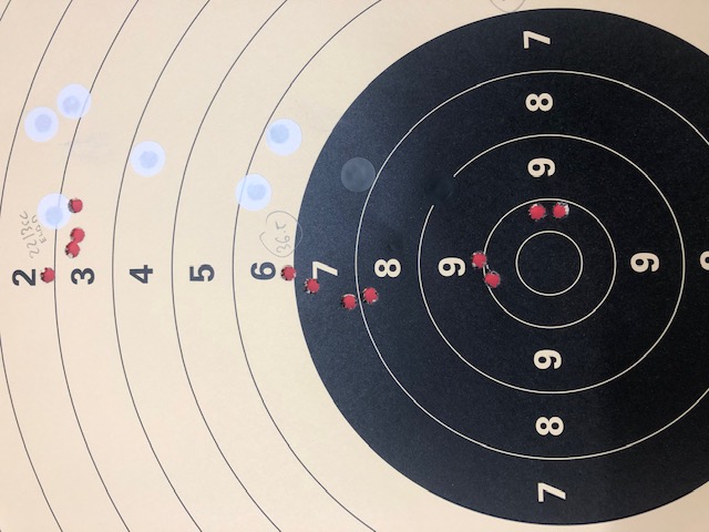

Nice 3 shot group Bigrich - I assume 100m?
46.5gn of 2209 behind a 140gr pill, probably fine in a Tikka, but I would not dare in my Swedes!
That must be in the 60,000psi! or more!
Not that the Swedes need that much, see a 4 shot group in my scoped 1899 Swede, that's only 43gr
LD Hdy 140 HPBT 2209 43gn.jpg (610.99 KiB) Viewed 4572 times
and then a 10 shot group with 42gr - with some scope adjustments after the first few shots.
10s Hdy 140hpbt 2209 42gn.jpg (585.45 KiB) Viewed 4572 times

That’s some nice shooting from your old Swede. Accuracy wise, milder loads would probably work very well in my tikka. The primers in fired rounds look the same as my 30-06 shooting near the max end of adi load data. Cases extract easy as well as the bolt operation. The Swede loaded to it’s full potential is a fairly flat shooting “do all” round for Australia. Projectile performance is brought to its full potential with decent speed. I’ve loaded for the Swede before, so I know what it’s capable off. I saw a fella shooting a early 1900’s gustaf at my local range years ago who was loading 47gn of 2209 in that rifle with bullets seated way out . As blade said, seating out decreases pressure and gives more case capacity.
My 9.3x62 has extremely generous free bore just like the Swede, and I have worked up loads accordingly. Buffaloes and other large critters in the north don’t like it much :D

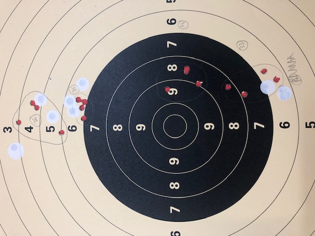

Post by Vince24 » 18 Dec 2022, 3:22 pm
So just as a feedback I have done this very quick load development in 2208 with the Speer HotCor for a cheap combo to shoot at the club ($0.70 a shot).
Load tested: 33-34-35-36-36.5
Pictures below, groups of 4.
50m, open sights.
The top group on the second picture is a test group, with the luxury package: ELD-M with 46 grains of 2213SC.
LD Speer HC 140.jpg (77.61 KiB) Viewed 4357 times
LD Speer HC 140+ ELD M.jpg (76.49 KiB) Viewed 4357 times
Conclusion:
33 and 34 grains were terrible. The necks of the cases were all black with powder residues. Seriously underpowered I would say.
35 grains was perfect: 3 impacts touching each other, the 4th one not far.
36 and 36.5 grains were not bad, but with more recoil.
So yes, 2208 can work very fine on the 6.5!
Always amazed at the differences you can see from one load to another.
Sometimes I wonder if it's just variations in performance of the shooter (his eyes!), but I see the same differences from one load to another when doing a load development with a scoped rifle and front/rear rests, so the selection of the powder load clearly plays a pivotal role in the accuracy.
So I am settled on the 35 grains load, next stage is to test at 100m and then at the military shoots!
Interesting fact: you can see that the groups move consistently towards the left as the powder load increases from 33 to 36.5gn. And I haven't done any windage adjustments. Strange?!
NB: the luxury load ELD-M / 2213SC (top group in the second picture) did not do better than the Speer in that 50m test, so I will shoot the Speer at 100/200 and keep the ELD for 300m.
Vince24
