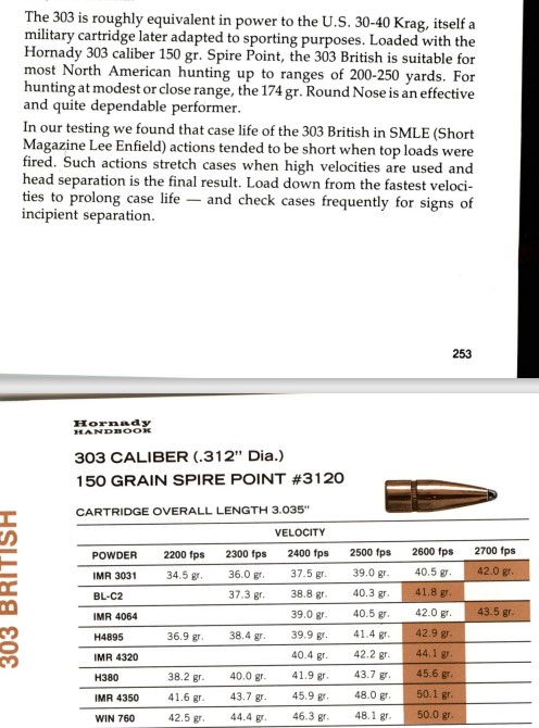

The 1985 Edition does list W760 down to 150gn bullets (42.5gn up to 50.0gn max under the 150gn bullet), they also suggest loading short of these levels to increase brass life.
- Screenshot 2022-11-16 204751.jpg (92.65 KiB) Viewed 5645 times
