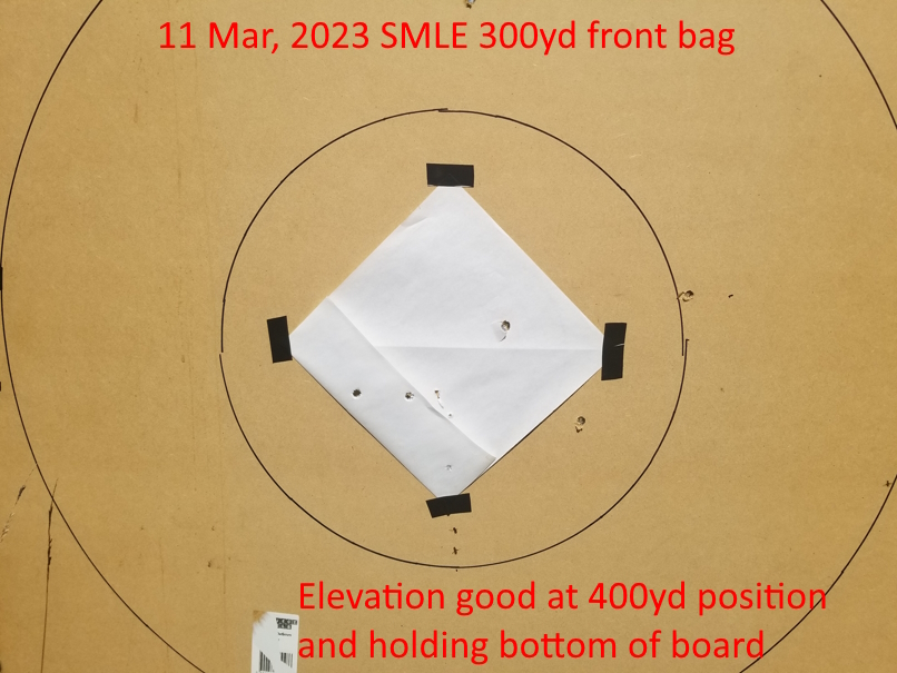

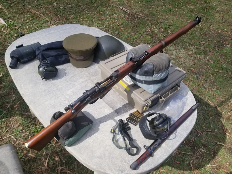

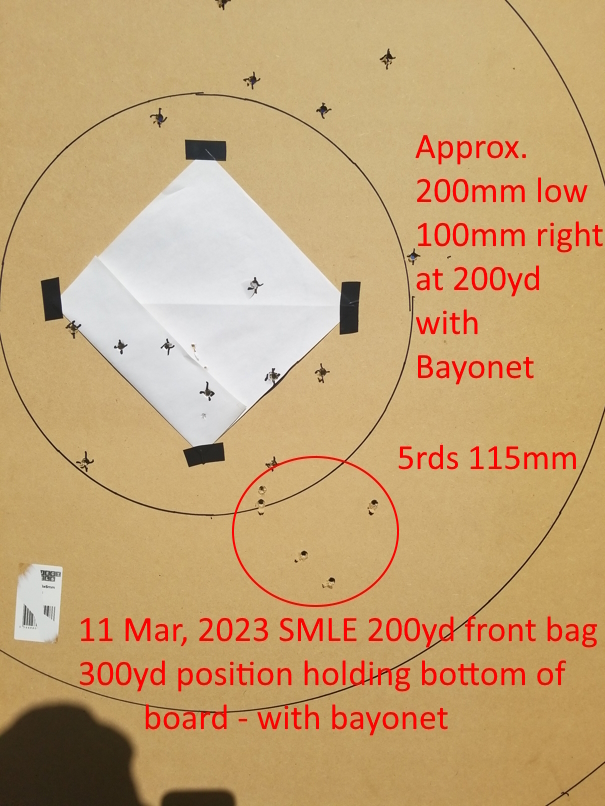

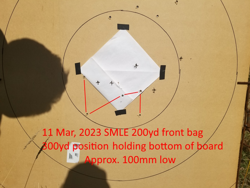

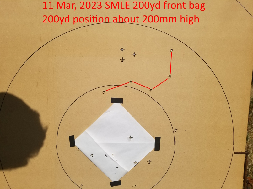

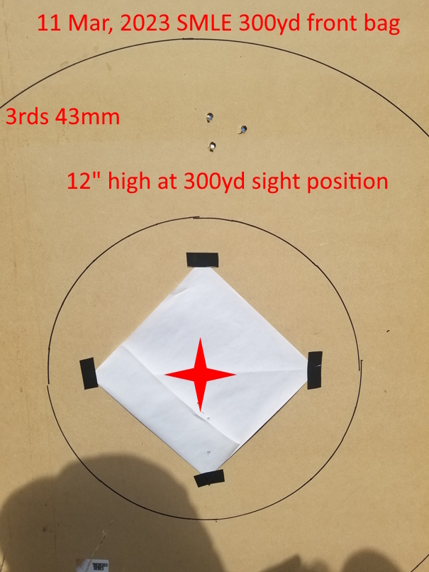

Post by bladeracer » 12 Mar 2023, 12:19 am
For different reasons I haven't managed to get any .303 shooting in since I got back from Rankins Springs, though I have been doing a lot of .22LR practice. But I finally managed it today. I mainly wanted to confirm my 200yd and 300yd sight settings as the ANZAC shoot is at these ranges.
I made a 900x1200mm tall target with scoring rings and put a paper diamond in the centre to give me a more precise aiming point. I started at 300yd by setting the sight to 300yd and holding on the centre of the target. The 3rd group was right around 300mm high, and 43mm across. If I do decide to aim at the target centre I'll have to set the sight to 200yd - I'll have to confirm this next time.
I also want to determine the sight position for when I hold on the bottom edge of the 1200mm-tall target board, so I needed to add 4MoA to put my shots 600mm higher than point of aim. The step from 300yd to 400yd on the sight should be 2.7MoA, and 450yd should be about 5MoA, so I came up to 400yd to see where they'd drop. Elevation wise seems good, though I spread the windage a bit. I didn't have a definite bottom edge due to the grass but I think this will do me.
Then I brought the target back to 200yd. At the 200yd position holding centrally they fall about 200mm high.
I needed to add about 8MoA to hold on the bottom edge of the target and drop the bullets 600mm above point of aim, so I came up to 300yd which is 5MoA to see where they'd fall. They're about 100mm low so I'll have to try the 350yd position as well next time, that should add about 1.5MoA.
Then I fixed the bayonet to see where the bullets fall with that dangling off the end of the barrel and shot a neat 115mm group, about 200mm low and 100mm right. Pretty happy with that I think.
Then I put some rounds on the 500yd target. Holding about one-quarter up from the bottom of the 1200mm square puts my shots about the centre. I need to do a lot more practice at this distance but I don't need this for ANZAC.
I also discovered something about my eye issue. I've been wearing a WW2 Field Cap for a few weeks and while I was sighting the rifle in strong sunlight I noticed that if I tilt my head down so the hat's brim just about touches the top of my sight picture, the front sight suddenly becomes visible, much like using the Eyepal on my goggles, very interesting. This is not at all consistent and quite difficult to get right but it may be something else I can play with. So far it doesn't look like I could use it in rapid fire.
