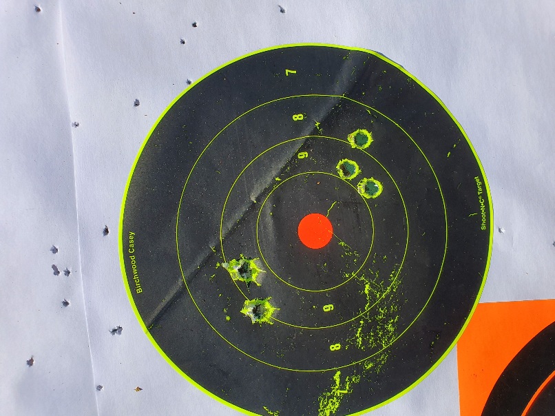

Post by animalpest » 30 Apr 2023, 8:02 pm
The 40gr bullet from the .22mag will hold up well at that speed. Many, many shooters used them in .22 Hornets and they worked well (including for me).
It really isn't unusual for different bullets and different loads to shoot to a different point of impact and it can be quite marked. Hence we always resight rifles when any ammo components change.

Post by animalpest » 30 Apr 2023, 8:07 pm
Two different loads, same rifle

Post by animalpest » 30 Apr 2023, 9:11 pm
Yep, it's normal. Contrary to what people will tell you, it is common. Some rifles and calibres are less prone to it but don't stress.
The target I posted was with a 375 H&H, which everyone tells you will shoot different bullet weights very close. Yeah..no

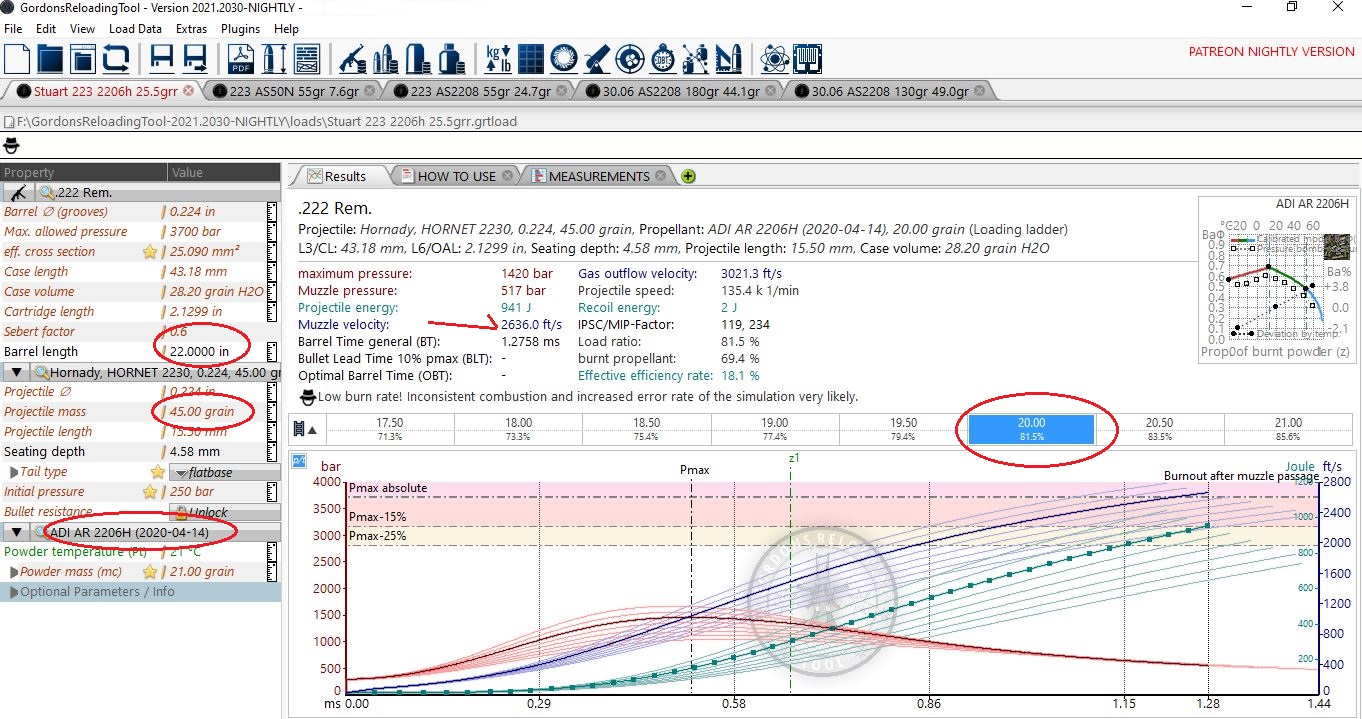

Post by Oldbloke » 04 May 2023, 9:14 pm
So,, I just ran the data through GRT. GRT agrees with you 2636fps for a 45gr bullet. GMF. Should all work fine. That's if I got it right
222 45gr.JPG (354.5 KiB) Viewed 8316 times
