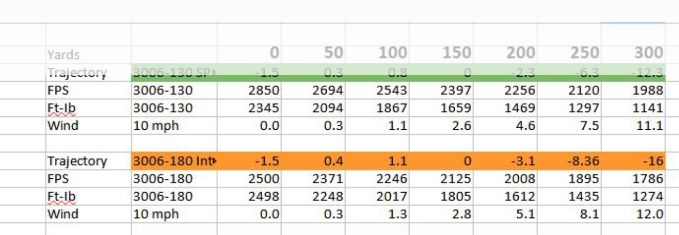

You want to hunt, bigger stuff i suspect having a 30.06 so the target, lung, heart area is fairy large and 1 or 2 inches wont matter.
See one of my cheat sheets attached. The distances are yards and inches. Look ar the orange line. 30.06, 180gr Half inch high at 50 yards. Its close enough to get you stsrted.
When you can check at 100yds and tweek if required to 1" high at 100yds
And welcome to the forum.
P.S. If your shooting factory your trajectory should be slightly flatter, so say abt 2.5" low at 200yrds.
