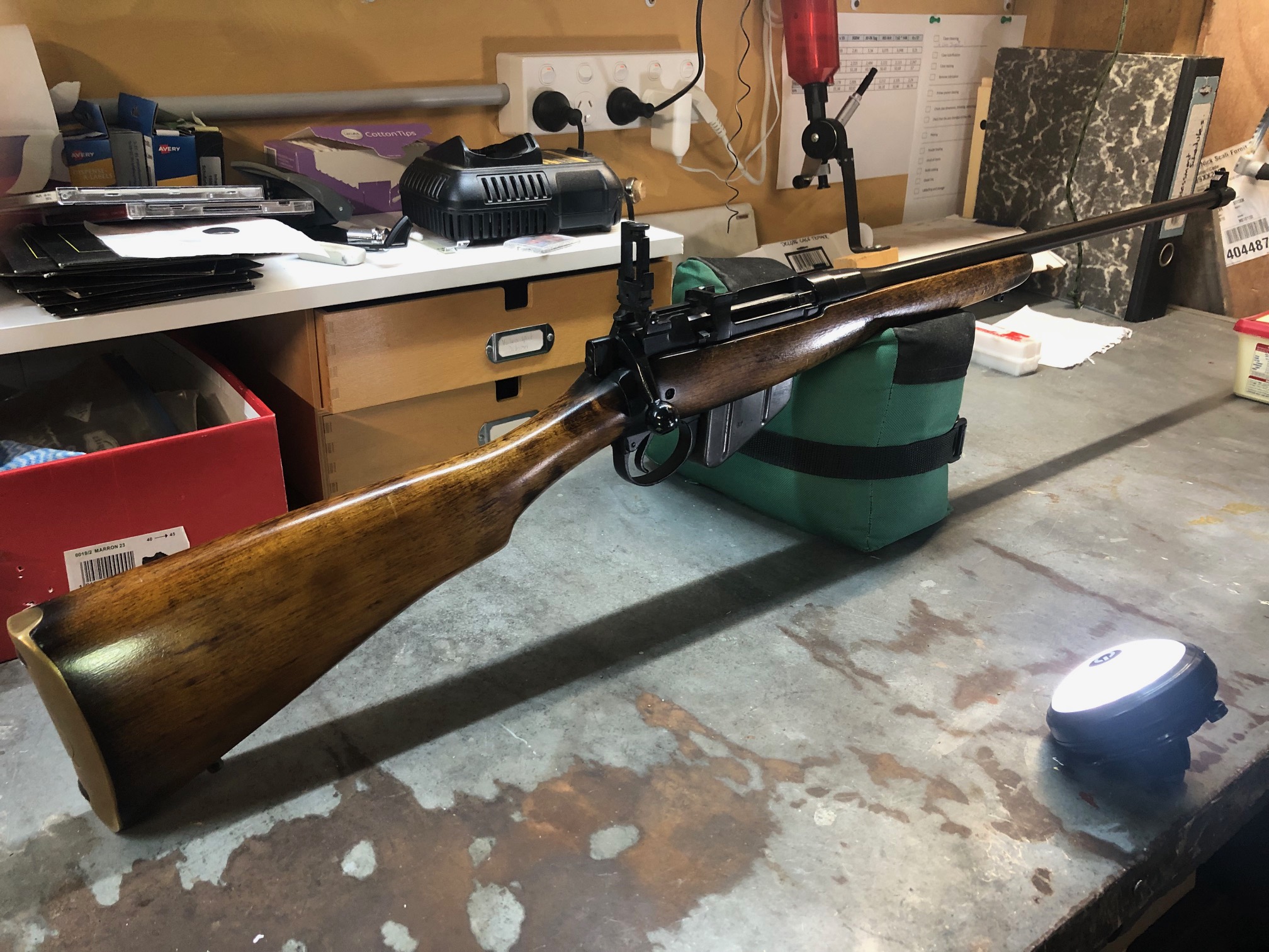

Looking to do a load development for a little No4 Sporter in 303 British, using the Sierra #2300, Pro Hunder 150 grains,
Will be using AR 2206H - and I'll try with large pistol primers, just because I am curious ;)
Now my question is, how much 2206H can I send down this case?
- ADI load data says no more than 40 grains
- Hogdon (for the equivalent H4895) says no more than 40 grains
- NIck Harvey says no more than 42 grains
- GRT says I am an oversensitive c*** if I don't load it up to 45 grains.
So I was thinking of trying loads from 37 to 39.5 grains but before that I wanted to check if some of you have experience with that specific Sierra bullet in a 303 rifle load development?

It's a very elegant No4 Sporter, a Parker Hale commercial conversion, light like a 22 LR (my reason for not going for a 174gn/2208 load), cute stock with a good barrel and the singer sight.

Can't see how anything built on a Lee Enfield action could be considered " light as a 22 " unless the only 22 you've used is some sort of bench rest jobby....
Posts: 4190
Re: Sierra Pro Hunter - who should I believe?
Post by Vince24 » 16 Dec 2023, 6:53 pm
Well that sporter weights 3.4 kilos... so yes it is not much heavier than many 22s !
