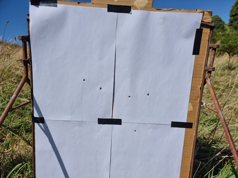

My 22 Brno can hold 1 inch at 100 meters the last time I shot it that is , from a bench using a rest and rear bag . It may need the bedding redone because it's sat in the safe unfired for years . Zeroed for 300 I could hit the 6 and 8 inch gong at 300 as long as there was no wind . Cross wind is the big killer for a 22 rimfire . Another problem is the trajectory angle coming down at 300 makes it harder to hit them than it appears . The danger space is reduced compared to a flatter shooting cartridge . Can I just bring my 223 lol.

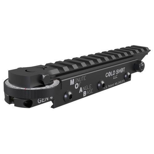

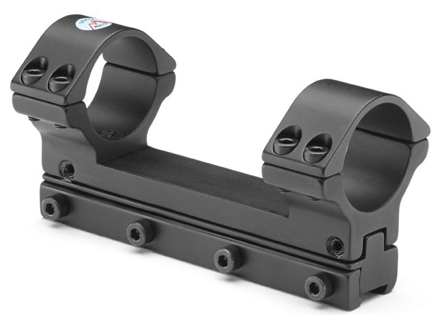

bladeracer wrote:The simplest and cheapest adjustable rail is around $100 I think. It's a two-piece rail (with or without rings). The rings attach to the top piece of the rail, which is held above the bottom piece which is fixed to the rifle. You adjust screws between the two pieces to centre the windage and zero with the turret fully down. You have to shoot a group, remove the rail, adjust the screws, reinstall, shoot another group, and so on. It does take time but once you have it set up you shouldn't need to touch it again ever. You should be able to do it in less than ten tries, even less than five sometimes. If you have a lathe you could use over-size rings, say 35mm or 40mm and machine offset inserts to add cant to the scope, but I think this would be even more painful to zero. Or you can buy a fully adjustable rail with click adjustable windage and elevation, but these are in the realm of $700 to over $1000. In between those you can use the adjustable rails that are marketed toward setting up digital scopes for around $200. This is what I'm using currently, once you're zeroed you don't need to touch them again, but you can zero these with just two or three groups much like zeroing any scope conventionally, shoot a group, mark the mean centre, dial the mount to move the reticle onto the mean centre, fire another group to confirm.
An example of the cheapest version (this one is for a dovetail) - https://www.eliteoptical.co.uk/sportsmatch-30mm-rifle-scope-rings-for-weaver-picatinny-bases.html
The two side screws at the front are for windage adjustment, elevation adjustment is done by two vertical screws at the back (you have to dismount it to access the screws).
An example of a $1000 click-adjustable rail (I'm not sure this one has windage though) - https://www.scopedout.com.au/Cold-Shot-M.O.A.B.-MOA-Adjustment-Base-Gen-4
And the $200 style that I use - https://www.extravision.com.au/collections/pulsar-rifle-mounts/products/click-adjustable-mount-zeroing-block
And my testing of it - https://enoughgun.com/forum/viewtopic.php?f=4&t=16310

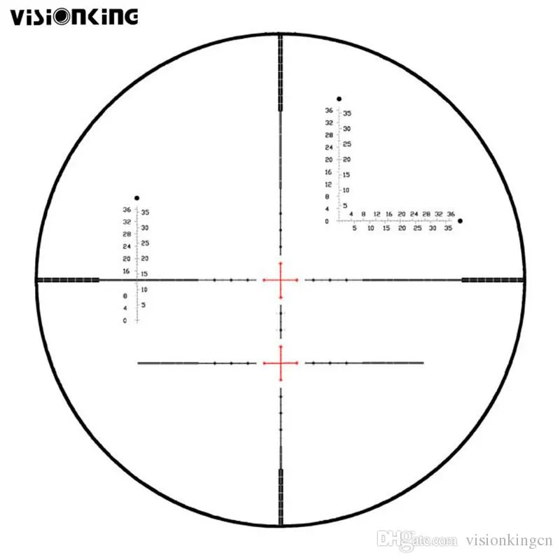

I should mention that if you have a grid reticle or one that gives you low holds as well as high holds then you can zero out further and use the reticle above the crosshair for closer shots. One of my Visionking scopes has a double reticle that can be used similarly - personally I find the reticle too busy and it can get confusing.
Visionking double reticle.jpg (93.4 KiB) Viewed 11932 times
Also, an SFP scope allows you to adjust your reticle to change your holdovers, something that FFP scopes can't do. For example, when practicing at 460m from a 180m zero, rather than dial all the way up to 82 minutes, I'll usually just wind the scope back to 4.5-power which quadruples my 15.4-minute reticle holdover to 61.6 minutes, dial in 20 minutes on the scope, and hold on the top of the duplex post (the .223 600yd holdover).

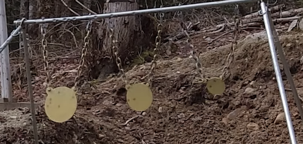

I used to stuff about shooting a gong 250ish meters with the 22lr, standard velocity rounds, didnt have a big minute picatinny rail or anything so the holdover was interesting haha..

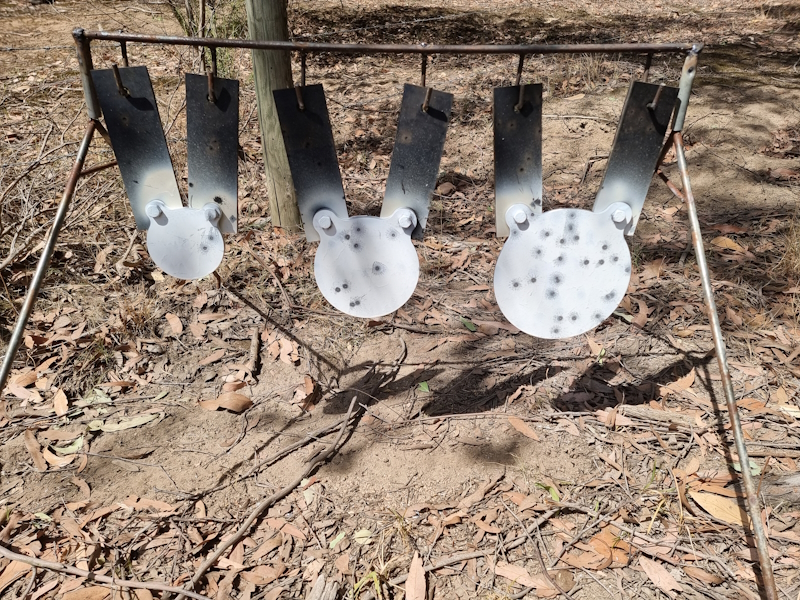

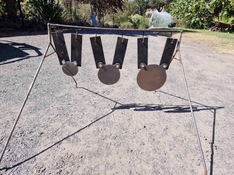

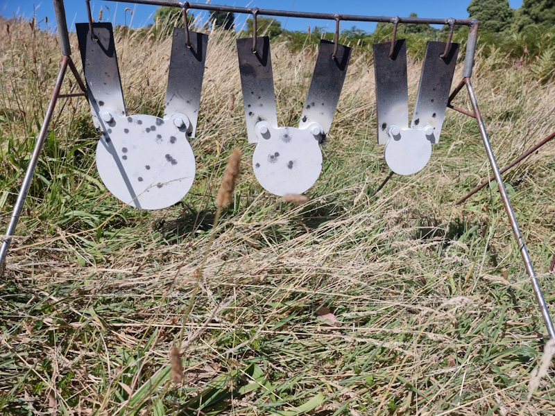

Got some gear from STS today, 4", 6" and 8" gongs for practicing the Long Gong, and a rimfire Know-Your-Limits set.
Have to weld up some hanger frames for them now.
Posts: 13993
Re: Long Gong rimfire shoot
Post by bladeracer » 01 Mar 2024, 3:11 pm
Whacked together some very cheap hanger frames for them, just 10mm round bar with 6mm round for hooks.
bladeracer wrote:Got some gear from STS today, 4", 6" and 8" gongs for practicing the Long Gong, and a rimfire Know-Your-Limits set.

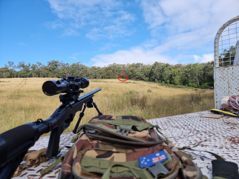

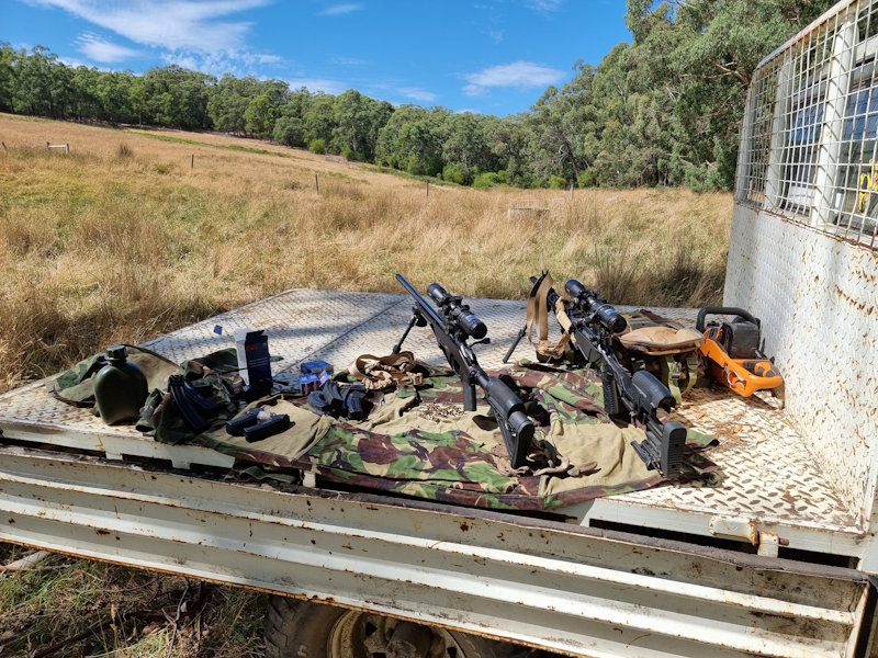

I did finally manage to get out for a bit of practice on these gongs today. First I had to clear five trees on the plantation track to get into the back of the block, which wasted a lot of my time as I wanted to get back early as Rose was taking her mum out tonight. The first fallen tree, somebody had come out, cut up the main trunk and taken the firewood, leaving all the branches still blocking the track - I really don't understand some people.
I sprayed the gongs white, walked them up to the top fence of the paddock, then ranged some spots down the bottom to see where I might shoot from. Took the ute down there, ranged back to the targets, but was 18m short, so I moved the ute to the edge of the dam and ranged the targets at 275m. But my line of sight only clears the ridge in the middle by about one metre. The mirage was horrible.
The RAR Target was already zeroed at 200m so I wound it up 18 minutes and put 70rds through it on a separate 150mm gong trying to get a feel for the wind, with no real success. The wind was swirling around bouncing from one side of the target to the other. I was also being tricked by being in a still hollow with the wind howling through the trees over my head when the wind I was actually firing through was very different, in direction and strength. I was making hits, though I couldn't hear most of them over the wind, but luck with the wind played a large role in them I feel. Then I switched to the RPR, dialled up 46 minutes (50m zero) and put 175rds on (mostly near) the 150mm and 200mm gongs. I think all I really learned from today's effort is that I need to find a better place to practice :-)
Rose just told me that she was at a neighbour's place while I was shooting. They were listening to me and were surprised I was bothering as the wind where they were was gusting heavily. I think I'll have to go to my mate's place where I practice with the .303 as he has a nice section there that runs along the lee of a ridge where the wind seems to pass over the top of the line of fire.
I did record video but I've watched it back and it's blurry beyond use, no idea why. The S21 Ultra has a bunch of cameras and apparently it automatically swaps through them depending on what you're doing. I have no idea how it works and it failed me dismally today. I thought I had video so I didn't bother going up to take photos of the targets. Out of 245rds I probably had no more than 50-odd hits on the 150mm and 200mm gongs.

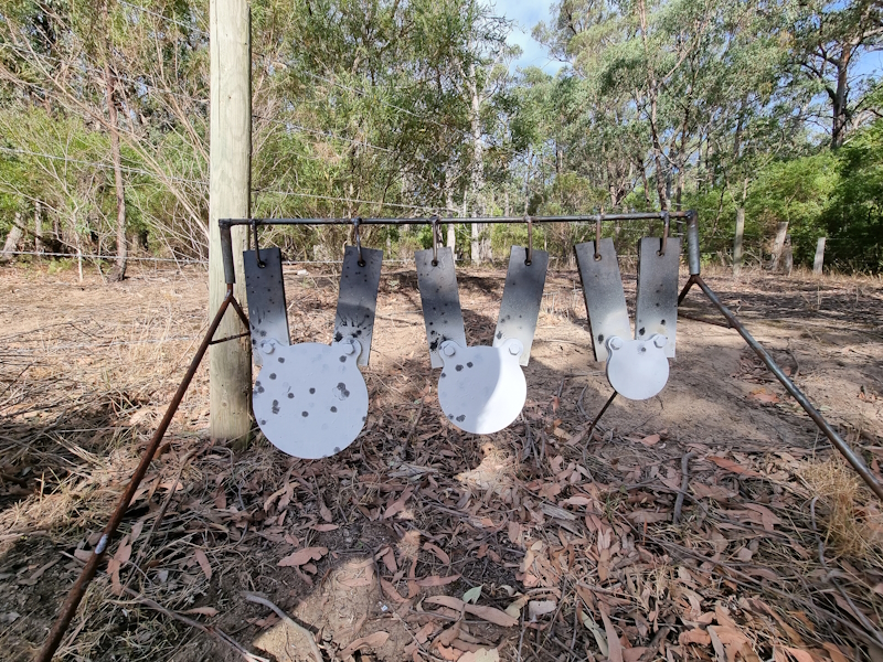

I noticed that there was no breeze at all this morning so went out for a practice. Was doing much better, until the sun came up and heated the hillside, then the mirage killed the fun :-) I started missing despite good sight pictures, but when I started seeing bullets hitting two-feet away I realised it was definitely a mirage issue.
I opened with my first shot of the day hitting the 150mm gong I'm using for warming up (I can see most of the misses hitting the dirt behind it) though the next nine were all around it with no hits. I can't help seeing the gongs as teddy bears with the "ears" for the bolts, so I'm thinking it should be called the Three Bears Shoot :-)
Do "ear" hits count if they're outside the circumference of the circle?
I put 80rds through the RAR Target and 160rds through the RPR this time. I'm just working on hitting the gongs for now so I've been doing 15rd mags dropping five on each gong and scoring them as 1pt, 2pt and 3pt. My best so far I think is only 9pts - 2, 2, 1 (I'm not writing anything down, just trying to keep track in my head). The 8" gong is not too difficult once you've got a wind read, the 6" gong is challenging as I doubt the rifles group as tight as 150mm anyway (I must remember to take a board up to get some group sizes), the 4" gong is a real struggle. I really think a rear bag is going to be essential for that one so I've strapped one to my pack now.
I've put 485rds on these now (though a lot of those were on the separate 150mm gong while getting wind reads and zeroing) without having a bullet drift far enough to hit another gong. Until I stopped for ten minutes to reload the mags. The wind shifted three minutes during that time and my first shot on the 8" gong hit the 6" gong instead. So I think I'll have to open up the spacing a bit just to be sure.
I don't know how many shots I fired at each target with each rifle yesterday (or today for that matter) but I counted yesterday's hits before I painted them this morning - 22, 7, and 1 on the 8"/6"/4" gongs, another 7 on the separate 150mm gong, and one on one of the 120mm gongs. Today's effort was 28, 9 and 3 (one of the "9" was aimed at the other target though so counts as a miss), I forgot to count how many were on the separate 150mm gong, and I also used a 420x240mm plate when I was checking wind. At one point I think I put eight in a row on the 8" gong, I was doing very well early on, once the ground heated up it became very frustrating.

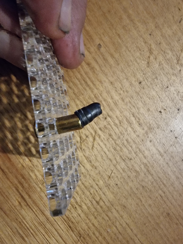

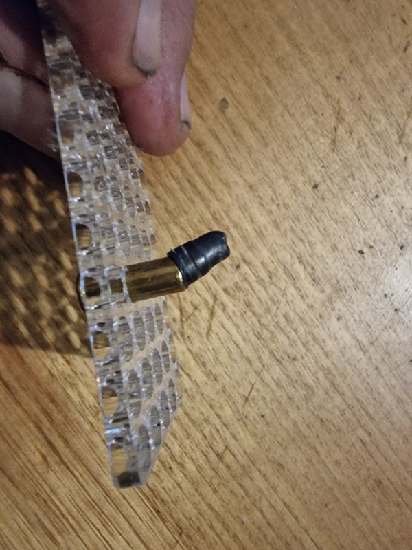

Of all the cases of CCI SV I've been through I was surprised to get a bent round yesterday while loading mags. I can't imagine how they got that in there as it was very difficult to remove and the plastic trays are very fragile. The box was undamaged.
I straightened the bullet enough to get it out, then loaded it behind four good rounds to see how it would fly. The four good ones were all close to the 150mm plate, the bad one I didn't see an impact in the field of view at all.
I'll have to keep an eye on the wind and if I see it's calm I'll dash out again.

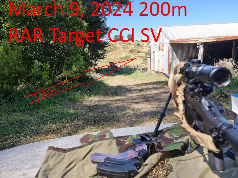

I walked the targets out to 200m, pulled out some ragwort on the way back, then dialled the scope down 18 minutes to a 200m zero. I burned most of the first mag trying to get a hit somewhere. I held on the middle gong and eventually had a ding on the left gong telling me that my elevation was on.
The wind was horrendous, swirling up the valley. Across one magazine I'd be switching from a three-minute right hold to a three-minute left hold, just hopeless. Which was a shame as (at 200m) I put three consecutive bullets on the 6" gong then jumped to the silhouette and put the fastest five rounds I possibly could onto it hoping I'd found a lull in the wind. I knew I pulled one badly but the other four were in a horizontal string across the target, about 35mm tall and 190mm wide. Including the wayward shot the group is 200mm so it could've been really nice without wind. I would've done much better staying home and shooting here this morning I'm sure.
Then I just played with trying to read what the grass at the target was doing so it wasn't a totally wasted session. The 8" gong is 3.5 minutes at 200m so it was just large enough that I could mostly follow the wind across it as it changed speed and direction, and most shots aimed at it were hits despite the wind. The 6" gong was much harder as a wind change was a miss, with no feedback of whether it went off the left edge or the right edge in the grass. The 4" gong was pretty much impossible today so I didn't waste much ammo on it. Only 85rds in the one rifle today, then we did some car maintenance. The car said it was 39C on the way home (I don't trust car temp sensors) but the veranda said it was 36.8C when I got home, pretty warm but with a light breeze wasn't too intolerable.
If it's calm tomorrow I'm going to try to get the chores sorted early and get out for some more practice. Forecast seems to be 37C tomorrow and 36C Monday which tends to mean no wind.

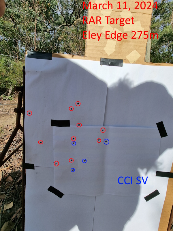

Had a fun session today, despite the heat. It was hot but under the trees it was pretty pleasant. The trek up the hill and back to check targets was a workout in the heat though :-)
There was a breeze but it was fairly steady and as it shifted it didn't jump about so I could follow it around pretty easily. I put a few mags on the steels with the RAR Target then I thought I'd drop five on the silhouette, but only had four left in the mag. At 275m the four went into 126mm, which is excellent but I doubt it's indicative, just luck I think. Then I loaded a 15rd mag with Eley Edge and saw how that shot. It might have a slightly higher BC as they were a couple minutes high. When I had it hitting the 8" gong I loaded a 10rd mag and put those on the silhouette, into 219mm, which is probably a more realistic representation. Just larger than the 203mm 8" gong but it probably means that I should be able to put at least 90% of them on the 8", 70% on the 6", and 40% on the 4" gong - _if_ I have a good handle on the wind. The Eley Edge is good stuff but is discontinued and I'm almost down to my last 1000rds. It might have a slight edge in accuracy over the CCI but not enough to matter I think, my misses will still be due to the wind far more than the ammo.
Then I swapped to the RPR and put two 15rd mags on the steels before going up top check the paper target. I was intending to patch it out and group the RPR on paper as well but the Target's group was good enough that I decided to keep it for analysis. I had forgotten to take more paper up with me so I brought the targets back and set up the Know-Your-Limits rack (10mm, 15mm, 20mm, 30mm, 40mm, 55mm, 70mm - the 10mm and 15mm plates are tough, even at close range) at 28m for Rose to practice on. I had a play with the RAR Compact to ensure it was zeroed while she was walking down to me, then I grabbed the RPR and tried the iron sights. I had no issue at all hitting the 70mm and 55mm plates at 28m, but I couldn't see the smaller ones at all against the dry grass so didn't even try those. Rose burned a few mags on them with the Compact (I've told her that she needs to be able to hit the 40mm plate every time to be confident of clean head shots on rabbits), then I gave her the RPR with iron sights and she blew my mind. She had no issue at all hitting the first four every time, and the 20mm plate more than half the time, with iron sights. She was hitting targets I couldn't even see :-)
295rds between us for the session.
