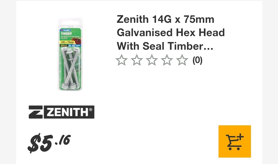

You could buy something like these for the wall studs. But get ones about 6 or 8mm x 75 if available.
Screenshot_20240219-202553_Samsung Internet.jpg (98.42 KiB) Viewed 8086 times

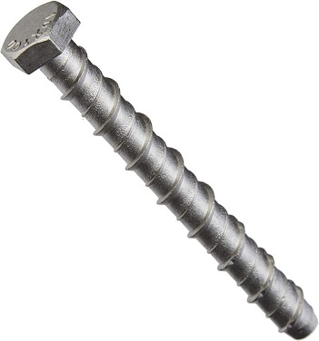

Instead source 'Masonry anchor screws/masonry screws'. Easy to install and remove.
You will need to confirm the anchor size requirements for your state.
Here is idea of what you might be looking for
https://www.bunnings.com.au/ramset-10-x-60mm-galvanised-ankascrew-masonry-anchor_p2260276
These will work even if you manage to drill the entire slab depth. They also work in brickwork or hollow masonry.
