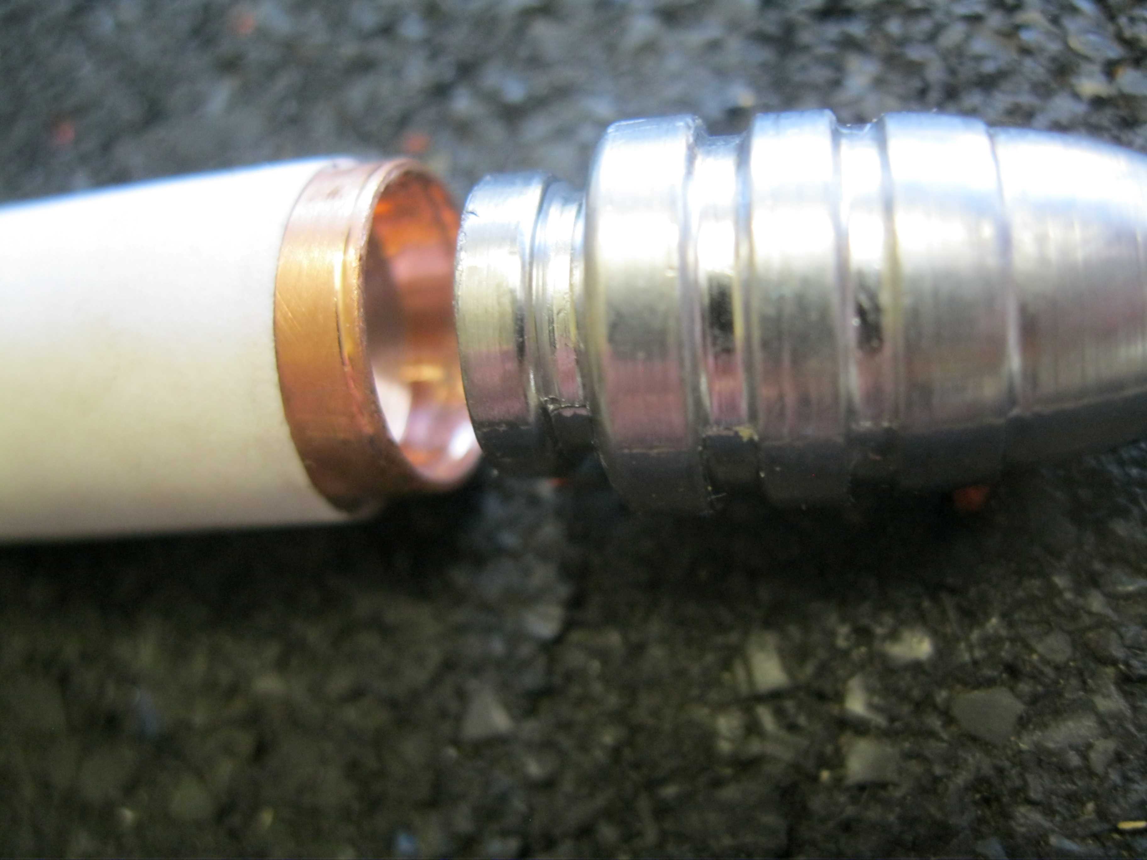

54 cal bullet.JPG (744.12 KiB) Viewed 33678 times
PTA not here yet but I went into the Dealer here to see it. Roger had put the mould I bought into the pack so I got it and bought it home and cast a few this morning. Cant make any paper cartridges yet until I see how long the chamber is.

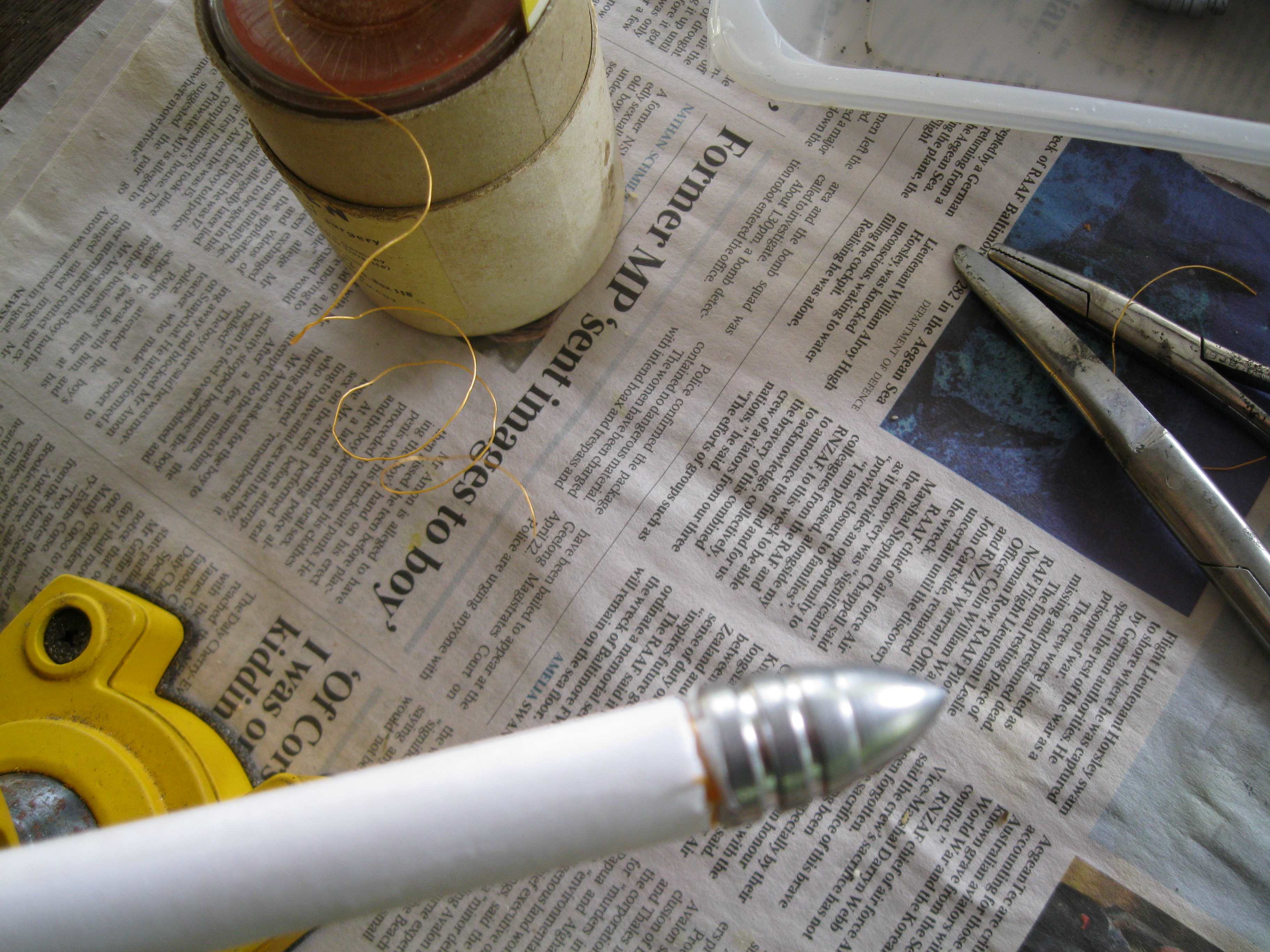

paper cartridge no 2.JPG (707.84 KiB) Viewed 33637 times
While I am waiting I thought I would have some practice making a paper cartridge.
These are the long tail ones to use the paper cutter function. Just to show how it was back in the day in the transition from muzzleloaders to brass cartridge..
From what I have read ,they are not particularly consistent in their performance but I will leave a few in the box and use the flat base cartridge for target work like everyone else. :)
paper cartridge no 1.JPG (705.27 KiB) Viewed 33637 times
I could not find any cotton but remembered I had some surgical suture thread left in my kit from "Before Yet" when I was with Vet Services of The Dept of Ag Stock and Fisheries in TPNG.
That seems to work. When and if I get my hands on the Carbine I can measure up the chamber and roll some real ones.

The only jig for these so far is 6 inches of half inch copper rod I drilled a hole in to hold the base of the bullet while I tie the patch on. I hold it vertically in a vice.
When I go to the flat based cartridges I will have to make up a different arrangement, as then the flat base of tissue paper gets glued on, powder inserted, then bullet either tied on or glued on last.

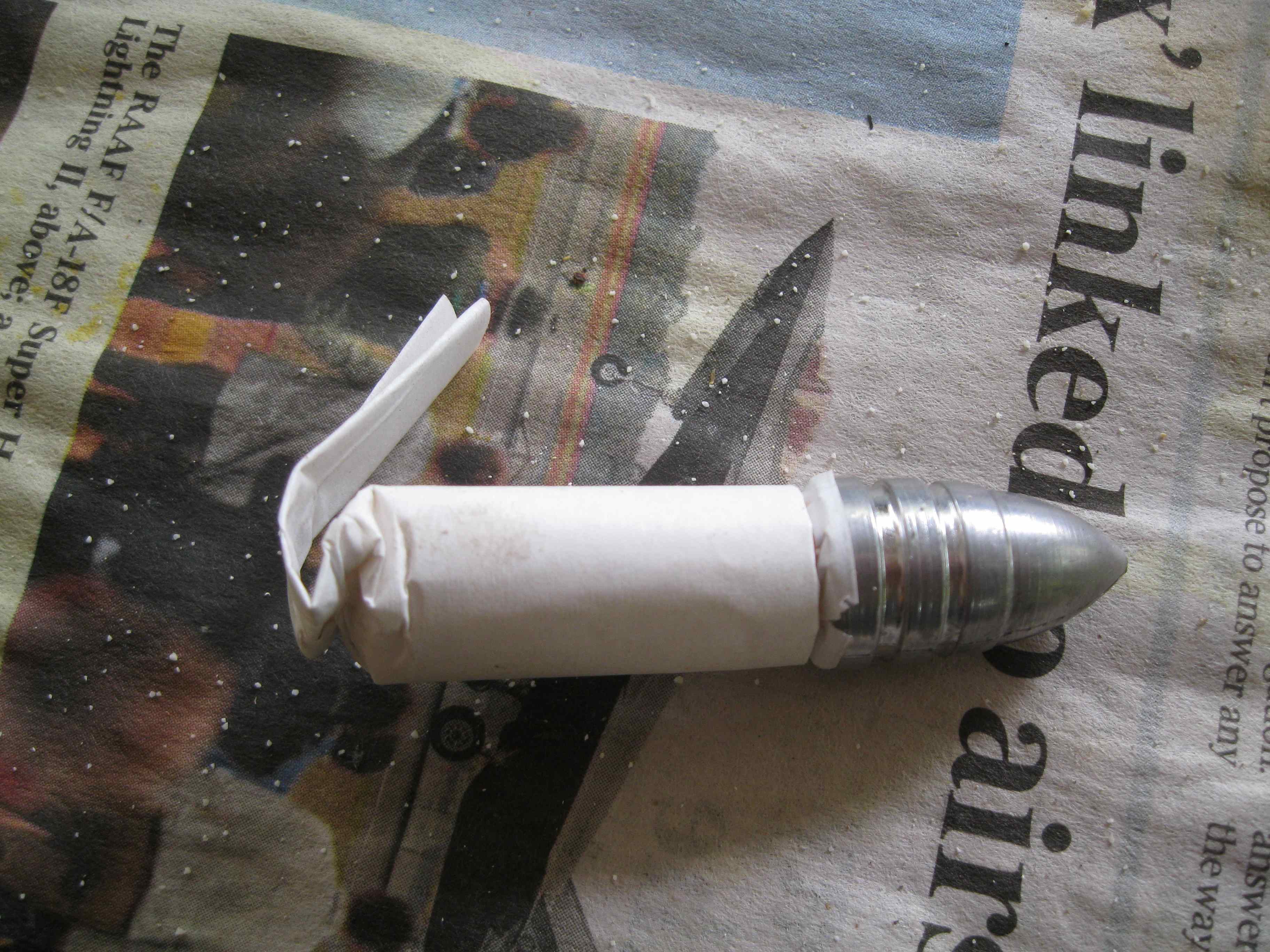

paper cartridge no 3.jpg (741.97 KiB) Viewed 31769 times
With the breech plate sharpened it works well now. Long tails are easier to load than the flat base as I dont have to muck about glueing the thin paper into the base.
Flat base with 80 grns 2F Wano on left and long tails with 85 grns Wano on right. Probably 5 grns gets lost when tail cut off.
