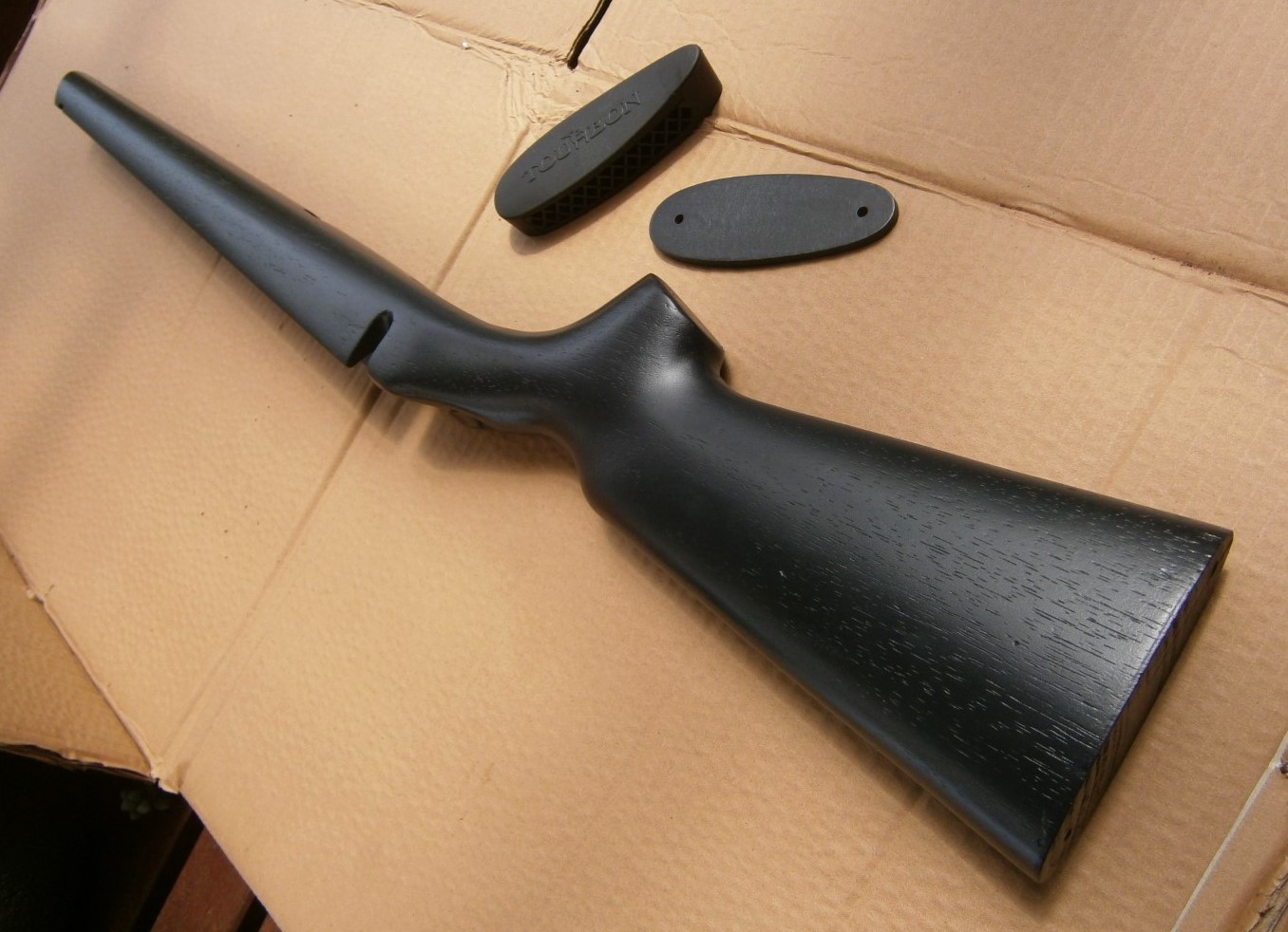

I originally had intended to return the stock to a timber finish, but put that idea in the
too hard basket. Instead, I sanded out the runs and most inperfections in the black paint job, filled and sanded a few holes and dings and refinished the stock in spray can black satin acrylic auto paint. It came up well!
The original butt plate/rubber was a bit tatty and one of the screw holes was drilled very crooked. I opted to make up a new metal butt plate from some 3mm steel, to which I would attach a rubber/silicone recoil pad + fixed the crooked hole issue. The new plate did add a little weight to the stock, which i.m.o. is OK with a .308 cal target rifle.
The barrel was floated with what appears to have been a good bedding job forward and rear of the front action screw and at the tang where the rear action screw is located. However, all the bedding had one fine crack running through the bottom/centre of it parallel with the stock/barrel. I'll see how the rifle shoots first, before I make a decision about whether to rebed the action.

- refinished stock, new butt plate and recoil pad
