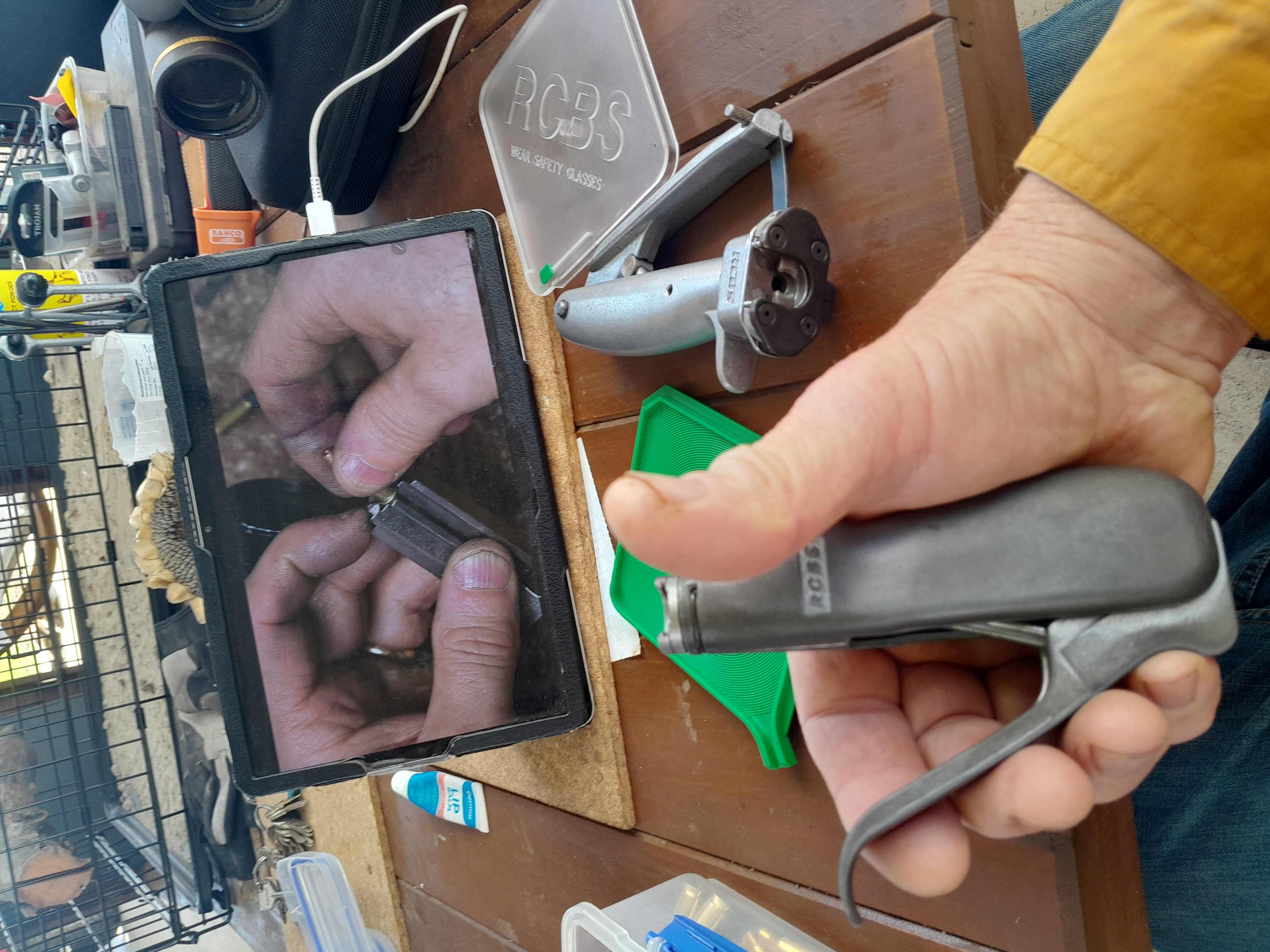

Post by Wapiti » 03 Jul 2026, 5:26 pm
Whilst having smoko I thought i'd try another priming tool with the Whire River primers.
It's a 30+ year old RCBS tool the old ones that have the interchangeable posts with the sprung loaded support cup and use the standard clip-in shellholders.
Bugger me dead, it seats these primers without much force where the other one on the table, with the fits-all shellholder, struggles bigtime.
Only drama is you have to single-feed the primers in, but the speed and ease of seating them compared to the newer one makes it actually no slower.
I have another older one at the other place with a primer feed plate, but it's 1-1/2hrs away and stuff that.
old rcbs priming tool.jpg (686.94 KiB) Viewed 4540 times
So just a heads-up to some who may be reading this and think these primers are difficult to seat, or use, but just check what tool you are using.
Some, with big long handles and grips are designed in the forcing-cam system to be actually p*ss-weak dispite the cost or all the fancy reviews.
The Lee one I have, for example, when trying to seat these primers it feels about to snap in half, where this old style "slow" RCBS tool is a breeze.
Try a few before you judge.

Post by Fester » 04 Jul 2026, 12:07 pm
Wapiti wrote:Whilst having smoko I thought i'd try another priming tool with the Whire River primers.
Do you also get the circular ring marks on the primers after seating them?
Every one had the ring mark for me, even trying to seat them lightly.
They were so tight that it has planted the thought in my head about a primer going off and setting the others off.
I now only load about 10-15 in the hand primer at a time and keep refilling, after reading how bad the results can be, even if it's a 1 in a million chance.
The Lee benchtop unit separates the seating primer from the rest and also has far greater leverage than most hand primers.
It's not 100% reliable, but generally just takes a firm dry cycle, and a primer feeds into position.
I get about 1 in 6-8 cycles when no primer feeds into its spot.
If CCI can fit so perfectly, and other brands that are made to SAMMY specs, why are these f_krs so tight?
Industry people talked them up, and no one seems to talk about how tight they are, unless it's a batch variety thing.
