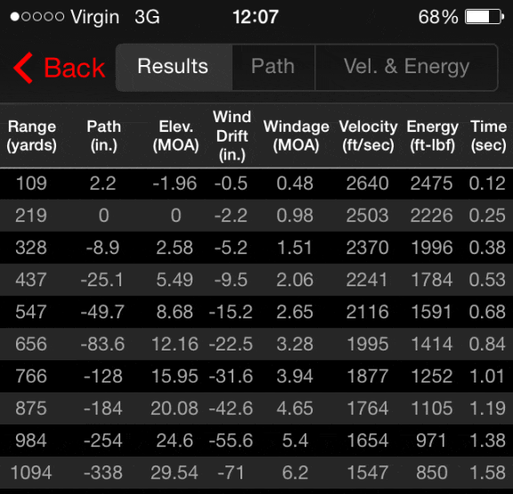

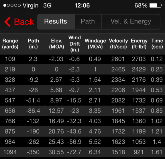

Post by Chronos » 26 Nov 2014, 11:19 am
shazz wrote:For target shooting a lot like heavy (long) bullets for their high BC, among other reasons.
With the heavy bullet weight comes recoil though and if you can't shoot heavy recoil then you become a problem.
So... Could a long bullet which was hollow provide a solution of High BC with low weight - and low recoil?
Ok so here's my answer to your questions Shazz
I believe your idea has some merrit but without testing its just theoretical.
Yes I believe a bullet with the same external dimensions and therefor BC but lighter because of a well designed hollow core would produce less recoil obviously and more velocity but still maintain the benefits of a long high BC bullet.
For example a 7mm 180gr Berger Hybrid loaded to a velocity of 2740 (my load) would have a trajectory like this
The same bullet 20grains lighter would have a trajectory like this assuming it's launched at the same speeds as my 162gr Amax load
You can see the lighter bullet shows less drop, less muzzle energy (a rough representation of recoil) and only a minor increase in wind drift, under 2" at 1000m
Obviously this would apply proportionally to a modified monolithic bullet of which there are a few on the market now.
Hope that goes some way to answering your question.
