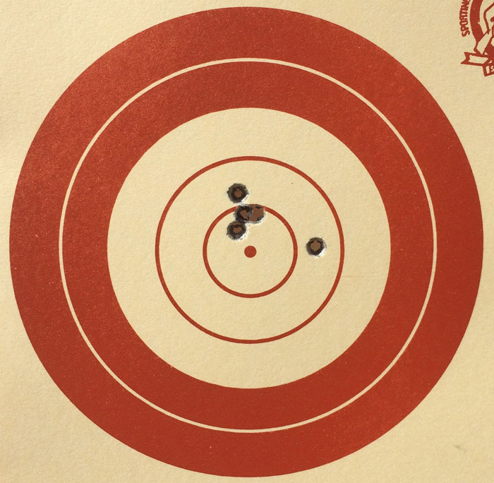

Mate and I got into reloading and finally got to try the first batch out today...
Here's the results from the first batch through the 22-250 at 100m (33 grains powder with 55gr SP projectiles)
First 4 were on the money and sent the fifth flying..
33 grains
This reloading caper ain't too bad...
Second pic is 34 grains of powder... Same again with me shanking the fifth again.. Doh

Post by brett1868 » 12 Jul 2015, 11:00 pm
Yep...and now you'll be chasing a smaller group again next time and the time after and the time after that....the beginning of an addition I think :)

Post by Browning » 12 Jul 2015, 11:08 pm
I'm stoked for now.. Given these are all hunting rounds and only really need to be MOP (minute of pig), I'm very happy with the results.. Need to work more on that "flier" (me) than the load hahaha

Post by Noisydad » 13 Jul 2015, 8:19 am
One of us, one of us, one of us......theres no saving you now! :-)

Post by Harper » 13 Jul 2015, 12:02 pm
Browning wrote:First 4 were on the money and sent the fifth flying..
Scientific fact, when you shoot the first 4 in an awesome group the 5th one is always a flyer :lol:

Post by bigfellascott » 13 Jul 2015, 12:15 pm
She's shooting fine mate, don't waste the barrel on trying to get smaller groups, it's really not needed for hunting purposes (been there done that one) now I just try for around 1" or slightly better with a load, if I achieve that I just use em to shoot fur, as I say you ain't shooting groups on fur so why bother with shooting groups to shoot fur? :thumbsup:
I still haven't even tested some loads on paper to see what they are doing, I just took em out and tried em out on rabbits at 200m or so and they all fell over so good enough for me. :lol:

Post by Rocker » 13 Jul 2015, 1:20 pm
33 is your winner :D
Flyers happen mate. Don't stress.
Keeping our ammo as uniform as possible and as your technique improves they'll happen less often, and less severely.

Re: First hand loads..
Post by Browning » 13 Jul 2015, 3:48 pm
Powder is 2208 Baldrick...
Also very lucky that the point of impact for this powder is almost smack on the factory rounds I was using...handy to know if I ever run out of hand loads out bush...

Post by brett1868 » 13 Jul 2015, 8:05 pm
This is a 5 shot group from last week where I've changed the seating depth a fraction and turned a .5 moa group to a .4 moa group. That 1 low shot was me rushing the shot and not controlling my breathing as I squeezed the trigger. I'm chasing 5 shots into the 1 hole and won't give up till I do it :)
Reducing group size can be an expensive exercise, getting to .5 moa can be reasonably cheap, the next .1 will be triple the cost, the next .1 10 times the cost and so on till you either go broke or insane :)
For general hunting I'm nowhere near as fussy, I stop load development at .5 moa as I only care about 1 shot groups on game.
One of us, One of us...heheheheh

Post by Browning » 13 Jul 2015, 8:22 pm
Impressive group Brett!! It seems like years ago when I was chasing extra tenths outta my car over the quarter mile... Every 1/10 improvement gets exponentially more expensive haha
Maybe we were touched on the knob that day getting it right first time cos as it turned out, my 308 loves the exact same load (everything) as his 308!
Happy reloading times!!

Post by Oldbloke » 13 Jul 2015, 9:00 pm
bigfellascott wrote:She's shooting fine mate, don't waste the barrel on trying to get smaller groups, it's really not needed for hunting purposes (been there done that one) now I just try for around 1" or slightly better with a load, if I achieve that I just use em to shoot fur, as I say you ain't shooting groups on fur so why bother with shooting groups to shoot fur? :thumbsup:
Agree 100%.. For hunting once u get to about 1" its enough. How well can you shoot in in hunting conditions. Ie sitting in front of a log, kneeling or off hand shooting?

Post by brett1868 » 13 Jul 2015, 9:06 pm
I did the car thing many years ago as well, (Before discovering the Suzuki Hayabusa) best for the 1/4 was 9.98 with a big shot of happy gas and I spent thousands to get into the 9's but didn't have the 100's of 1000's to get into the 8's, 7's, 6's etc etc. Shooting is very similar in that it costs more and more to shoot smaller and smaller till it costs absolutely everything to shoot nothing. I've been reloading >20 years but I'm a rank amateur at the precision reloading side of the game and it's been a steep learning curve so far though I've been getting a lot of help and advice from one of the members here who shall remain nameless. I have been reading many books on ballistics, shooting techniques, rifle setup and optics which has also helped in reducing groups.
Something to keep in mind...
Often some of the better improvements in reducing group size comes down to rifle weight, setup and fit and not necessarily the ammo. Length of pull, Scope height, Cheek height, Cheek weld, Eye relief, Finger position on trigger, Breathing control, How you hold the rifle and a consistent approach to shooting all contribute to precision.
Consistency in all facets of shooting is the key to accuracy.
