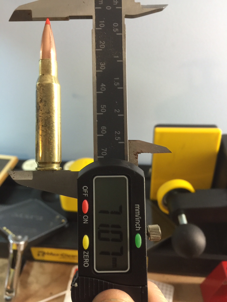

Hey guys just starting out on my first load and decided to do some 308win.
There is a challenge though - Ive completed reloads on the following, 1 set of reloaded brass which was purchased loose from a store in Brisbane and 1 set of rounds that Ive shot myself that were full rounds bought some months ago.
Ok the issue is after reloading them the two sets are different sizes in length see the amigos enclosed - my questions is that is this safe ? the first lot of rounds the projectile looks to be a lot deeper seated in the case than the rounds i shot. I hope this makes sense - sorry but its my first time.

looks like your seating die is loose/not set up right, did the loose brass all go too deep? can you pull the bullets out with ease, try with just a shell,do they just drop in?
how many loose shells did you buy? you did full length all the loose brass? :problem:

Was any adjustment made to the seating die between batches? That's the only explanation I can think of for the vastly different seating depths.
1. The shorter of the 2 appears seated way too deep and should not be fired under any circumstances. Seating too deep raises pressure exponentially which can lead to catastrophic failure, injury or death.

I would say that you haven't resized those cases as it looks the projectile on the shorter one has slipped down the neck and is sitting on the powder charge? Read the instructions on setting up the dies and then go buy a reloading manual ( Nick Harvey's),

It Looks to me you might have put the cases on top of the shell holder rather than in it when seating the bullet resulting in the bullet being seated to deep. I have made this mistake before.

That be some lateral thinking right there, and thinking about it the seating depth difference between the 2 rounds looks close to the thickness of a shell holder. Good pickup, it's not something I've actually done myself....yet :)

brett1868 wrote:
Ed9362 wrote:It Looks to me you might have put the cases on top of the shell holder rather than in it when seating the bullet resulting in the bullet being seated to deep. I have made this mistake before.
Nor I. :) :D :lol: :clap: ya gotta laugh if thats it. Well s**t happens.
