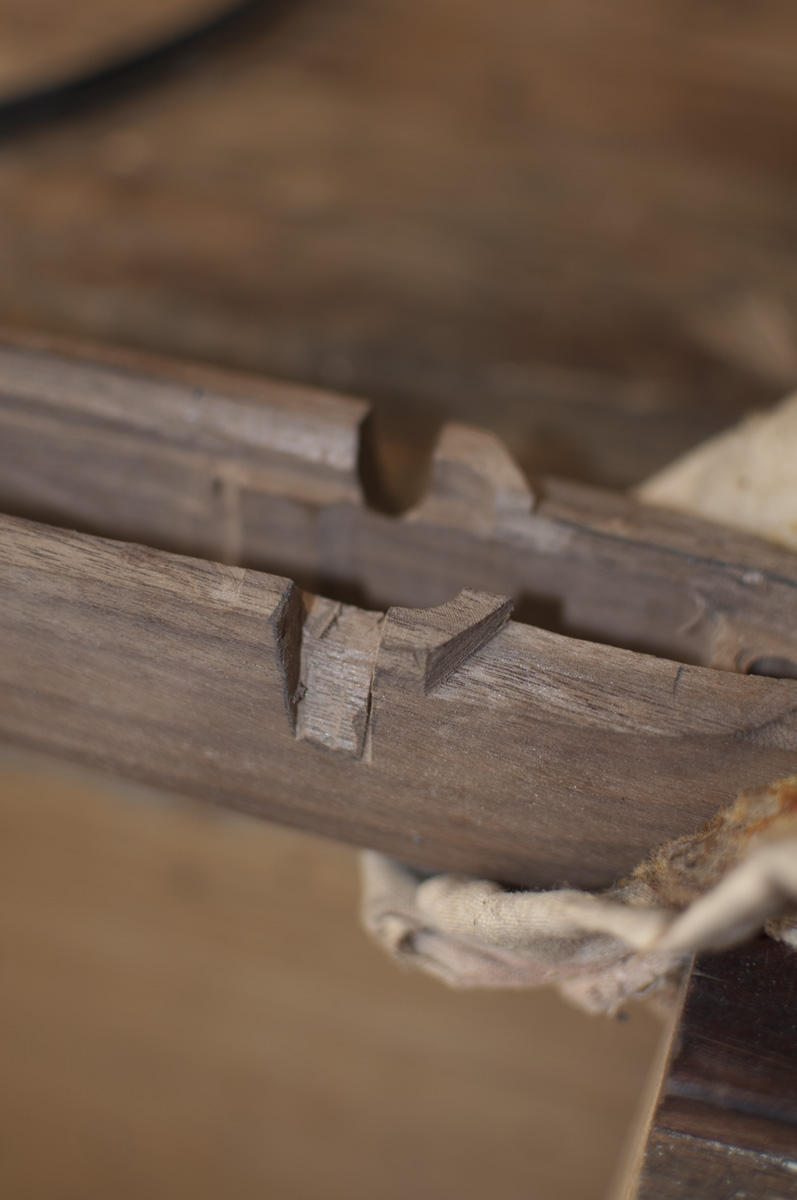

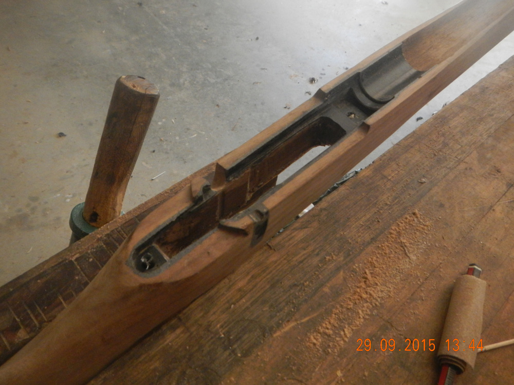

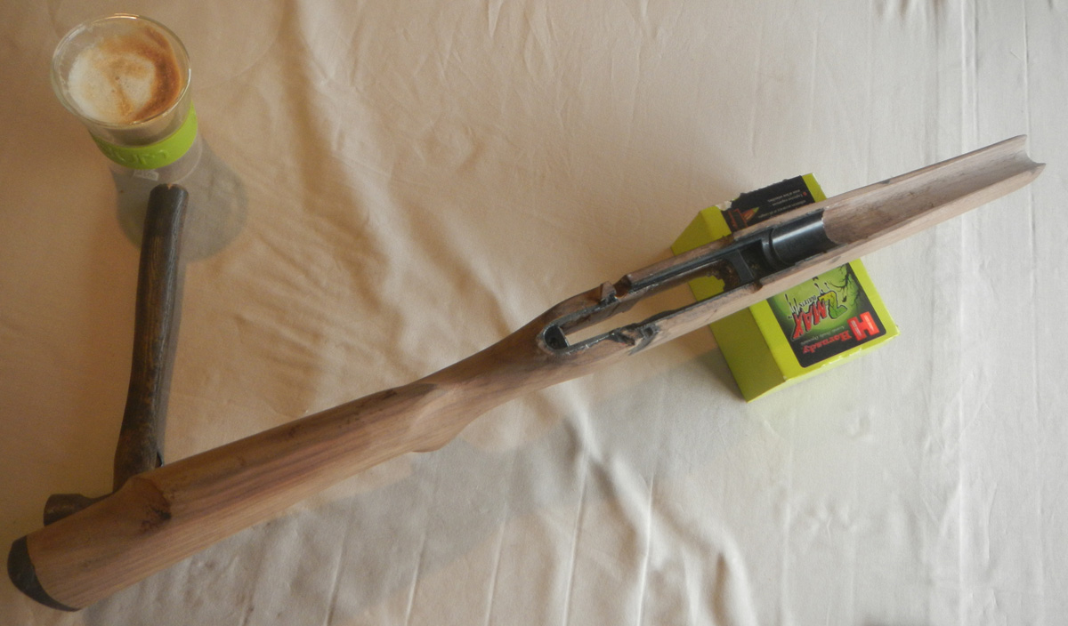

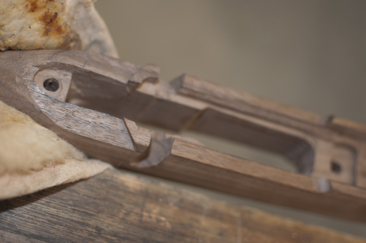

So, to the pics below. I started with a semi inletted walnut stock from Boyds. It was right hand because i couldn't get a lefty. My solution was to copy what Browning do with the T-bolt stock: each side is a mirror image so a a left or right action will fit in the same stock. Didn't work perfectly because i had to fill the right hand bolt recess with bedding compound to avoid having a point of intrusion for debris into the trigger mechanism. T-bolt being a straight pull, this is not an issue.
So mirror image for fitting the action, an over excited bit of floating the barrel and i't all ready for a fit and finish. I will also bed the floor plate in for a nice neat finish. I'll use some poly resin (fiber glass resin) with walnut sandings mixed in for this; add a bit of extra hardener and some post heat to speed up curing so that i can keep working on it sooner. Not recommended structurally but this is not a critical area and it's just a cosmetic fix.
Zastava Stock inletting 01.jpg (167.15 KiB) Viewed 10572 times
roughed out bolt recess for lefty conversion.
Zastava Stock inletting 02.jpg (148.45 KiB) Viewed 10572 times
Zastava Stock inletting 03.jpg (172.13 KiB) Viewed 10572 times
Zastava Stock bedded unfinished 01.jpg (223.78 KiB) Viewed 10572 times
Looks messy, but the bedding surface is nice and clean.
Zastava Stock bedded unfinished 02.jpg (321.99 KiB) Viewed 10572 times
PS: The king screws and the holes drilled in the semi inletted stock weren't a great match, so i reamed the holes out and used epoxy to set the pillars (provided with the Zasty action) into the stock before bedding.
Will update pics as progress ensues.

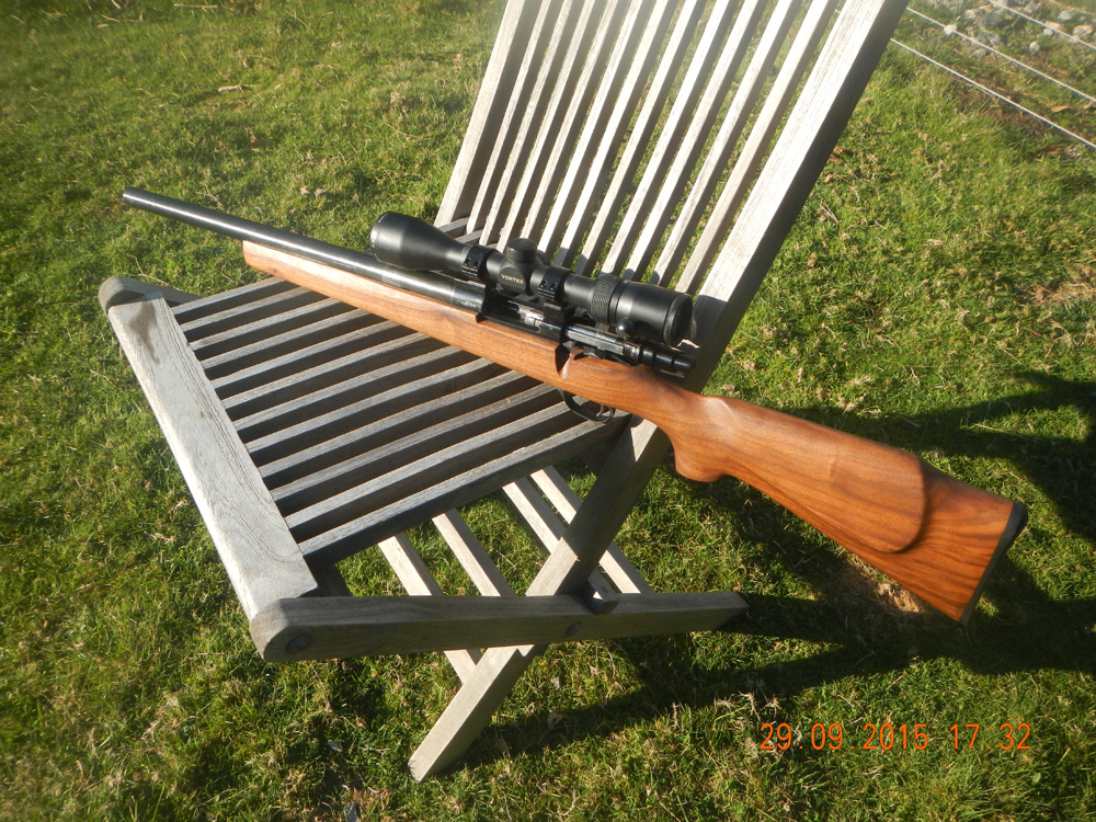

SO, a bit more tidying up of the bedding prior to sanding and finishing.
Zastava Stock bedded unfinished 03.jpg (241.44 KiB) Viewed 10522 times
All sanded up and a good application of finish.
Zastava Stock bedded finished 01.jpg (197.2 KiB) Viewed 10522 times
Zastava M85 heavy barrel fitted and scope mounted. I'll continue adding more applications of finish but the walnut is starting to come out already.
Zastava M85 Heavy Barrel fitted.jpg (511.07 KiB) Viewed 10522 times
Tomorrow i'll adjust the sear engagement because i have it set a bit too fine right now; it fails the 'bump test' with a heavy blow to the butt plate with a rubber mallet. Then i'll do some loading and a bit of development and sight the little darling in.
Not too bad for a farm gun.
When it is rechambered to 223McShort it will look pretty much the same. It will lose an inch off the total length and i might get it Ceracoated or reblued; depending on funds available. :thumbsup:
Now to get the thing shooting!!! :clap: :clap: :clap:

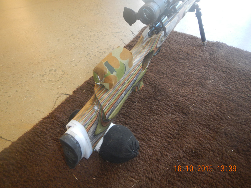

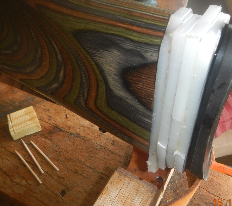

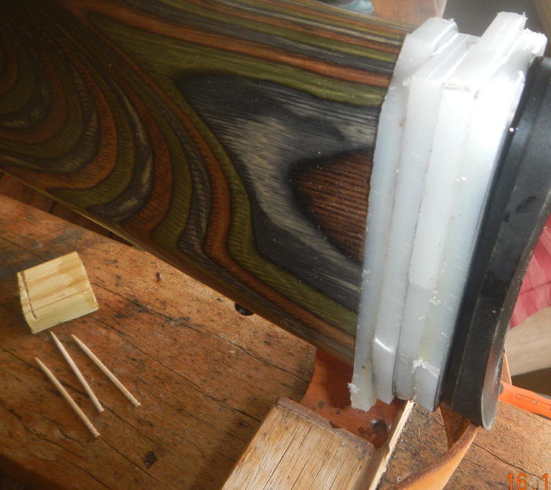

Post by Gwion » 19 Oct 2015, 6:42 am
So.
I've been having trouble getting comfortable behind the 7mm-08 and it's been showing up down range at 500-600yds. Very inconsistent results. The inconsistency also has something to do with inconsistent neck tension, as some bullets where very noticeably more resistant on seating (all fire formed and neck sized now so that's not an excuse anymore). The biggest issue has be the comfort factor and just not being able to get relaxed and repeatably control the rifle shot to shot.
So, why? I ask myself..... i was 'comfy as' behind the rifle before new barrel and scope....
Ahhh... new scope.... different height for cheek weld and, as it is MUCH longer than my little old scope, getting the right eye relief requires that my head is further back on the butt stock.
I've come up with a solution and in dry firing practice it seems to have worked, even if it is a bit of a "farm yard" fix.
Length of pull has had 1" added to it and i added a very rustic version of adjustable buttplate for comfy shouldering with no torqing cant.
My improvised comb riser needed a bit of height added to it, so i used layers of closed cell foam. As it now looked even uglier, I also covered it in a bit of Auscam i've had lying around for years. It also needs to be removeable so i can get the cleaning rod down the barrel, so i velcroed it on. :lol: :lol: :lol: :roll:
Not the best solution, but it does work.
Pics below for your amusement.
BUTT in progress.jpg (215.96 KiB) Viewed 11044 times
BUTT finished.jpg (210.63 KiB) Viewed 11044 times
Yes, that is a cheap nylon chopping board from Woolies! :drinks: :clap: :wtf:
Like i said... it's not the prettiest or most glamorous solution but on my limited budget it will, hopefully, at least get me comfortable behind the rifle and get those rounds falling in the same spot... :thumbsup:
The GRS stock is going to have to wait a LOOOONG time. :thumbsdown: :problem:

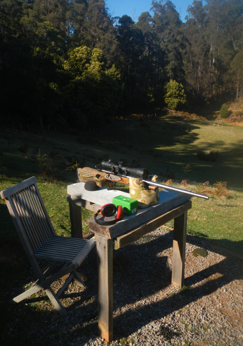

Post by Gwion » 25 Oct 2015, 8:26 am
Happy to report that the farm yard changes have made a marked difference to being able to get comfortable behind the 7mm08.
Managed a 50 & a 52 at 600 yards yesterday. Most consistent with the new barrel so far. Couple of rushed shots with poor wind reading and issues with a rest kept me from pushing the scores any higher.
