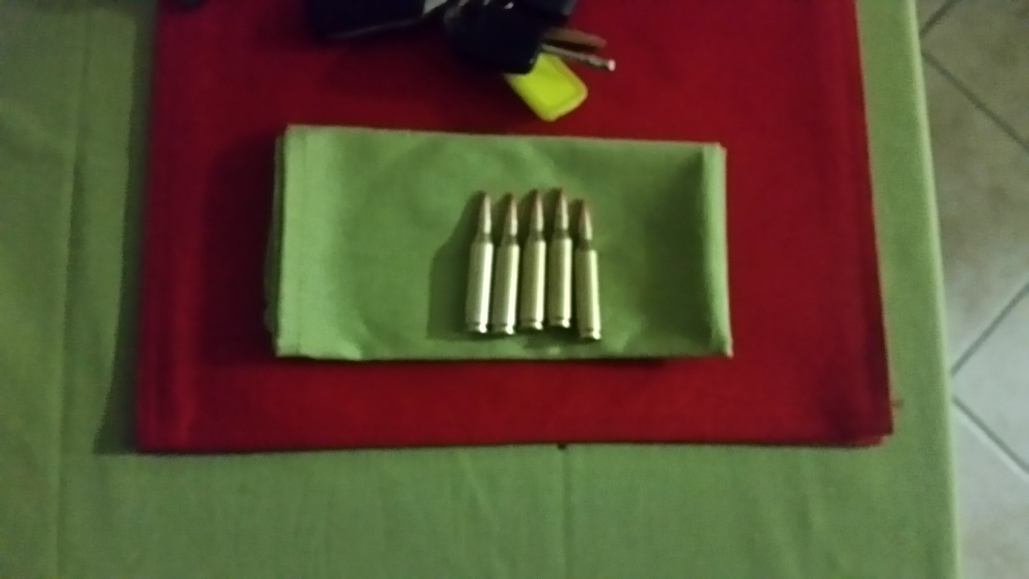

Post by AZZA'S HJ47 » 25 Jun 2016, 5:34 pm
So got my first 20 cases loaded up ready for the range. Will be interesting to see how they compare to factory ammo :drinks:
