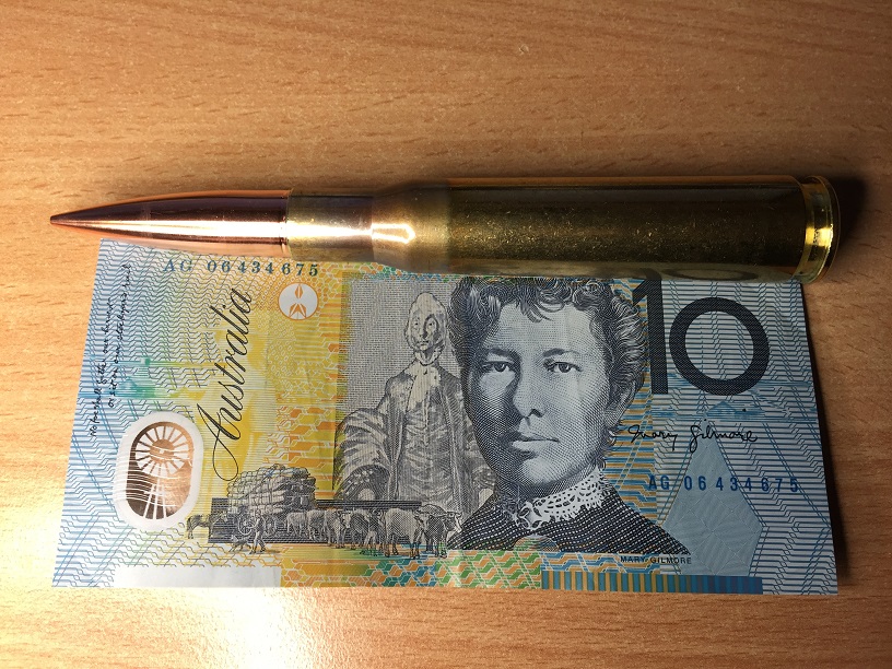

Post by brett1868 » 02 Aug 2016, 10:45 am
Smaller? wash your mouth out...... GO HARD or go HOME :thumbsup:
Is 798Gr of CNC solid copper hollow point hard enough? :lol:
Cutting Edge 798gr, RWS Primer & Lapua Match Prep 50BMG brass.

Post by bladeracer » 02 Aug 2016, 11:17 am
brett1868 wrote:Is 798Gr of CNC solid copper hollow point hard enough? :lol:
Load development must be bloody painful :-)
What does it cost to shoot a hundred of those things?
I calculate that loading it down to 300fps would have a similar recoil to the .204 (as in none at all). But a 100-yard zero shoots four-feet high at 50 yards, and five-feet low at 125 yards ;-)
Do you know if I can own a .50BMG rifle in Victoria - without having to shoot competition?

Post by David Brown » 02 Aug 2016, 2:33 pm
Probably about the note beside it..... :shock: Maybe more! :D

Post by Gwion » 02 Aug 2016, 3:52 pm
Is the 10 bucks for the next projie to be loaded? :lol:

Post by brett1868 » 02 Aug 2016, 4:18 pm
That round cost me $17.05 which is why I save them for special occasions such as yesterday, I got another year older yesterday so I spent the night loading these beauties :)
