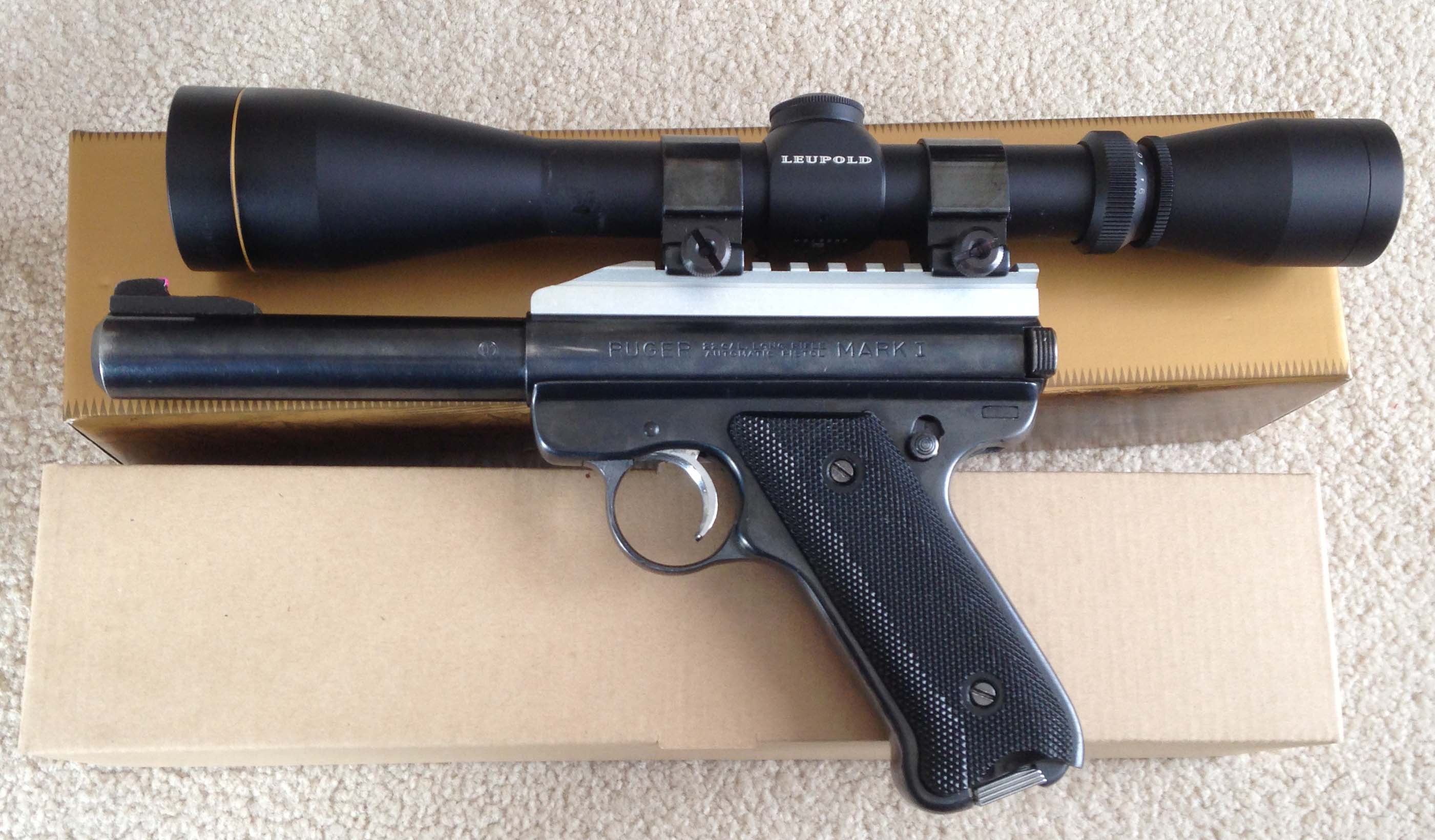

I have been using a 1976 vintage Ruger Mk1 for IHMSA and wanted to give it a bit of an update without going overboard on gunsmith costs. The pistol is quite accurate and has a great trigger but the original adjustable open sights were good but challenging for ageing eyes out to 100 m.
I got put onto Ken at KG Customs by a forum member and he was able to sell me a "no gunsmith" Weig-a-tinny rail solution which provided the family with a nice Fathers day present for me.. 1/2 hour later and "Gunzilla" was born - complete with VX1 3*9 - 40 Leupold scope. Will get to try it by the end of the week.

How's the rail attached exactly?

Post by DaleH » 09 Sep 2014, 2:31 pm
Prios,
the rear sight is drifted out of the dovetail and a new dove tail piece is inserted. This is held in place with two "hold down" screws locktited in place. The rail is then placed on top and two allen key bolts then clamp the rail to the new dovetail. Attached photo is of the new dovetail in place. The underside of the rail has a cut out for the slide retaining pin on the ruger.

Cheers for the pic dale.
Couldn't get my head around how it was DIY mounted.
