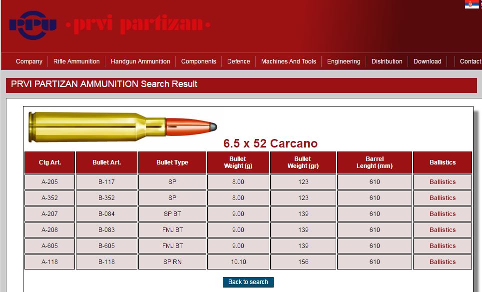

I forgot.
PPU offers 6.5x52mm ammunition in 123gn and 139gn .268", but they also offer the 156gn .263" loaded ammo so maybe standard 6.5mm bullets work just fine in the Carcano?

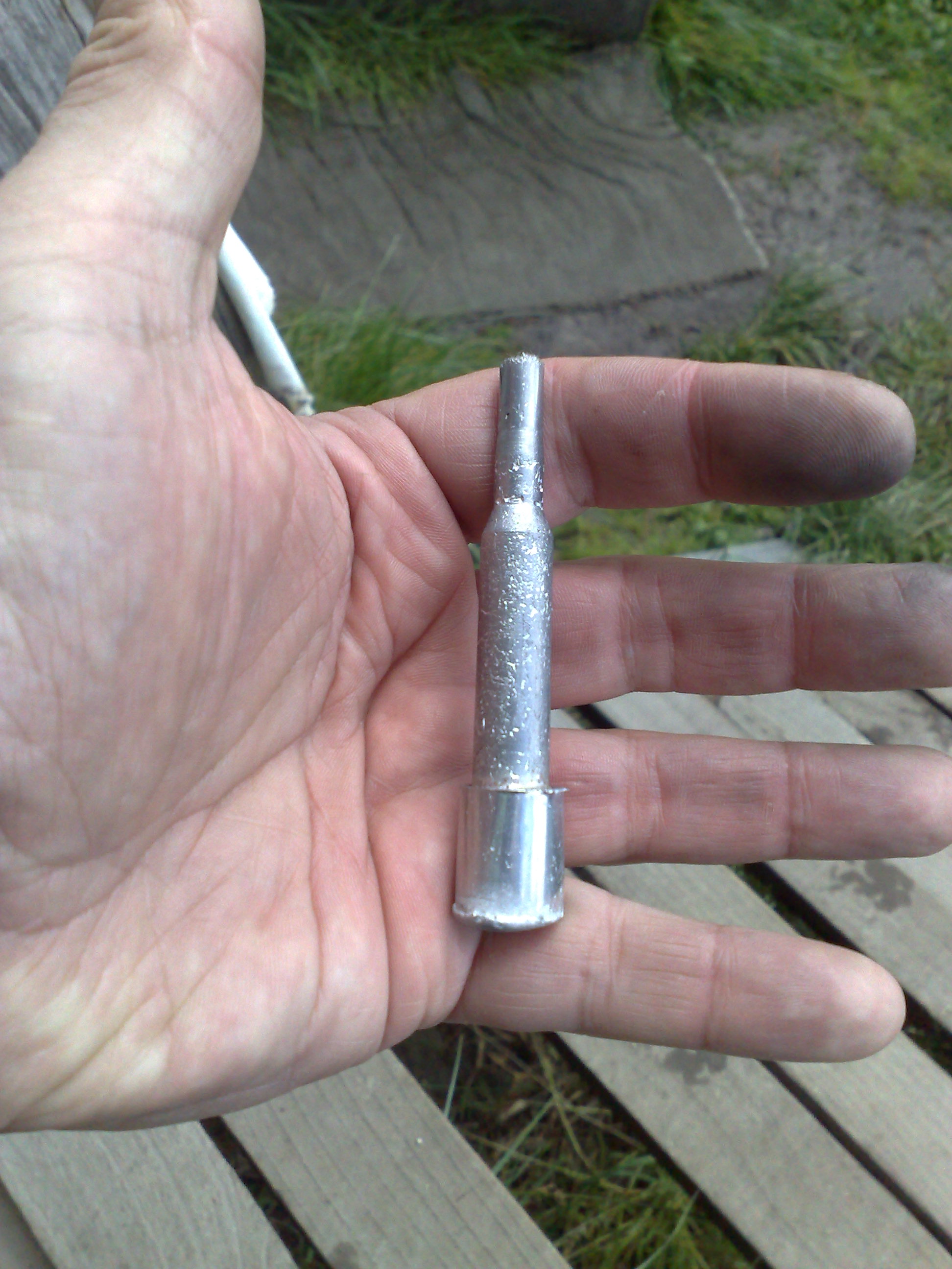

Post by bladeracer » 22 Oct 2016, 12:36 pm
Managed to do the chamber cast just now to confirm it is 6.5x52mm Carcano.
Struggling to find chamber dimensions but it fits cartridge dimensions very closely.
The only dimension that's out by a tad is the shoulder which is 0.0025" larger than the cartridge dimension.
Start of the bore is .2695" which shows 0.0015" of bore erosion but the throat is very nice so I'm happy with that.

I've read that some people have had success with heavy blunt bullets. The long bearing surface allows the base of the bullet to obturate just enough to build pressure, so I have some 160gn RN .264's coming this week to try.
Paper-patching .243 bullets up to .270" works very well, but is fairly fiddly.
Cutting a .17WSM case in half and seating a .243 bullet into it to bring it up to .269" works even better, and is a little less fiddly. Gaznazdiac sent me several hundred empty .17WSM cases for the purpose - thanks Gaz :-)
But I found a machine shop locally that is happy to try to make me some bullets on their CNC machines to my spec.
So I was up during the night on the lathe and turned up two designs of .268" bullet, a semi-spitzer boat tail, and a round nose along the lines of the original military bullet. In brass, they weigh 132gn and 149gn and are 1.300" and 1.285" long. I'll ask him to make make me 50 of each to test. I'm hoping that once I have a design, they'll be able to make them to any OD and any length by simply changing those dimensions. I'll also get him to make hollow point versions. He can also do them in copper if I want, but machining copper sucks, so I'd expect those to cost more.
And does anybody happen to have an original Carcano military round nose bullet I could borrow to make a drawing from?
