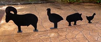

Post by bladeracer » 01 Mar 2018, 5:37 pm
I got some numbers back.
A set of four full-size targets (one of each animal) in Bizalloy500 is $800+GST.
A set of eight half-scale targets (two of each animal) in 6mm mild steel is $230+GST (three-eighth scale is the same price).
A set of twenty one-fifth scale .22LR targets (five of each animal) in 6mm mild steel is $300+GST.
A set of forty one-tenth scale targets (ten of each animal) in 3mm mild steel is $405+GST.
Shipping would be ex-Brisbane.
Notes:
Thicknesses of the full-scale targets does not seem to be specified anywhere on the site so I can't confirm if they comply to competition spec (12.7mm and 10mm).
The half-scale Smallbore targets should not be 6mm mild steel. They should be 10mm (chicken), 7mm (pig/turkey), and 5mm (ram). And as we are shooting these with "Pistol Caliber" centrefire rifles at 40m, 50m, 75m and 100m they need to be Bizalloy360 at least. I suspect 6mm mild steel won't stand up to 240gn .44's at all well. I have explained this but I don't know if it will affect the pricing.
The tenth-scale chicken should be 5mm, not 3mm.

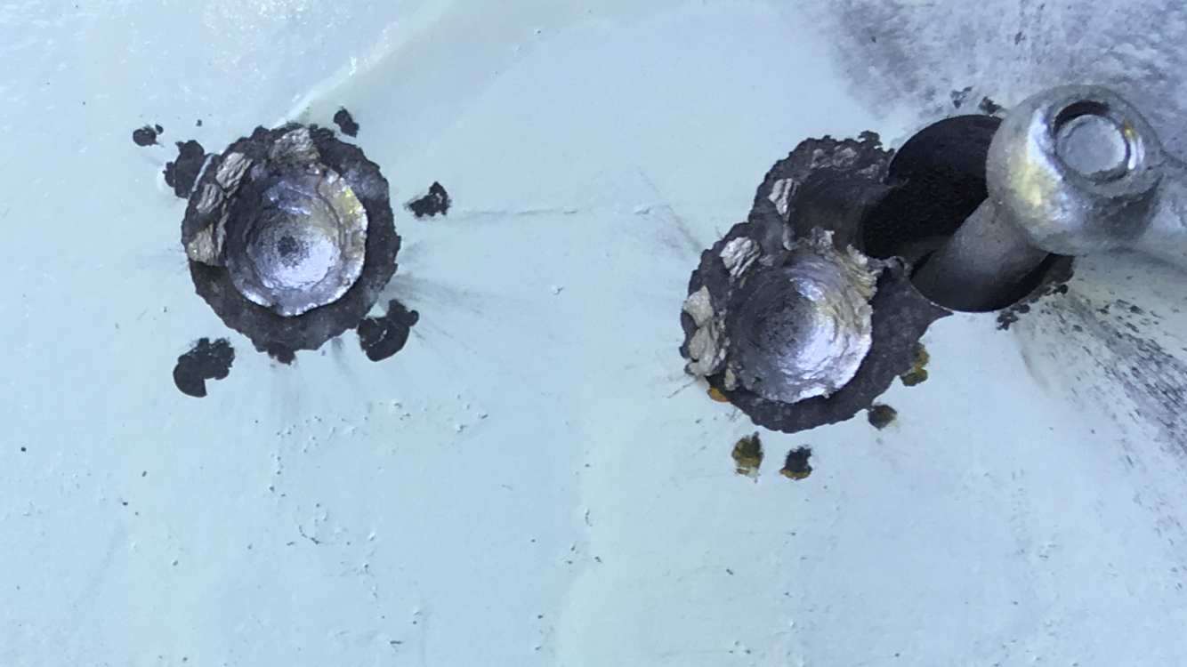

If it’s any help, this is a 12mm mild steel target hit with a Hornady 55gr projectile from a 223. The Hornady ammo box suggests 3240fps.
Target hit at 200m.
Mild steel is cost effective, but useless for longevity. (Well it is for the way I’m using it!)
The reverse side of the target shows the target surface is slightly blistered from the projectile impact.

Yeah, that's why I said for mild, cast bullet loadings only. This target, ( made from mild steel ), has been in use for about 10 years and has been hit a lot with everything from .22RF to 560gr .45 cal bullets with blackpowder loads, ( admittedly from 385m ). The slight cratering that can be seen is from 175gr cast bullets going about 1700 f/s out of a .30-30. The fresh splashes on it are from 250gr cast bullets out of a .38-55 doing 1500 f/s from 150m. Nil cratering.

High velocity, jacketed bullets need bisalloy targets for any sort of longevity.
Pretty sure Bladeracer is using cast bullet loadings.

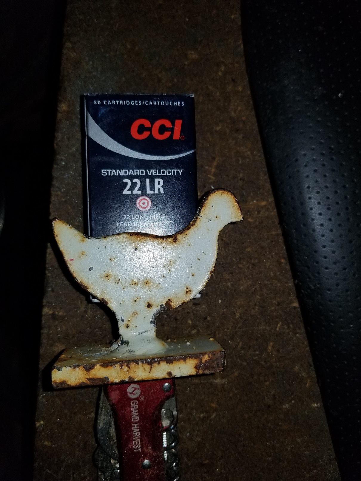

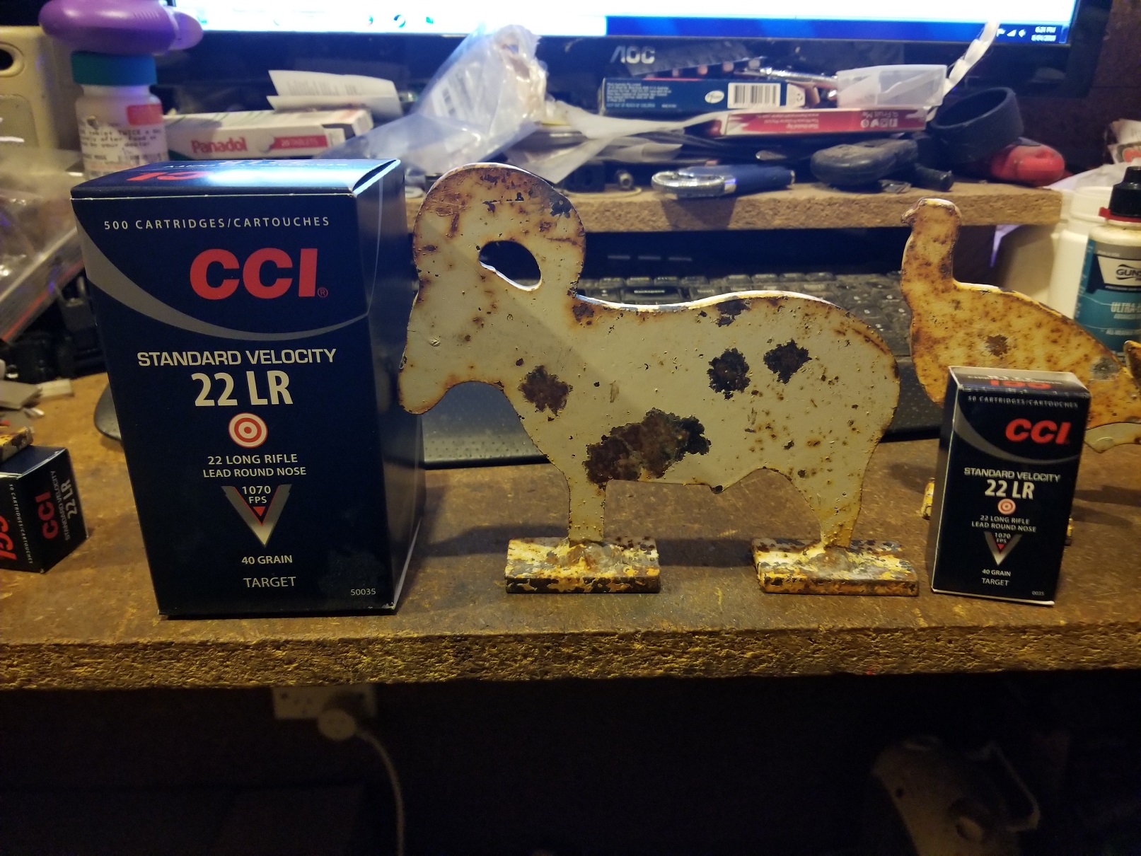

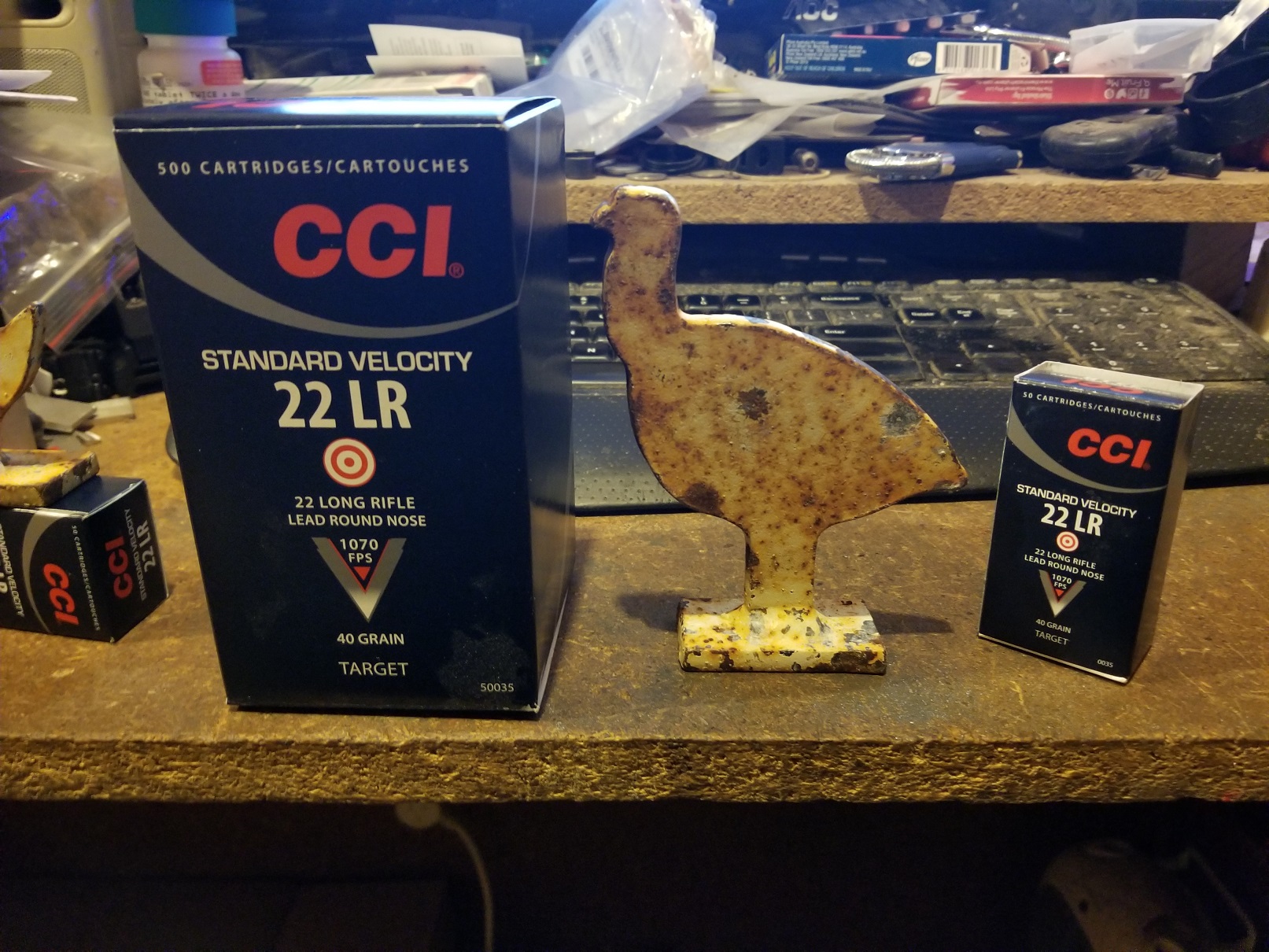

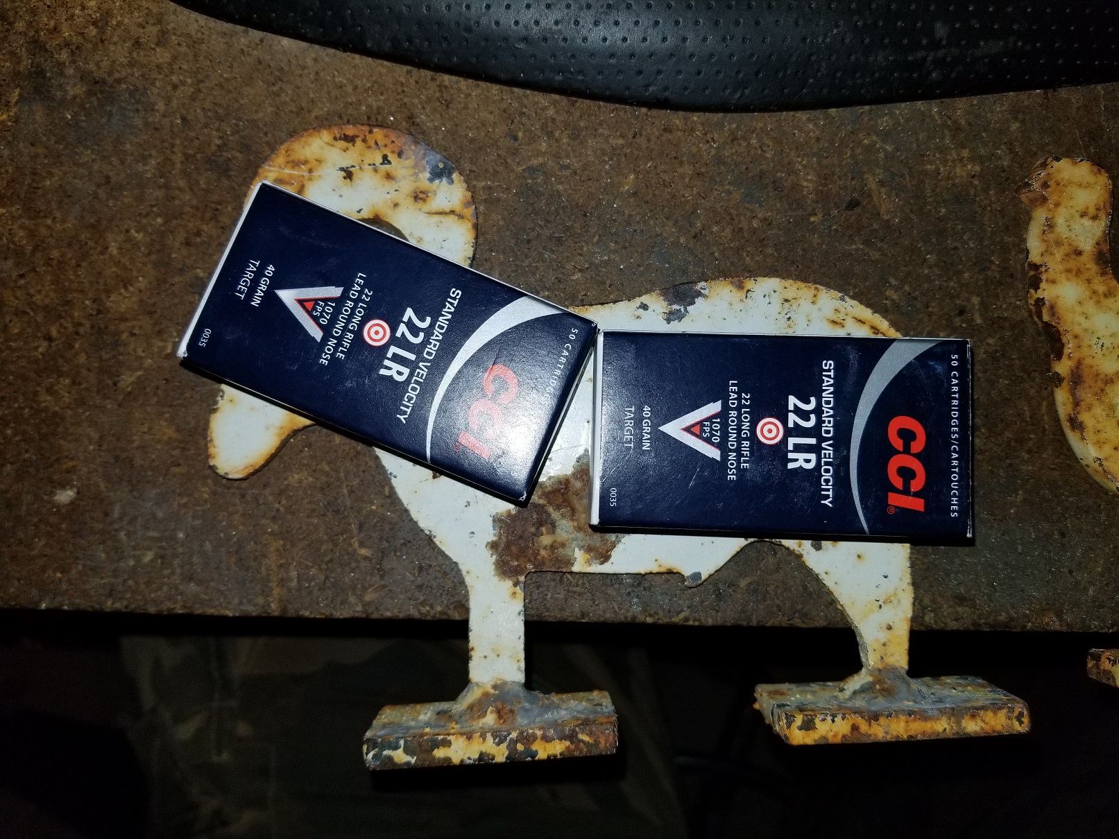

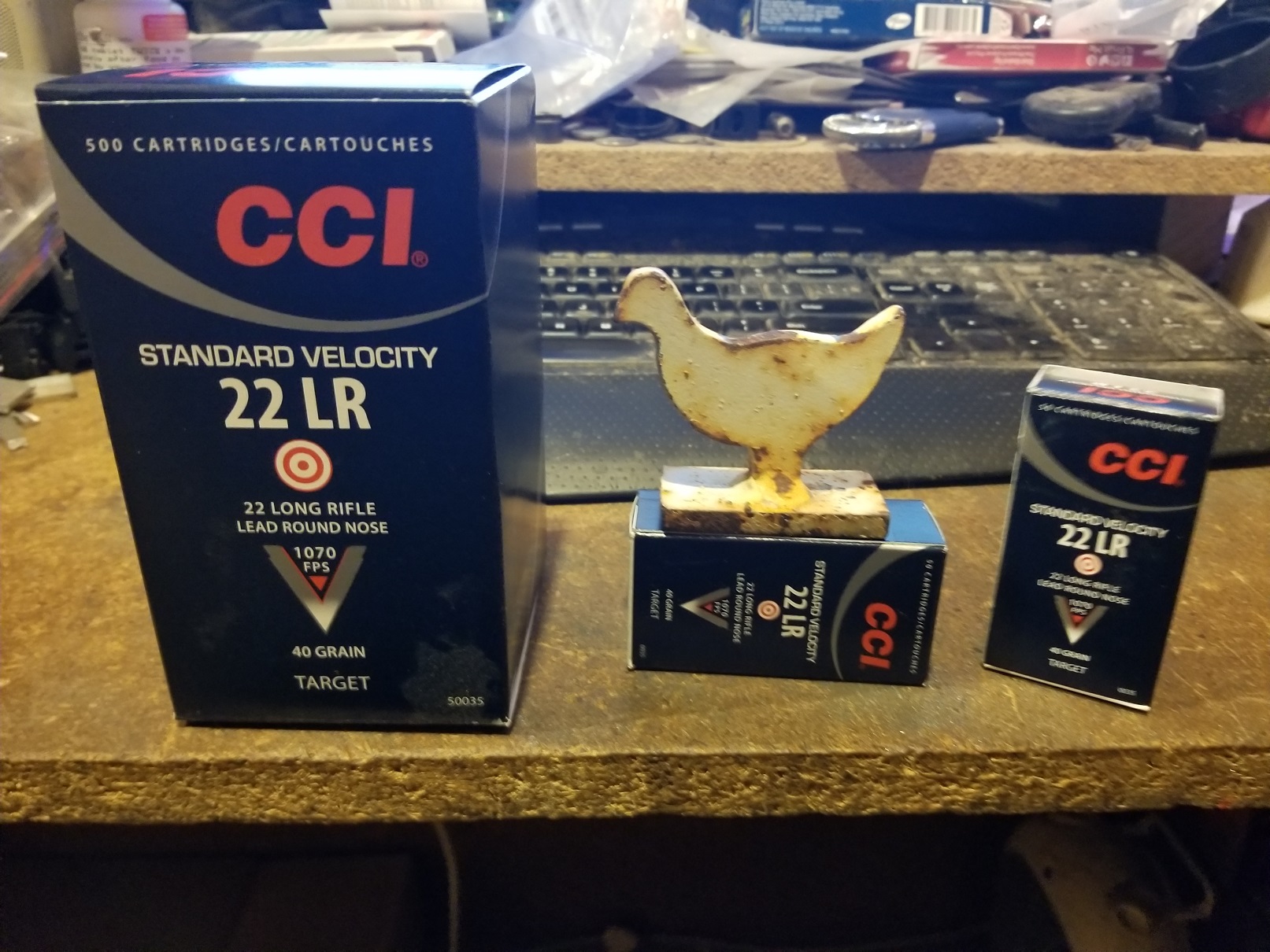

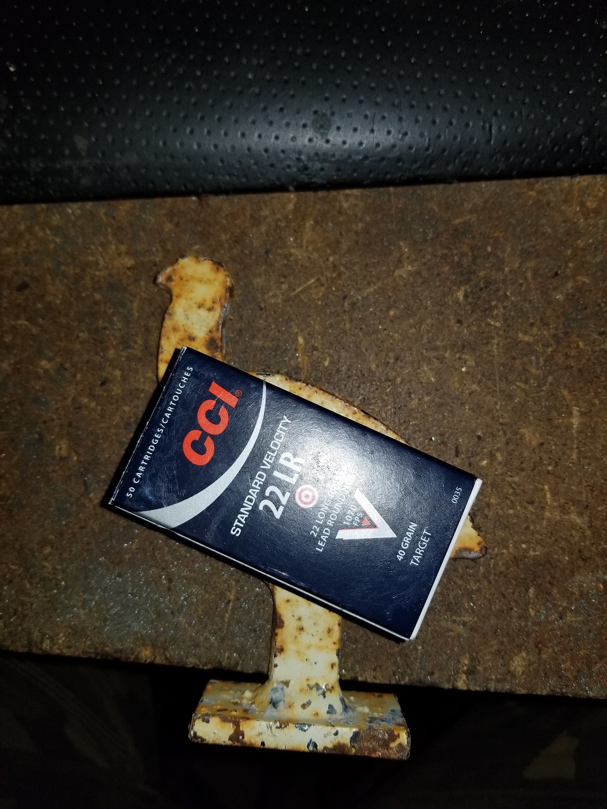

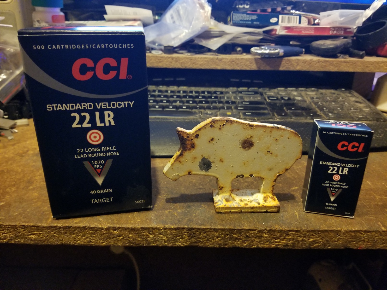

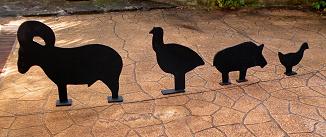

Can someone please tell me what the approximate size of the rimfire metallic silhouette targets is? I was having a good plinking session today and was getting a bit cocky so now I'm wondering roughly what size targets I need to be hitting at each distance. Thanks in advance.
Posts: 747
Re: Metallic Silhouette targets...again
Post by bladeracer » 08 Apr 2018, 6:30 pm
Bent Arrow wrote:Can someone please tell me what the approximate size of the rimfire metallic silhouette targets is? I was having a good plinking session today and was getting a bit cocky so now I'm wondering roughly what size targets I need to be hitting at each distance. Thanks in advance.
Very small :-)
All shot offhand unsupported.
RMS Chicken.jpg (483.98 KiB) Viewed 16847 times
RMS Pig.jpg (546.23 KiB) Viewed 16847 times
RMS Turkey.jpg (594.11 KiB) Viewed 16847 times
RMS Ram.jpg (555.15 KiB) Viewed 16847 times
The 40m chicken is 65mm from nose to tail and 60mm tall, the "mass" is an oval 45mm wide by 27mm tall - roughly one-third of a .22LR box stood on end.
RMS Chicken b.jpg (611.28 KiB) Viewed 16841 times
The 60m pig is 110mm from nose to tail and 76mm tall, the mass being an oval 95mm wide by 50mm tall - slightly bigger than a .22LR box laid on its side.

The 77m turkey is 100mm wide and 120mm tall, the mass being an oval 70mm wide by 50mm tall, but laying about 40-degrees from horizontal. A .22LR box on its side is about right.
RMS Turkey b.jpg (707.06 KiB) Viewed 16841 times
The 100m ram is 160mm nose to tail and 140mm tall, the mass being an oval 120mm wide by 60mm tall.
RMS Ram b.jpg (748.34 KiB) Viewed 16841 times

Gamerancher wrote:Pretty sure Bladeracer is using cast bullet loadings.
I'm primarily using cast bullets against steel, but my half-scale silhouettes are BZ450 and they laugh at the 240gn JHP's.
I didn't see any rules disallowing jacketed bullets in Lever Action Silhouette - are we allowed to use jackets or do they have to be cast? Can they be copper plated Berry's?
