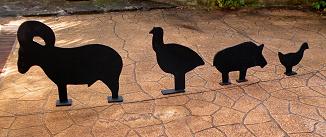

I have not been able to find anything specifying the position that the feet are to be welded to the target. However, Groundhog sent me a drawing specifying that the chicken and turkey must have their "feet" aligned flush with the rear "facing" of the target's "leg". I struggled to find a photo of silhouettes with the feet aligned with the back of the birds' legs but eventually one popped up.
- silhouettes.jpg (18.59 KiB) Viewed 16629 times
Before I send it through to be priced I thought I'd better get some feedback to confirm the details are correct.
Can anybody see any errors in the above?
For example, what size is the spike for the target stands?
