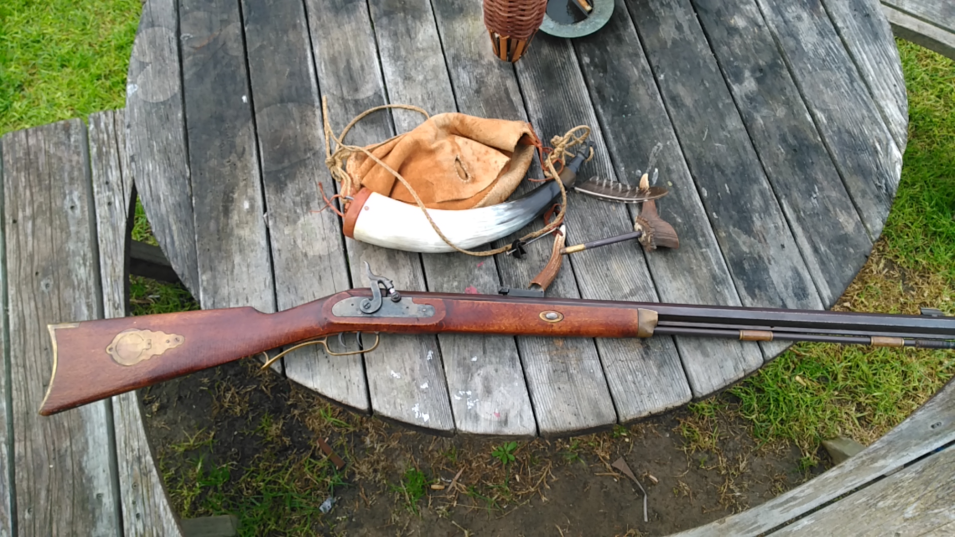

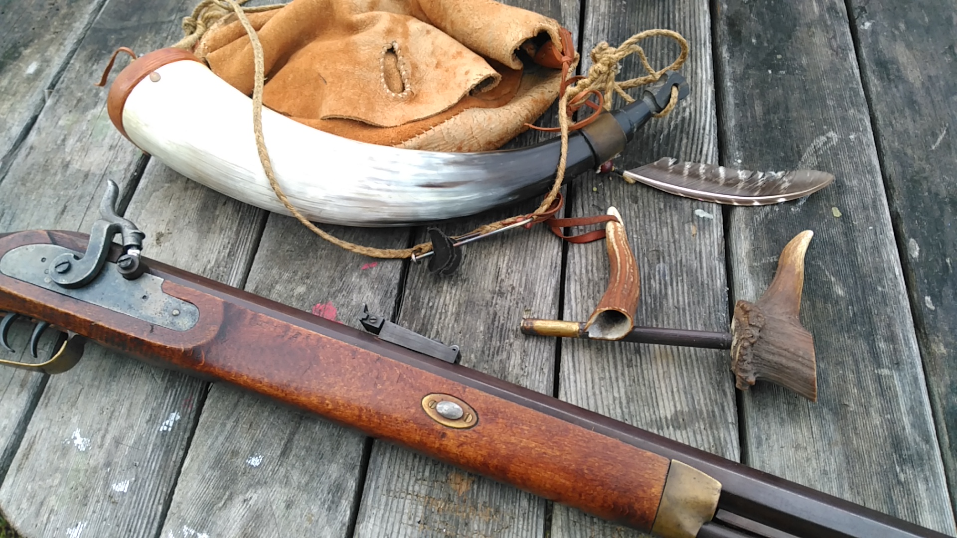

Post by bigpete » 31 Aug 2016, 9:26 am

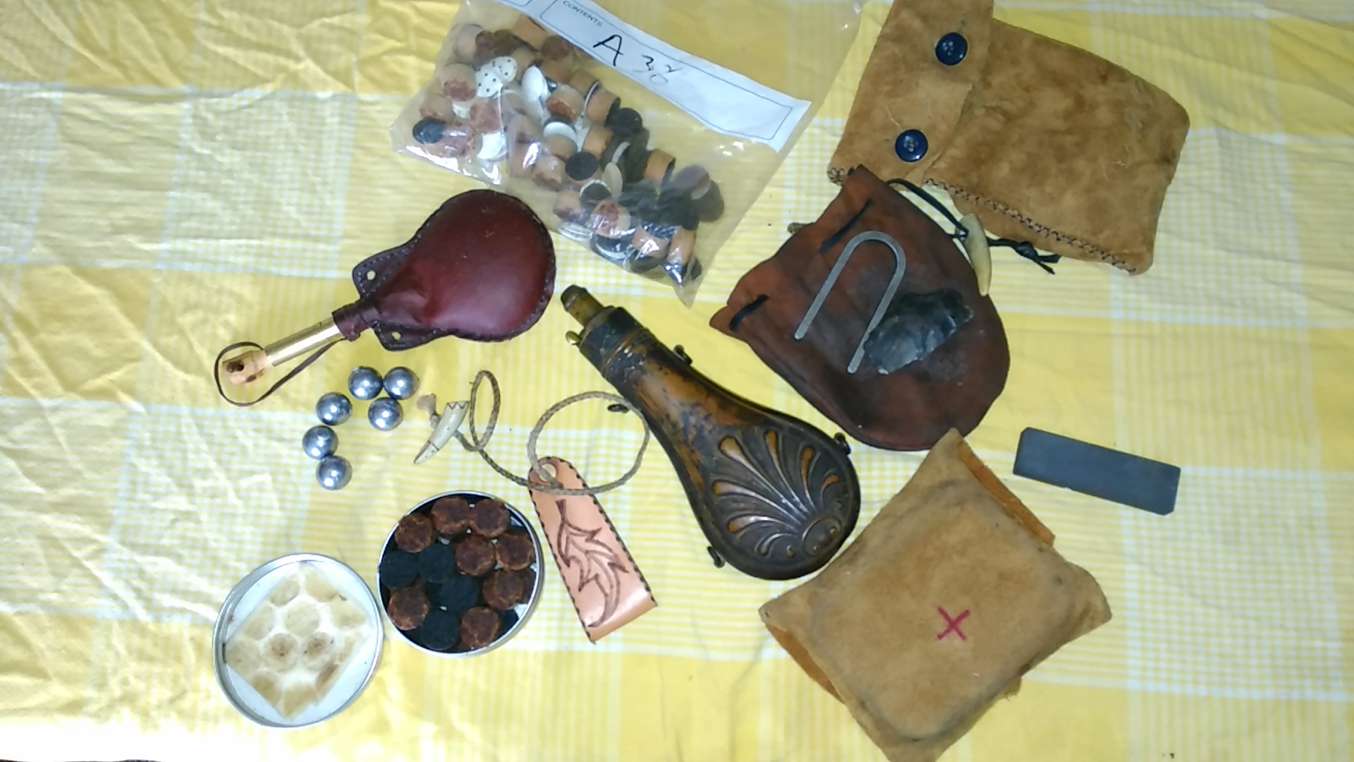

here's my 50 cal dikar and my shooting bag and powder horn
close up of my bag and horn. All homemade. The piece of antler is my powder measure,it holds 80gn of 3f. I shoot .495 balls and .010 patches spit lubed and get pretty consistent 2" groups at 50m off a rest. Nowhere near that that freehand :-). No idea exactly how fast it shoots but going off a chart I was given supposedly around 1800fps. I have tried 360gn .500 Conicals through it and they shoot terrible,leading me to think it has a slightly larger than .50 bore. Or its a bit worn lol

here's the kit I'm setting up for grandpas shot gun. Left to rightish: tin of lubed cushion wads,6 .725 RB,shot pouch full of size 4 shot,cap holder,plastic bag full of dry cushion wads,leather over powder wads and overshot cards,piwder flask set at 2¼ drams,flint and steel fire kit,first aid kit,sharpening stone,and cleaning bag.
all of it goes into my fallow skin possible bag. Still have a few things to add though

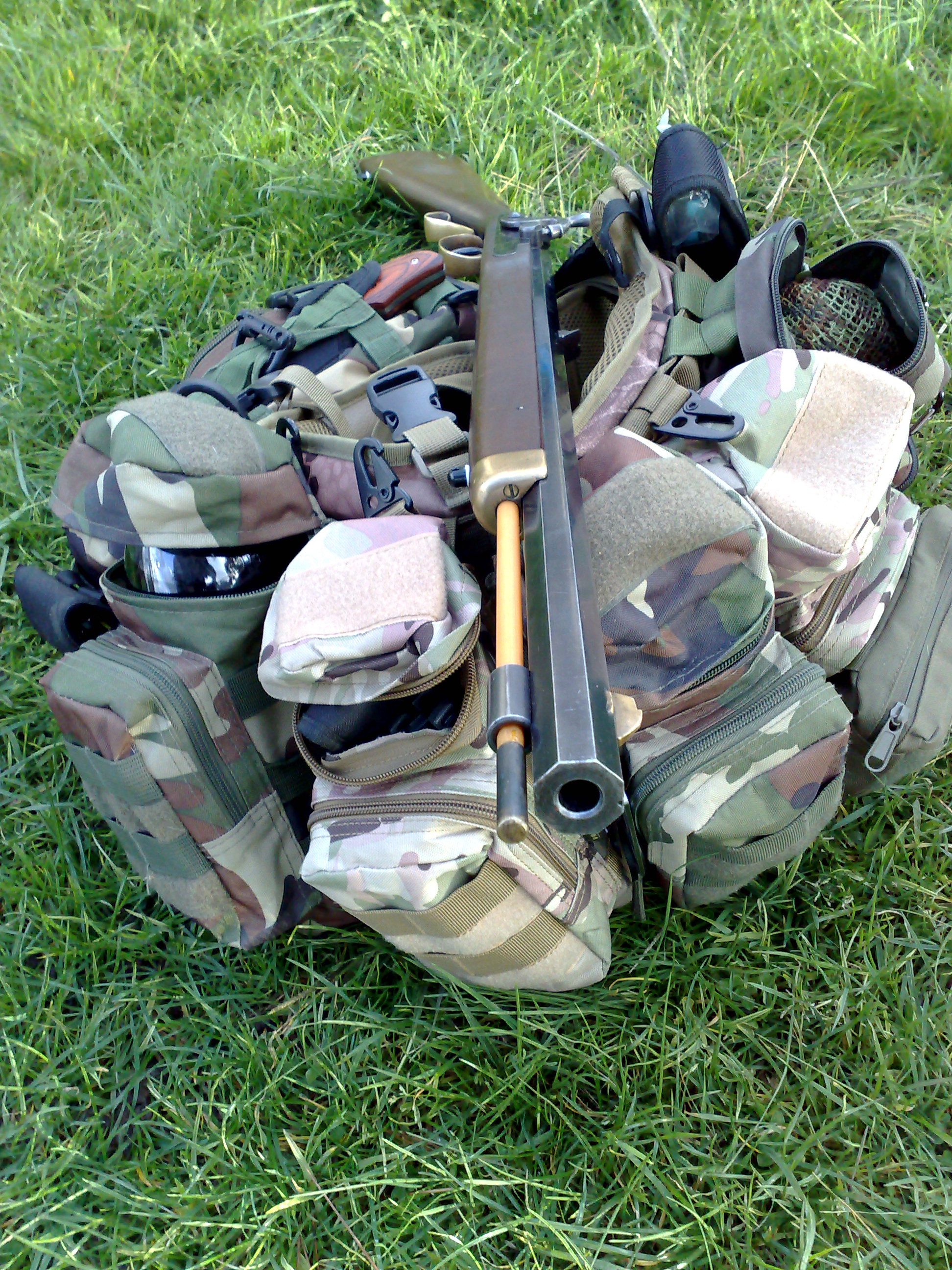

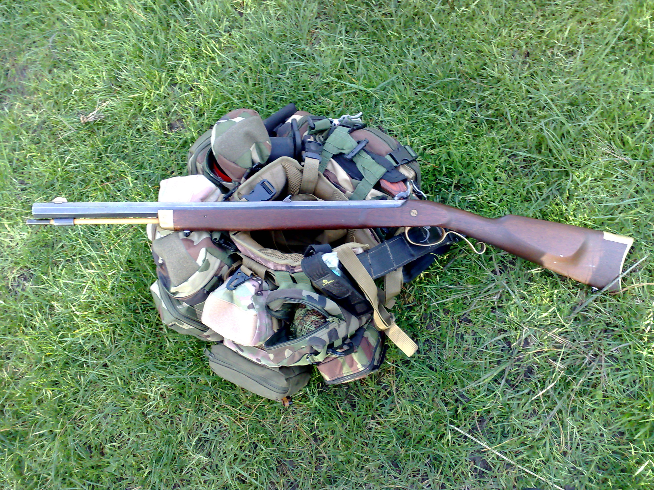

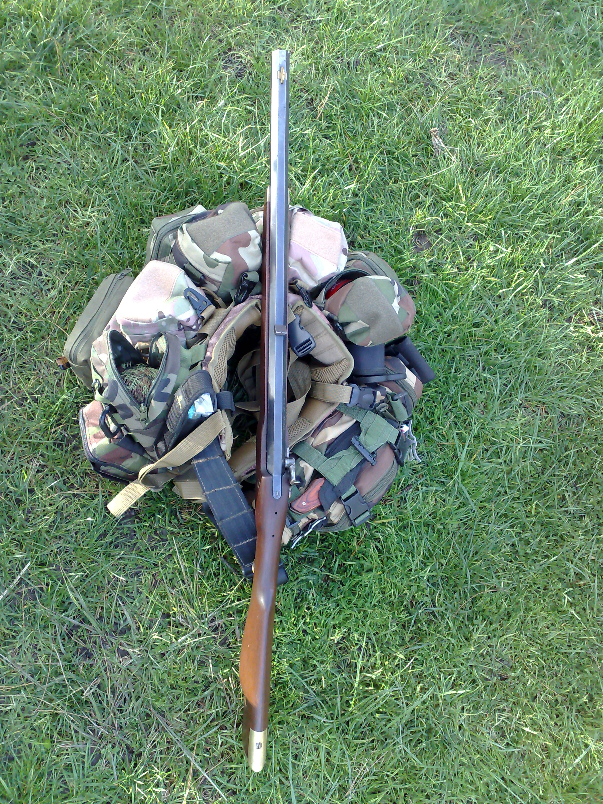

My Hawkins Arms .45.
Hawkins Arms 45 BP.jpg (1.44 MiB) Viewed 18868 times

Post by bladeracer » 31 Aug 2016, 9:45 pm
bigpete wrote:That looks short and handy
It looks short because the barrel is so fat :-)
I was surprised when I saw it as I'd been expecting any BP rifle to be five-feet long at least.
Considering the wall thickness of the barrel I'm glad it's no longer though.
24" barrel, overall length is 1010mm (50mm shorter than my 22" Ruger Americans), length of pull is 13.5" and it weighs 3.35kg.
The wrist has been drilled, I'm guessing for some sort of peep sight which would be nice.
Took some others while I was at it.

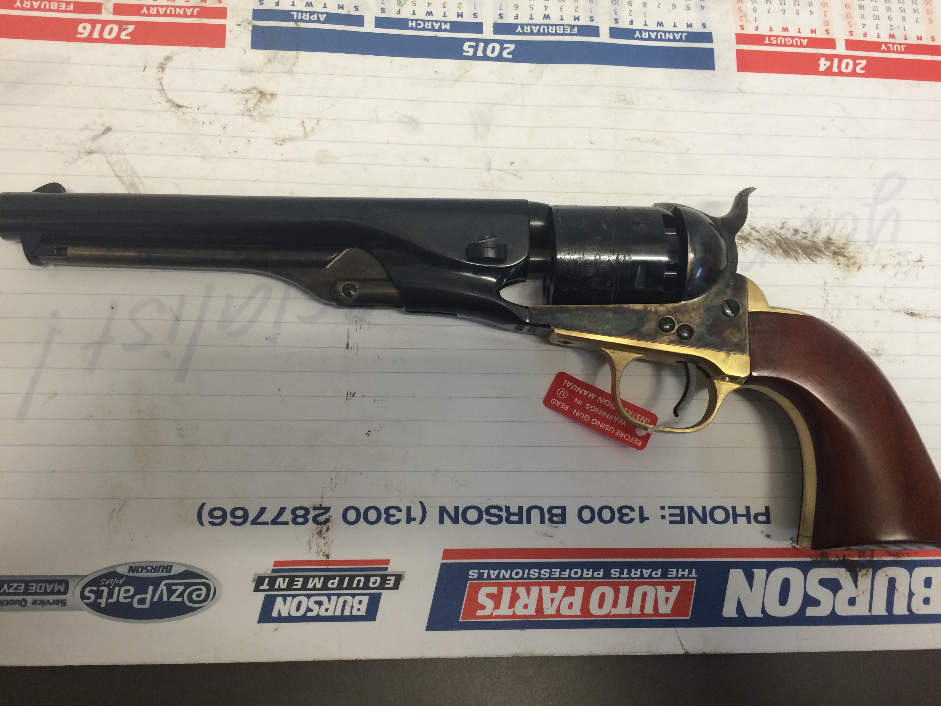

Going to try it through my 1861 Navy this weekend.
Regs,
Tank.
Uberti 1861 Colt Navy Civil, .36 cal.
Tank
