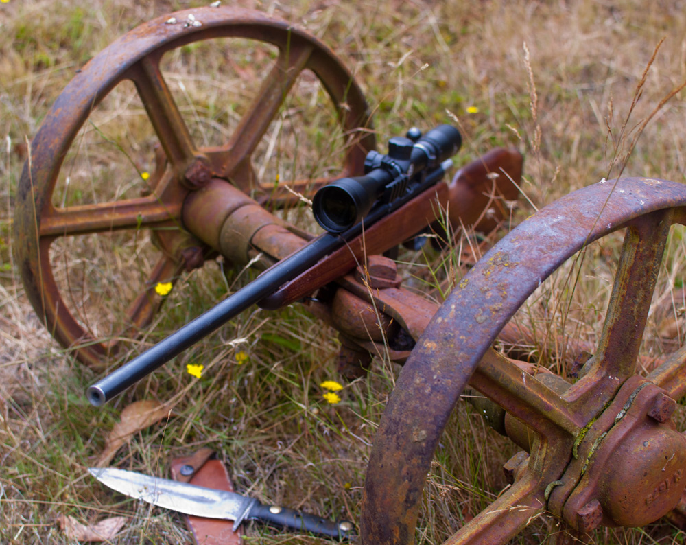

- Sporti with scope mounted...
- Sportco 62A 22LR 01.jpg (372.16 KiB) Viewed 10592 times

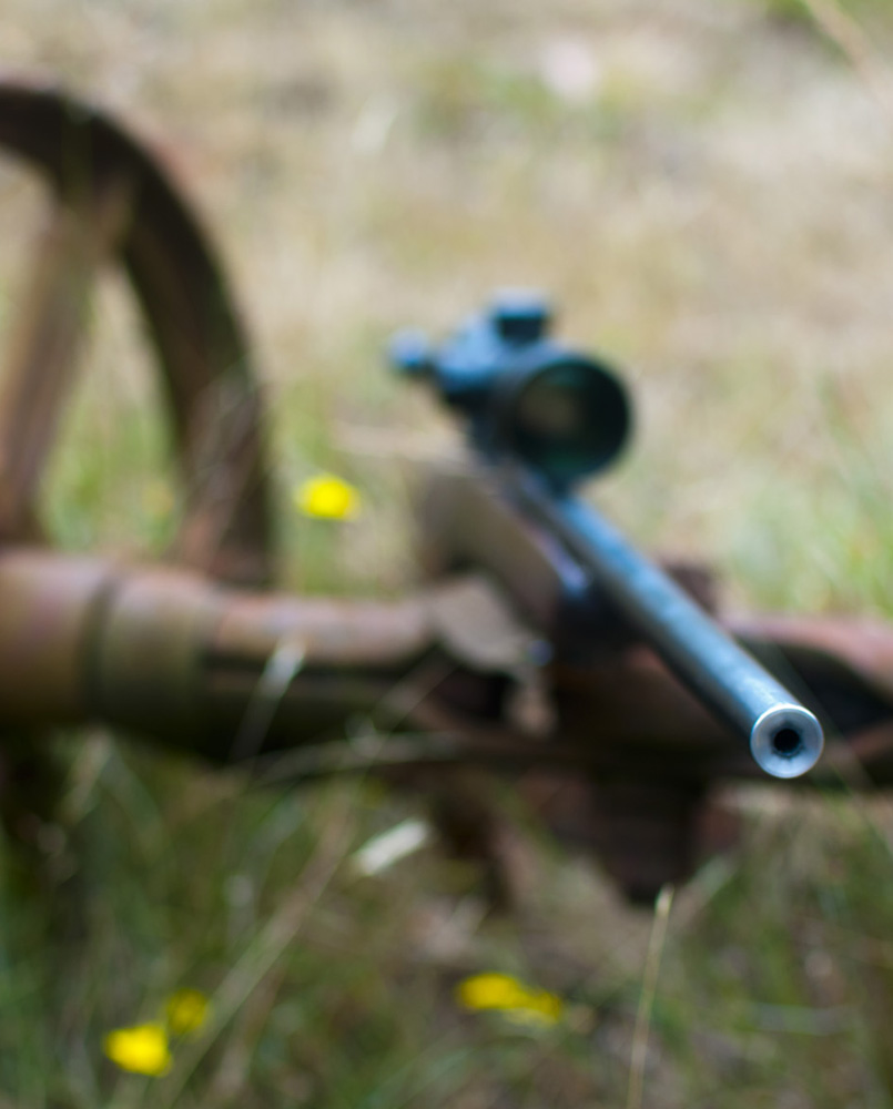

- Rolf Hey crown job...
- Sportco 62A 22LR 04.jpg (135.83 KiB) Viewed 10592 times

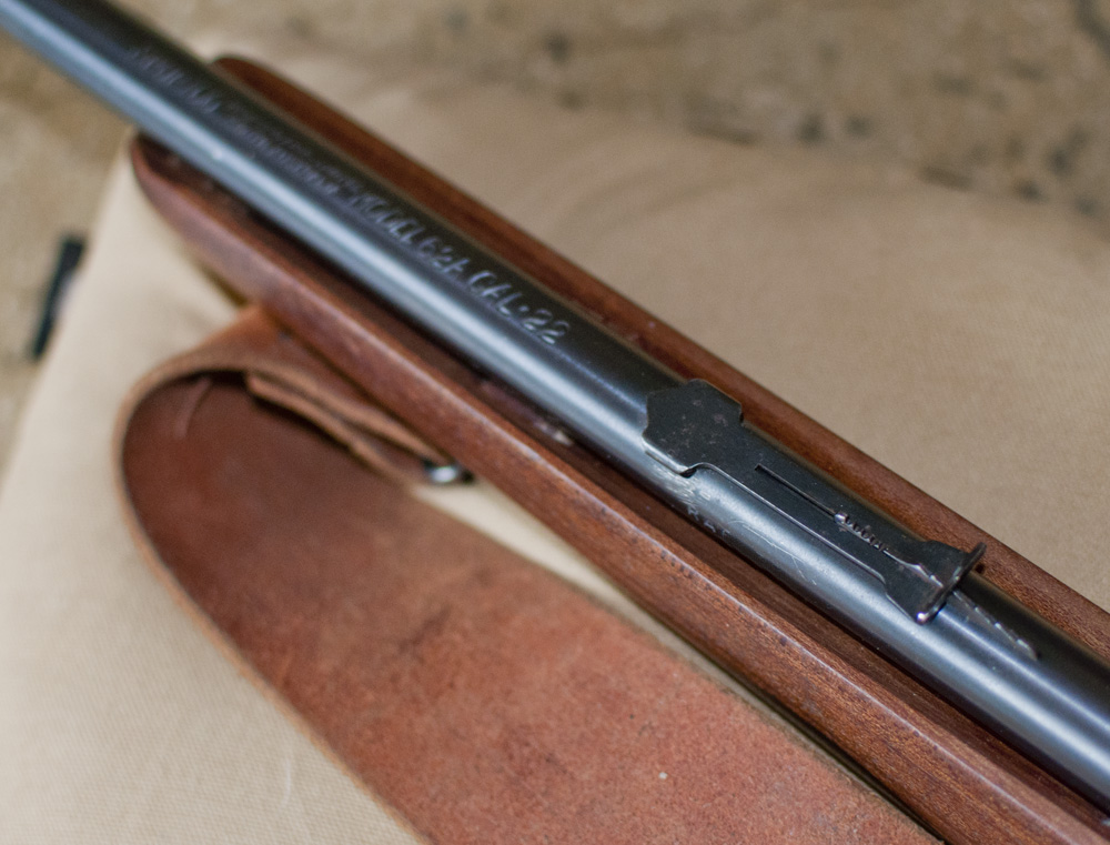

One QUESTION for you all. I am only familiar with open sights that have rear windage and elevation adjustment. This old leaf system has me a bit perplexed. I see how the elevation is adjusted but what do i do to correct windage for the rifle's preferred ammo???

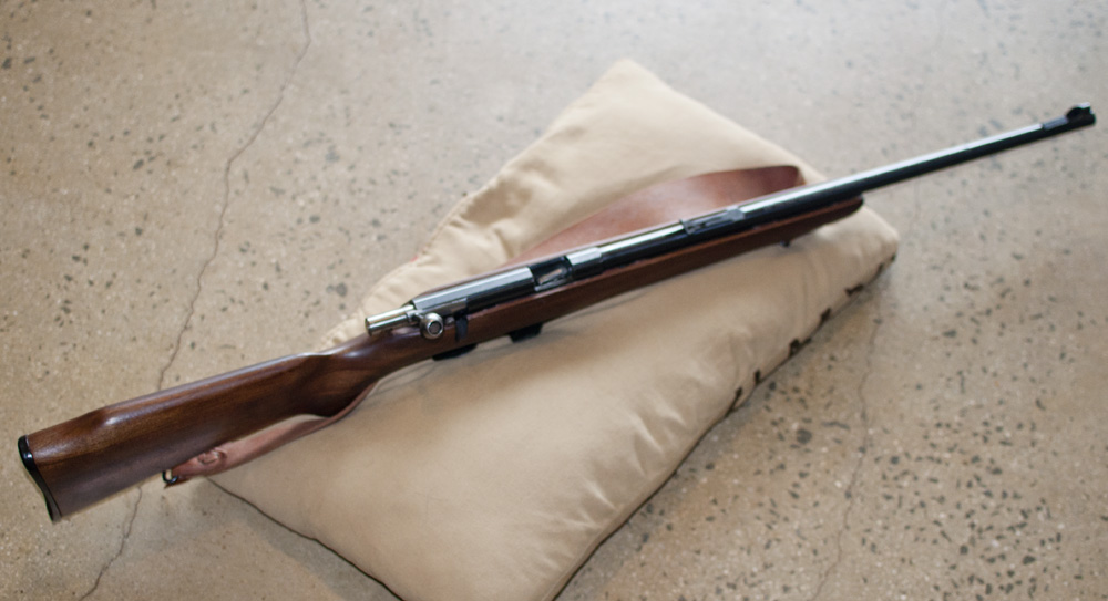

- Iron sights fitted... now it looks somewhat more like it originally would have.
- Sportco 01.jpg (155.76 KiB) Viewed 10592 times

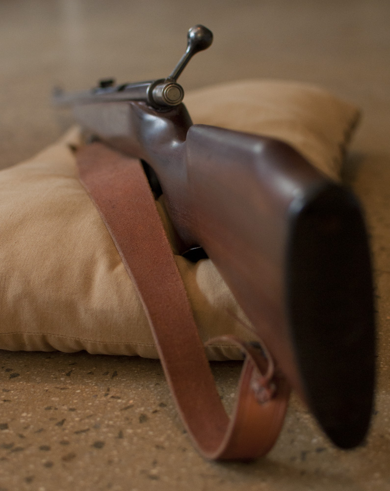

- The old girl... nice and simple.

- Leaf sights... how do i adjust for windage???
- Spotco 04.jpg (233.05 KiB) Viewed 10592 times
